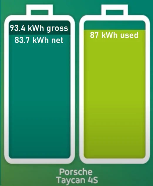

the turbo s battery pack is 93.4 kWh with 83.7kwh - so full charge wont even go to 90%.
I am not sure how this works.
When they say 100% is it charged to 93.4 or 83.7 or some number in between (so there is a buffer on the bottom so the battery never gets to 0%)?
Has anyone tested what a 100% full charge is?
Porsche Taycan DC vs. AC Charging 1594954614512
This was tested in Germany. The car shows SoC as the net capacity of the battery which should be 83.7 kWh. The real number might be higher. Either Porsche already decreased the buffer or the actual gross capacity of the battery is larger than 93.4 kWh.
Anyway, the buffer is managed by Porsche via car software. This should no be of any concern to the customer. I even don't know why they even put the gross number in the specification.
