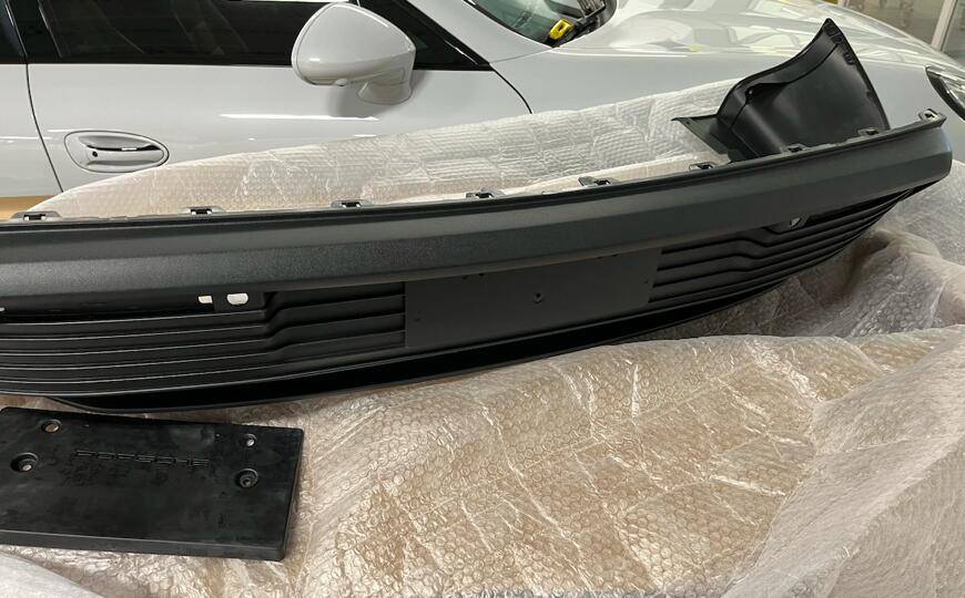

Parts are in, but I have not seen as I had SunCoast ship them directly to my dealer. The shipment was almost on time. As I mentioned I want to be present during install (not only to take pics but also because I don't want to get stuck in a macan). Now that the kids are out of school for summer break and I have been relieved of my uber driving responsibilities, I have time to chill at the dealer and am shooting for an install later this week. I am super anxious to get this done as I just put my summer wheels back on last weekend, so now all that is missing from automotive perfection is the euro rear-end! Stay tuned.

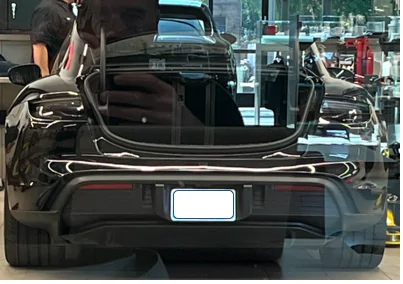

Nothing is easy in Czechoslovakia; and nothing is easy with the Porsche Taycan. Pic at top is my car in the operating room waiting on the "plastic surgeons" to perform simple cosmetic surgery, i.e. replace the plastic baboon's ass bumper cover with the original design OEM bumper cover from SunCoast. I was quite happy this morning when we unboxed the new cover. It looks exactly how I pictured it would look. SunCoast also sent the Porsche license plate mount -- which appears to be unnecessary and unwanted -- all it does is slightly change the angle of the license plate (probably to make it easier for traffic cameras to read). After about sixty minutes and lots of conversations in the OR, the surgeon emerged to advise that they could not perform the operation today. Apparently, this is not the 2 hour nip & tuck they had initially anticipated. It will instead require the complete removal of all the crap that the bumper cover is attached to (body parts between the cover and the tail lights) and then a recalibration of the radar and any other electronic stuff that has to be removed/disconnected in the process. They told me that they would need to have my car for at least a day, maybe two, to complete the work. And so, I will now attempt to reschedule a few weeks from now when they will have a multi-day Macan loaner available. This was indeed a depressing development, but now that I have seen the original Taycan bumper cover in all its glory, I am even more determined to complete this important mission!

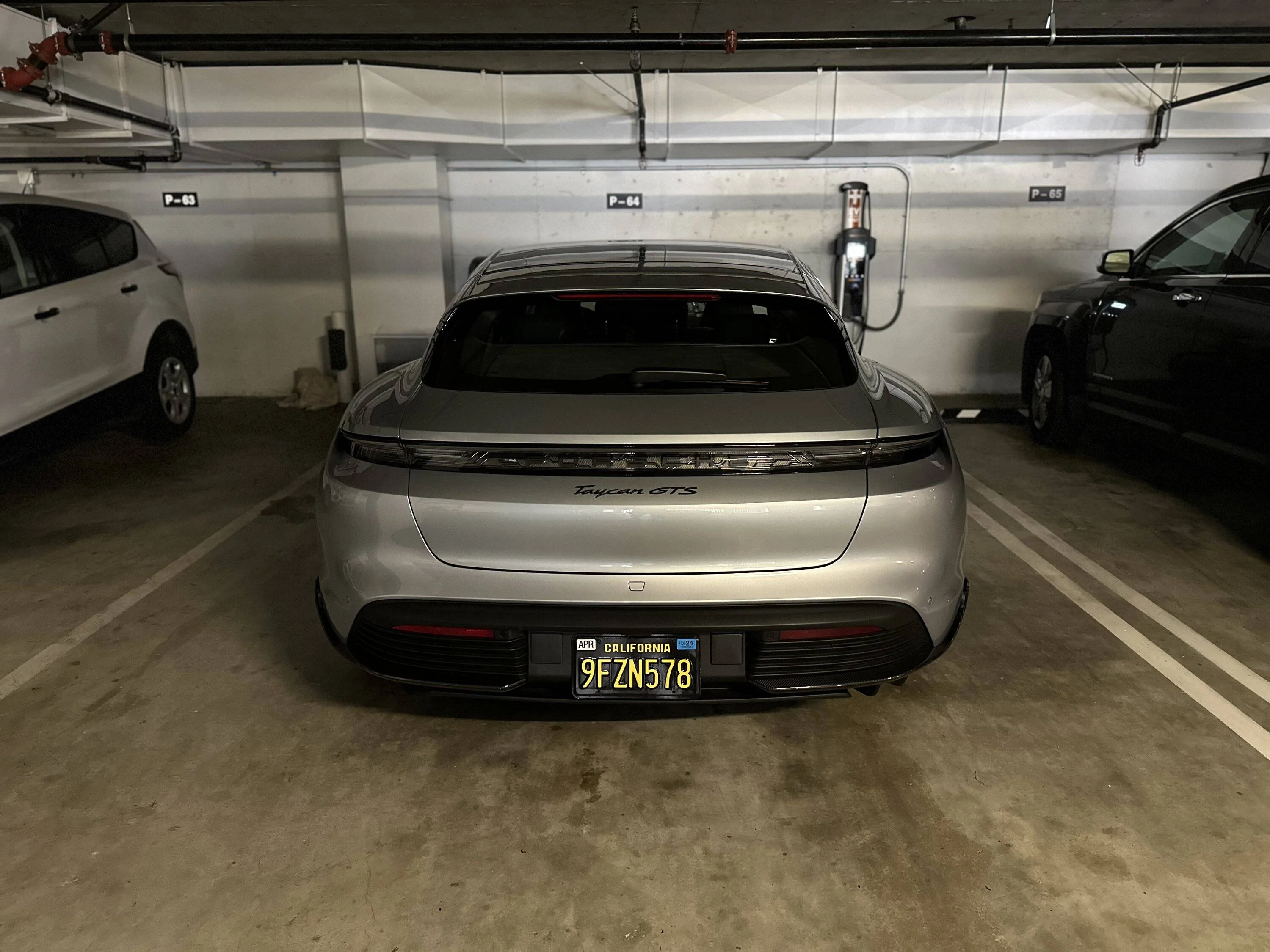

Question for those who did this mod, the black fascia piece, is it possible to remove just this black bumper part without removing the painted rear bumper that it's attached to?

I might be wrong as it has been a minute since porsche swapped out my American rear end for a Euro rear end, but I think they had to take off the dull plastic as well as the painted bumper cover above it. This does not mean that you could not replace just the dull plastic, but my guess is that you are better off taking everything off, connecting all the parts and then snapping the whole thing back into place.
