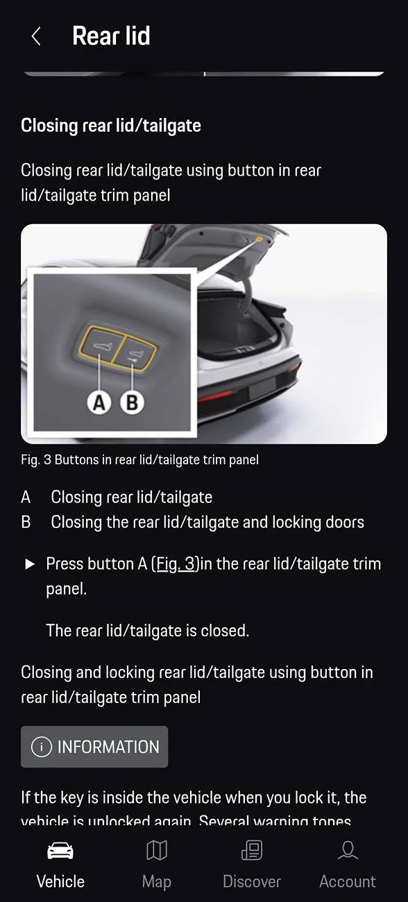

Do you have two buttons in your rear hatch or boot (one for closing)?

Cars with factory Comfort Access have both buttons: close and close/lock; cars without Comfort Access only have one: close. If you only have one button on the trunk lid there won't be any Comfort Access options in the PCM.

Hi there, thanks for guidance, I definitely had Comfort Access working a few days ago and I only have one button in the boot lid ? It has suddenly stopped working though and I don't seem to have PCM option. I'll take to the dealer to sort.
