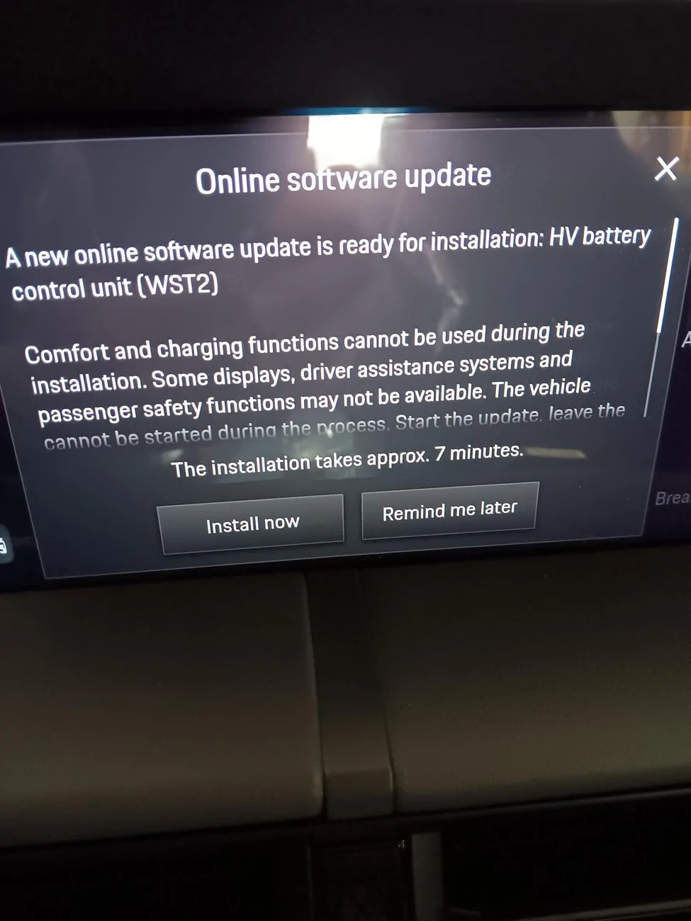

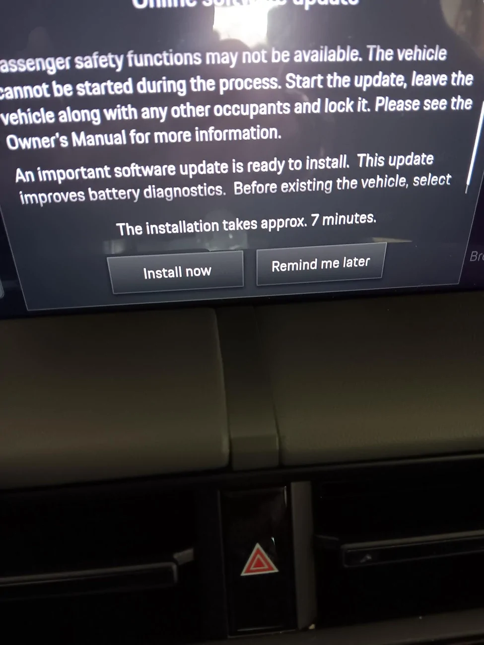

"HV battery control unit (WST2)" "This update improves battery diagnostics."
PCM reported the update was successful.
Porsche Taycan WST2 OTA update 20260320_163310
Porsche Taycan WST2 OTA update 20260320_163349
Nothing at NHTSA site about WST2.

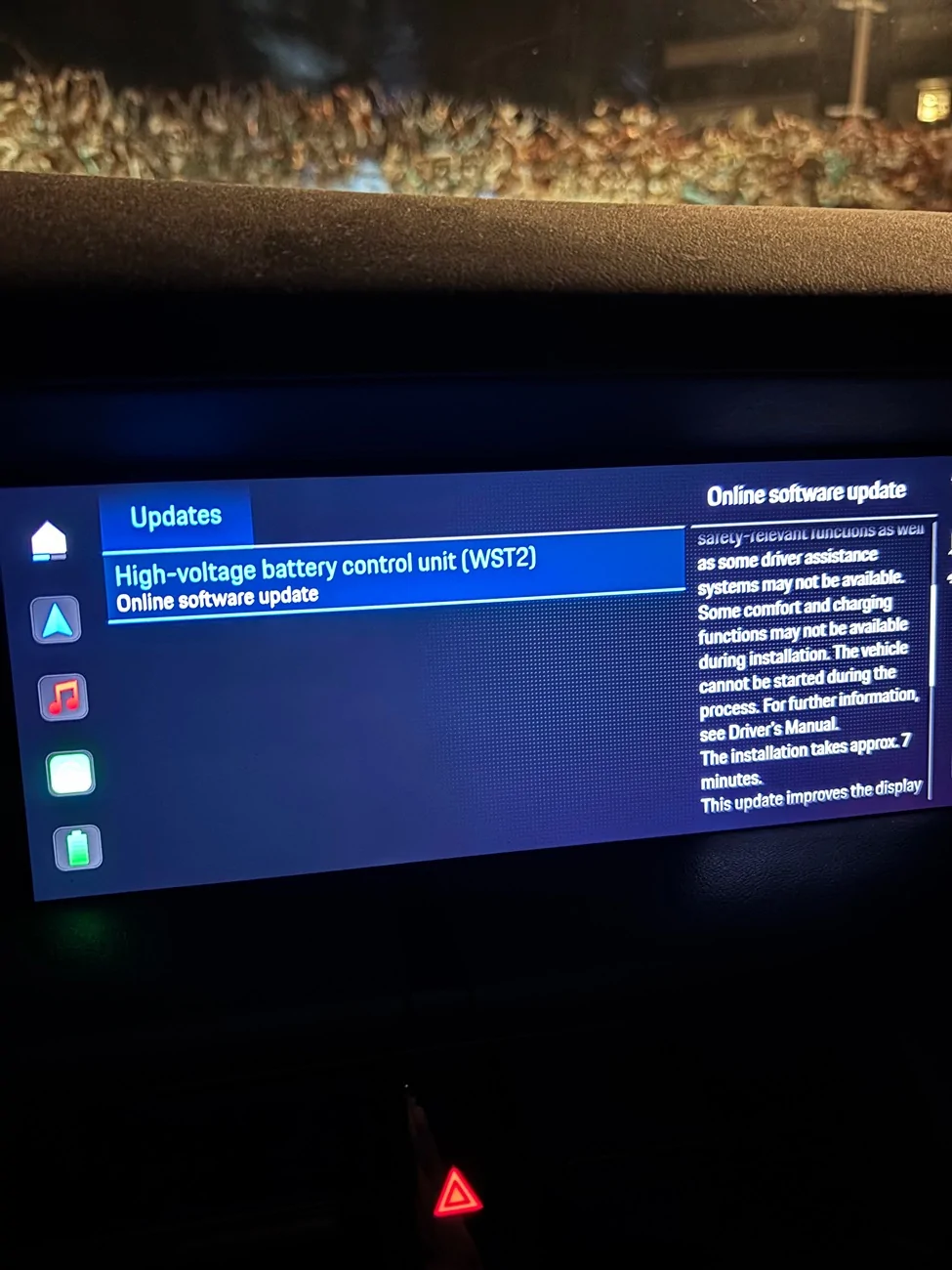

"HV battery control unit (WST2)" PCM reported the update was successful on March 23, 2026. This upgrade message occurred 4 days after the recall service was done for ASB2 (Reprogramming driver assistance systems) and WSS6 (Reprogramming 12V battery sensor).

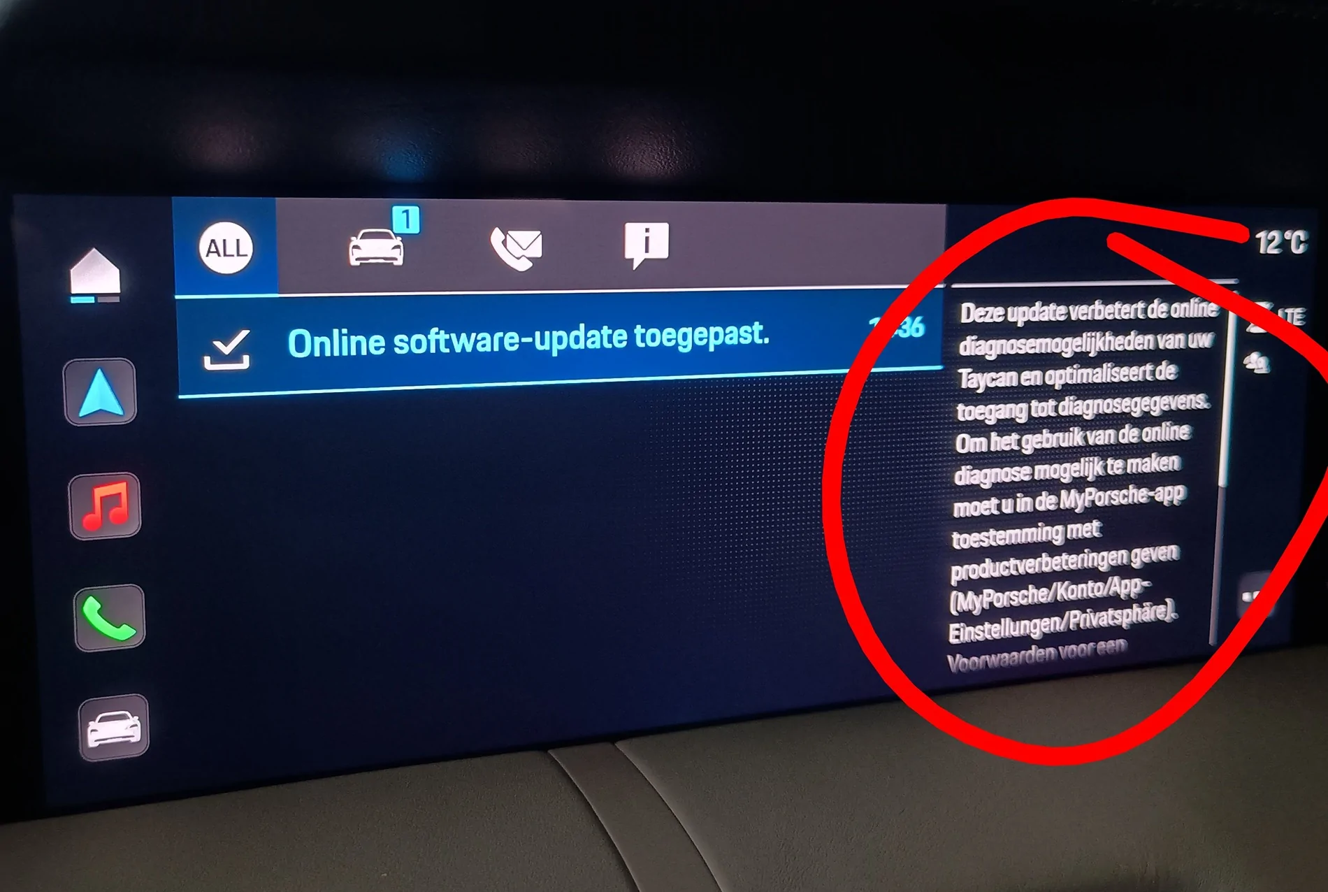

Same here WST2 update appeared in mine the day after I did all of the recalls you mention. There must be a link. But in my case the car failed to complete the update 10 days in a row. I had to take it to service, they forced it manually without success. Finally yesterday they had to do a 12V battery reset, and full reset of PCM for the car to accept the update. Still a mistery what this update does. Dealer had no idea what it is.
