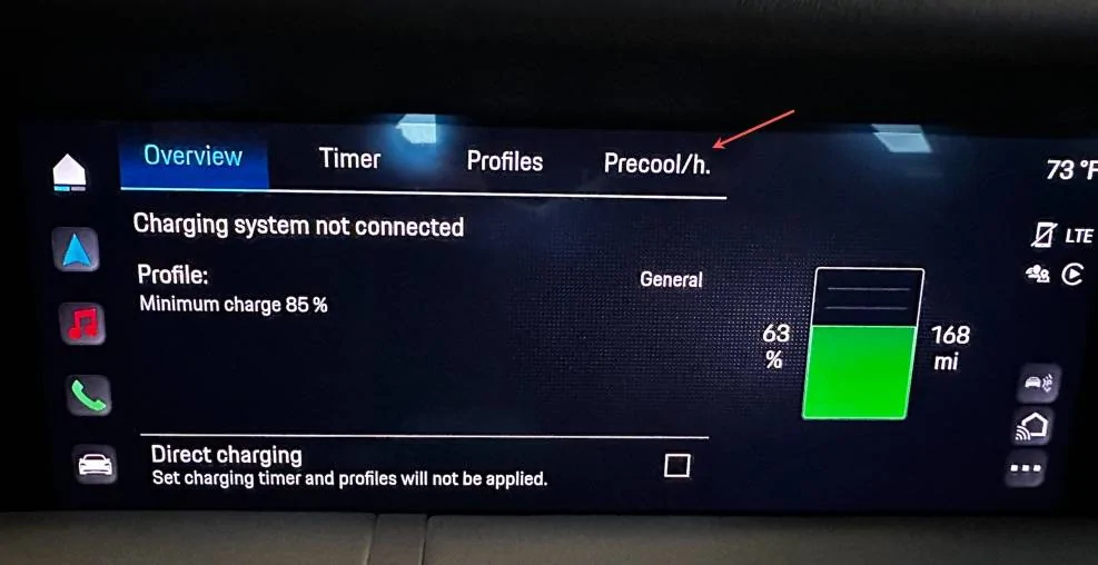

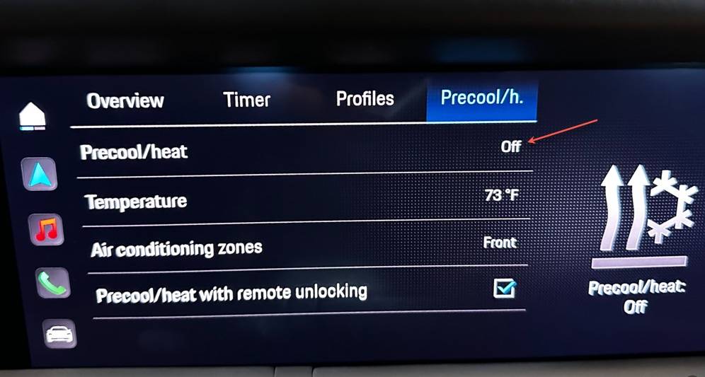

I might have found the reason why I don’t get these major updates. My car keeps preconditioning on for 5m after I exit the car, and according to the video, preconditioning must not be active.
Ah, interesting. Turn that off and let us know what you see.

Where do you turn it off? I don’t recall seeing the setting, it’s behaved like this since I picked it up.
Edit: I also don't see the update in notifications, so not at the update ready yet I guess.

I believe pre-conditioning is pre-cool/h. and can be found either under the battery settings, or under the air conditioning settings. There is an on off setting.
