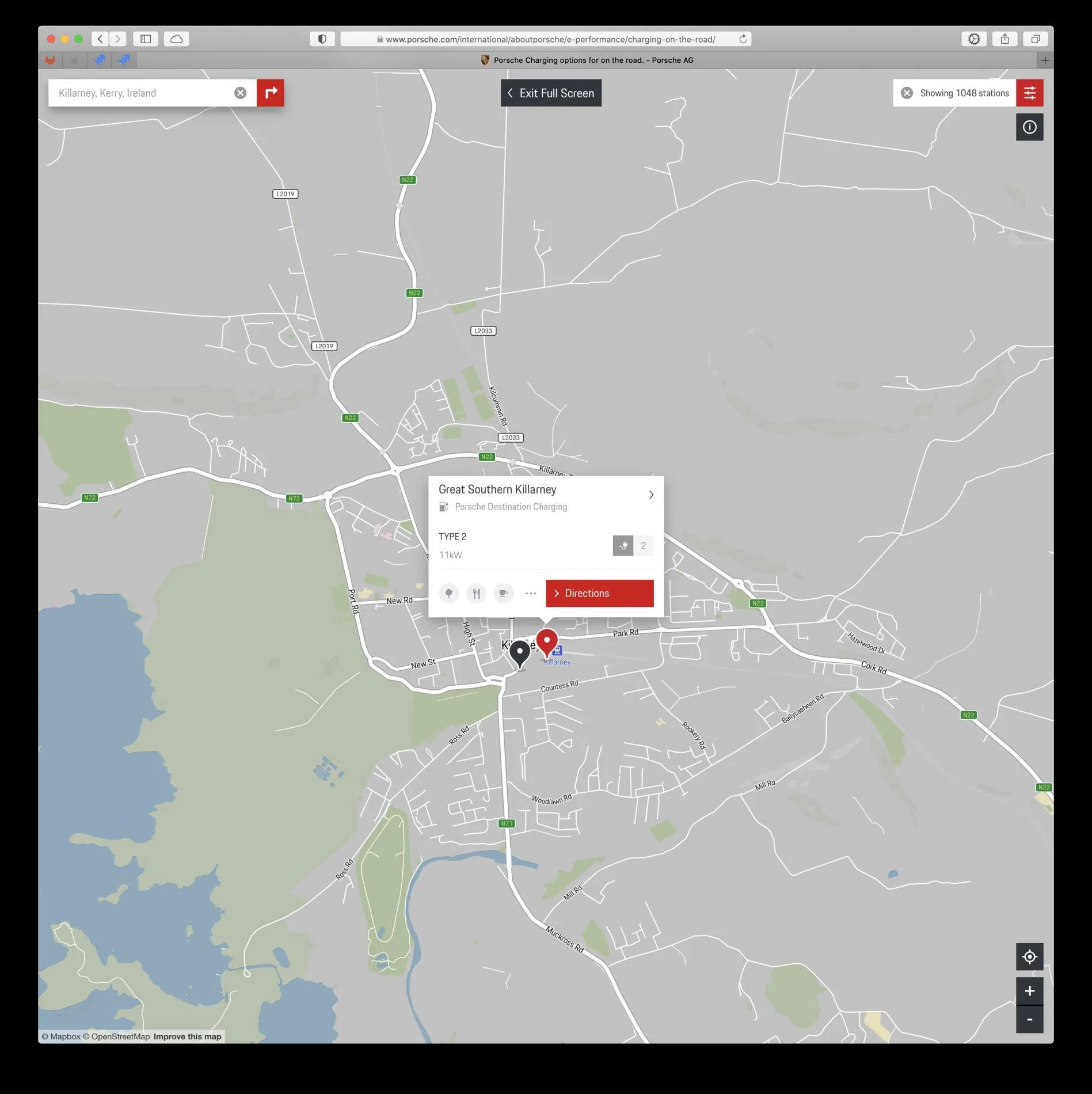

I see you're right - two in Killarney – the town I grew up in! Definitely going to use them on a visit home – after lockdown ended.
Nice!
Do you know what kW charge they provide?
I was in Killarney staying in a cottage by the lake self isolating for 2 weeks after returning from living in Dubai in late March and prior to realising I'd end up owning a Taycan.

Nice!
Seems to be regular 11kWH - both hotels showed the same rate:
