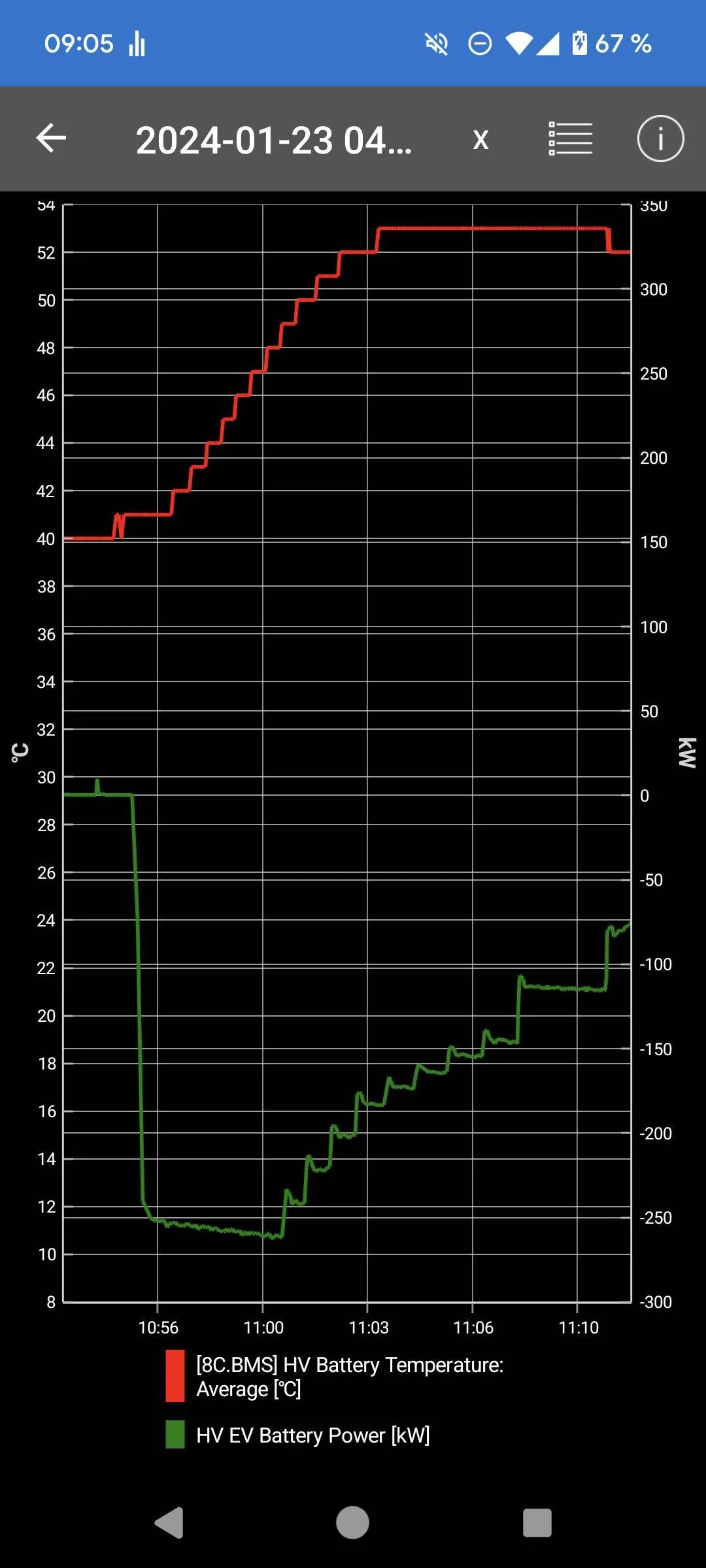

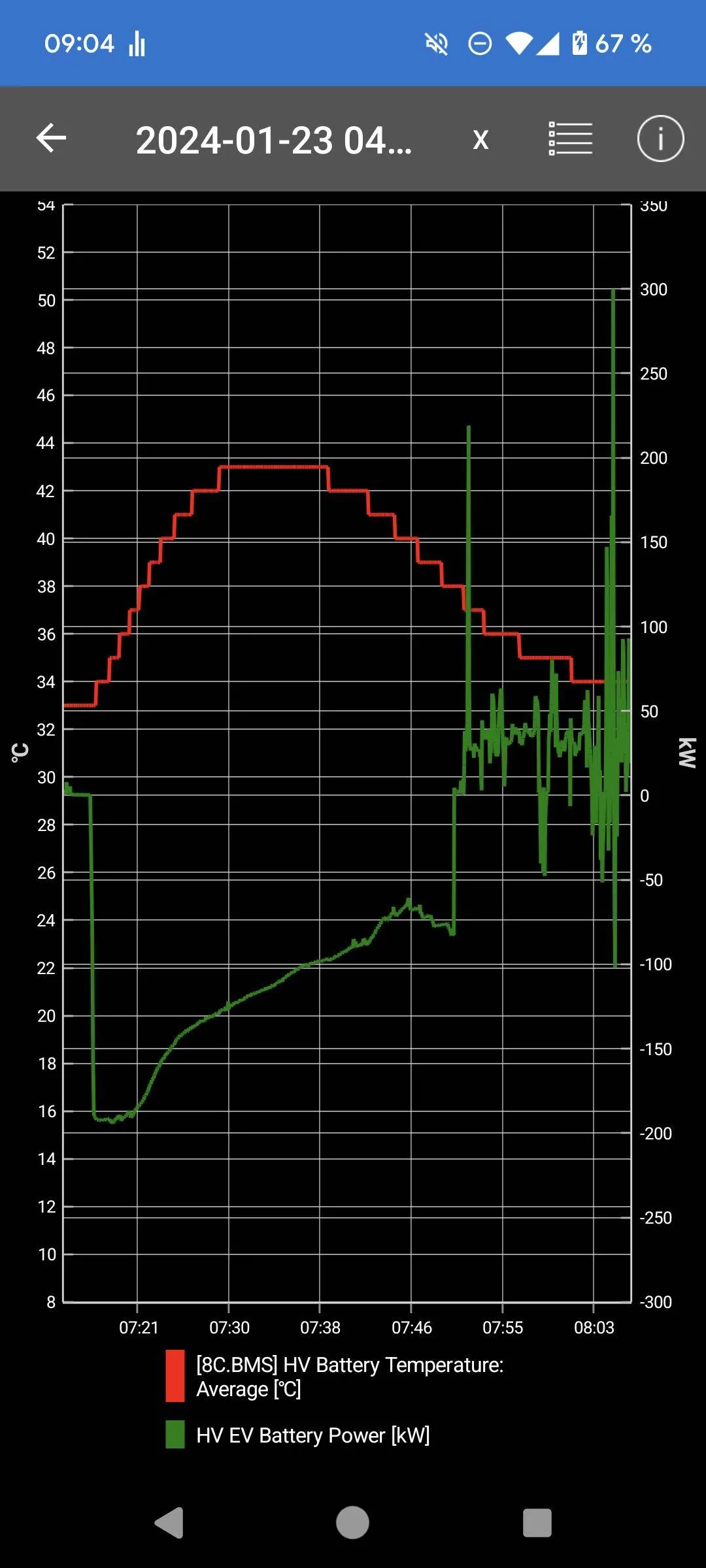

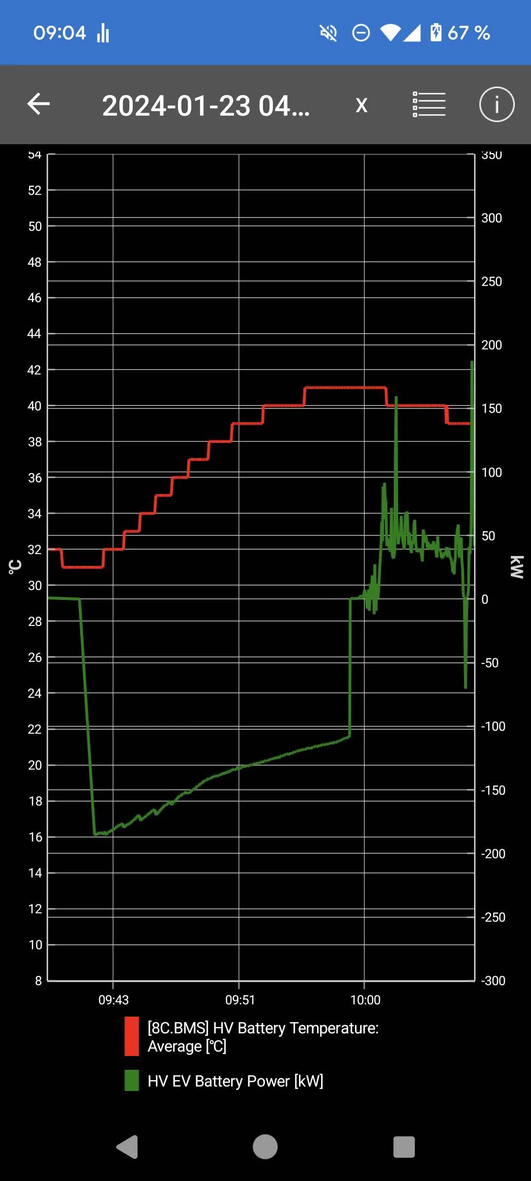

Why doesn’t the battery temp gauge have a mark for optimal battery temp? Internet says 88F/31C - our last roadtrip I remember always being above 88 and charging wasn’t hitting max station speed - I wonder if that was the issue? And why was overheating an issue in the winter below freezing?
did you tick the battery-friendly charging option in the PCM ?
I had it ticked for the first two charging stops (Temp outside was about 6°C): battery was preheated at around 31/33°C, and max. charging speed was about 175kW
Porsche Taycan Dissapointing tacan DC charging Screenshot_20240203-090420
Porsche Taycan Dissapointing tacan DC charging Screenshot_20240203-090439
I removed it for the 3rd stop: battery was then preheated to 40°C/105F, and car was charging above 250kW.
Porsche Taycan Dissapointing tacan DC charging Screenshot_20240203-090501
My car on a long trip >2 hours driving will get to 31C in the battery. If I however navigate to an Ionity Charger 350 kW as a planned stop in the navigator, my battery will reach about 40C. That is when the max charge rates of 265 kW have been reached for me. ( SoC about 10%). I always stop with the car in Sports Plus and start charging. The fans kick in early and I have never had any overheating of the battery. The car charges very quickly up to 80 -85% that way. Battery temperature can be up to 50 C when leaving the station.

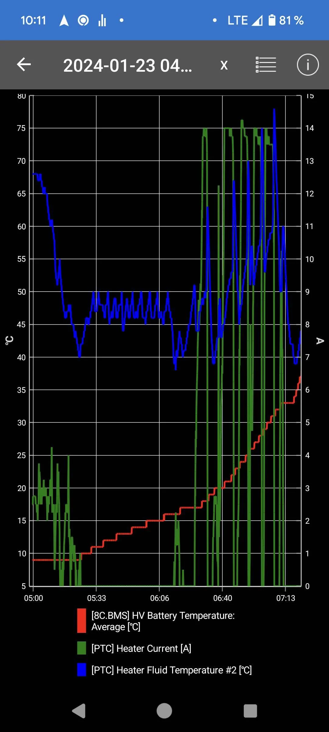

those were interesting graphs. How did you produce them? Presumably you have a device connected to the OBD port?
i’d be interested to see a graph like this which shows a cold battery in an average ambient temoerature. What I don’t understand, is how quickly the battery heats itself up. If it is not preheated what is the real penalty of using a cold battery? We fuss a lot in this forum about preheating, but if it only adds a few minutes until the battery warms itself up during charging, then who cares? Or does it stay cold/slow for a long time?
Gru
Aug 21, 2022
413
549
Taycan Sport Turismo - 20"
I use Car Scanner with an OBDII dongle.

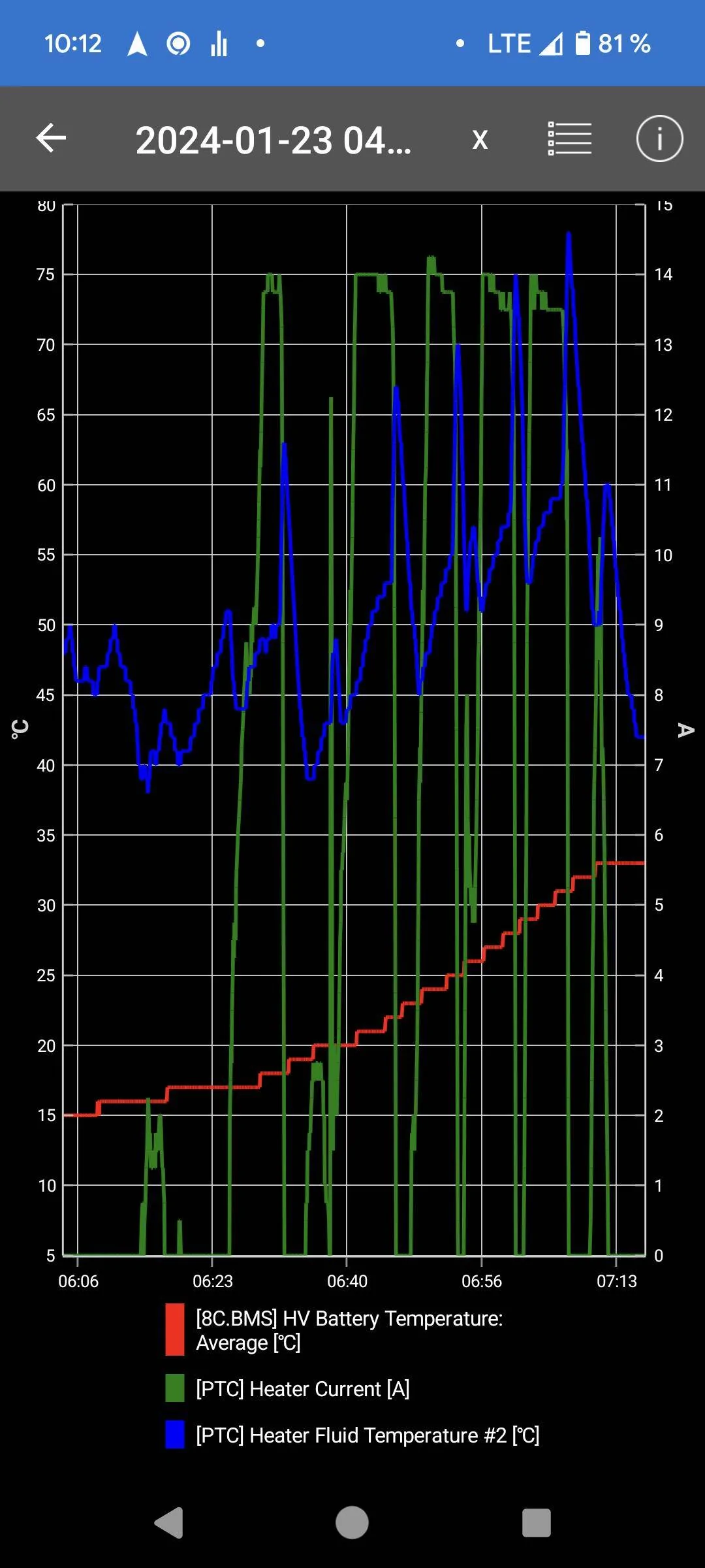

I’ll try to reply (partially) to your questions: i had them for a long time also.
I monitored below the avearge battery temperature, heater fluid (for the battery) temperature, and the heater current (right graph is a zoom of the left one, when preheating is active)
- when heater current is below 3A, it’s used only to heat the cabin. Heating the battery happens only when above 3A
- car was cold, at outside temp (8°) when leaving
- from 5:00 to 6:20, battery slowly warms up from 8° to 16°. Heater is not active.
- at 6:20, about 50mn before planned charging stop, heater starts, reaching 14A. It’s not constant: it goes on and off (don’t ask me why…). Slope of the battery temp is stepper, and battery reaches 33°C, enough to charge at 175kW.
Porsche Taycan Dissapointing tacan DC charging Screenshot_20240203-101130
Porsche Taycan Dissapointing tacan DC charging Screenshot_20240203-101219
I can’t reply on how much time i would have loose (charging) if i hadn’t planned the charging stop in Nav. I’ll test that later this week: i have to do the same trip, and i‘m curious ?…

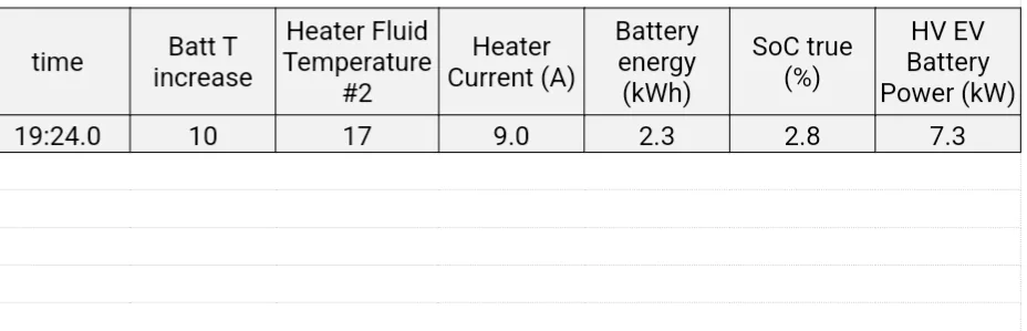

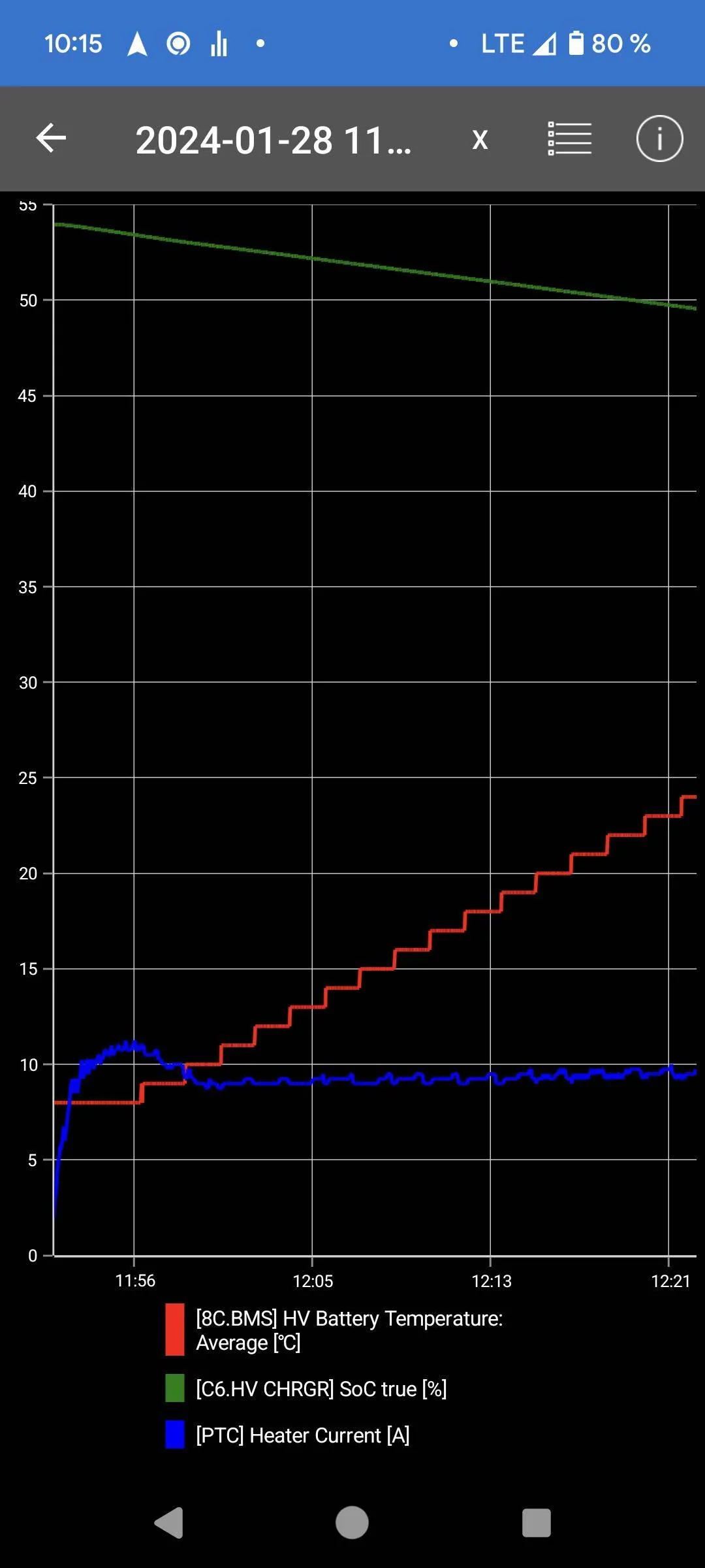

Now, how much energy is « wasted » when preheating. I ran another test:
- car was not moving. i specified a DC charger in the Nav, about 10km away (so very close, or very late).
- and i waited inside the car to see how long it takes to heat the battery
Well… it takes a lot of time to increase the batt temp by 10°: about 20mn. For sure it’s the worst scenario since there is no heat generated by the engine / transmission, etc… that could be used to warm the battery.
And it requires a lot of electrons…: it needs 2.8% SoC to increase by 10° the battery temperature, requiring an average of 7.3 kW from the battery.
I’ll soon see what charging speed I’ll reach without preheating and how much extra time needed.
Porsche Taycan Dissapointing tacan DC charging Screenshot_20240203-101711
Porsche Taycan Dissapointing tacan DC charging Screenshot_20240203-101507
