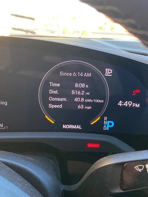

Porsche Taycan EA charging FAIL FAIL FAIL IMG_0626
Drive from Denver to Socorro, NM with just the roof rack on the car.

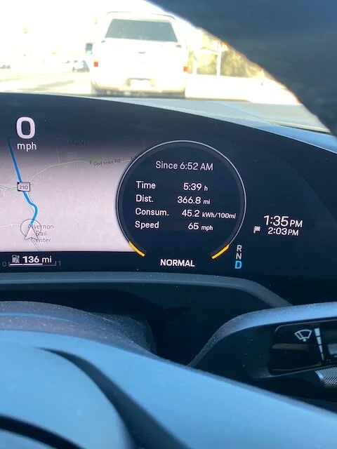

Porsche Taycan EA charging FAIL FAIL FAIL IMG_0636
Drive from Socorro, NM to Tucson, AZ. Pretty obvious efficiency hit with the bike on top of the car.

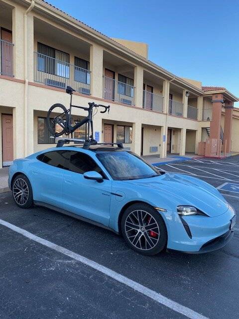

Porsche Taycan EA charging FAIL FAIL FAIL IMG_0631
Car with the bike on top of it. Was getting ready to leave to the hotel to Tucson. The Best Western hotel in Socorro, NM is the only charging option between Albuquerque and the Deming, NM EA charger. that is a 235 mile distance between them and not possible with a roof rack in cooler temps.

I am going to remove the bike and the roof rack for the drive back to Denver. This will give us a better comparison on the actual efficiency hit. I will post a separate thread and provide full details.
