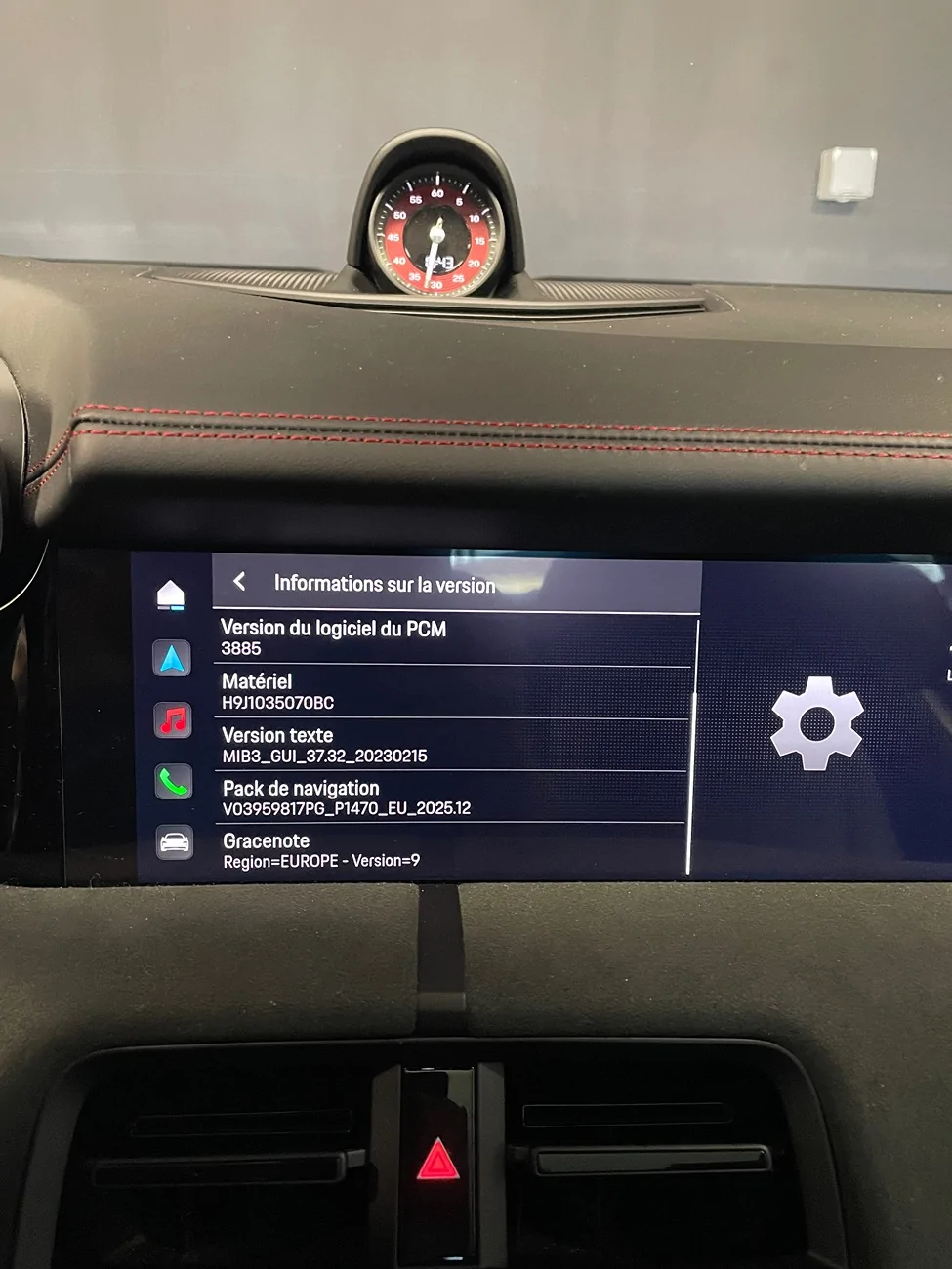

I took back my car this afternon from my CPO service. They changed my Power Buton and mode the TI 63/23 softwares updates.
I have done 50 kms and no navigation issues. They just told me that They did what Porsche Germany told them for those issues.
(Navigation with charger planning selected)
As They also erase defaults and rebooted every systems I will go on testing.
perhaps it’s now ok and Hope so
I will look at my PCM tomorrow to see softwares and map ID now available in my GTS
Graluy
Graluy
Aug 5, 2023
57
Bordeaux
Taycan GTS
New tests today with no issues.
what has been done By my CPO :
- IT 65/23 updates
- PCM upgrade from 3882 to 3885
- Navigation kit to 12/2025
- Else ? They just told me they have followed what Porsche Germany asked them.
I Hope this is definitively fixed
