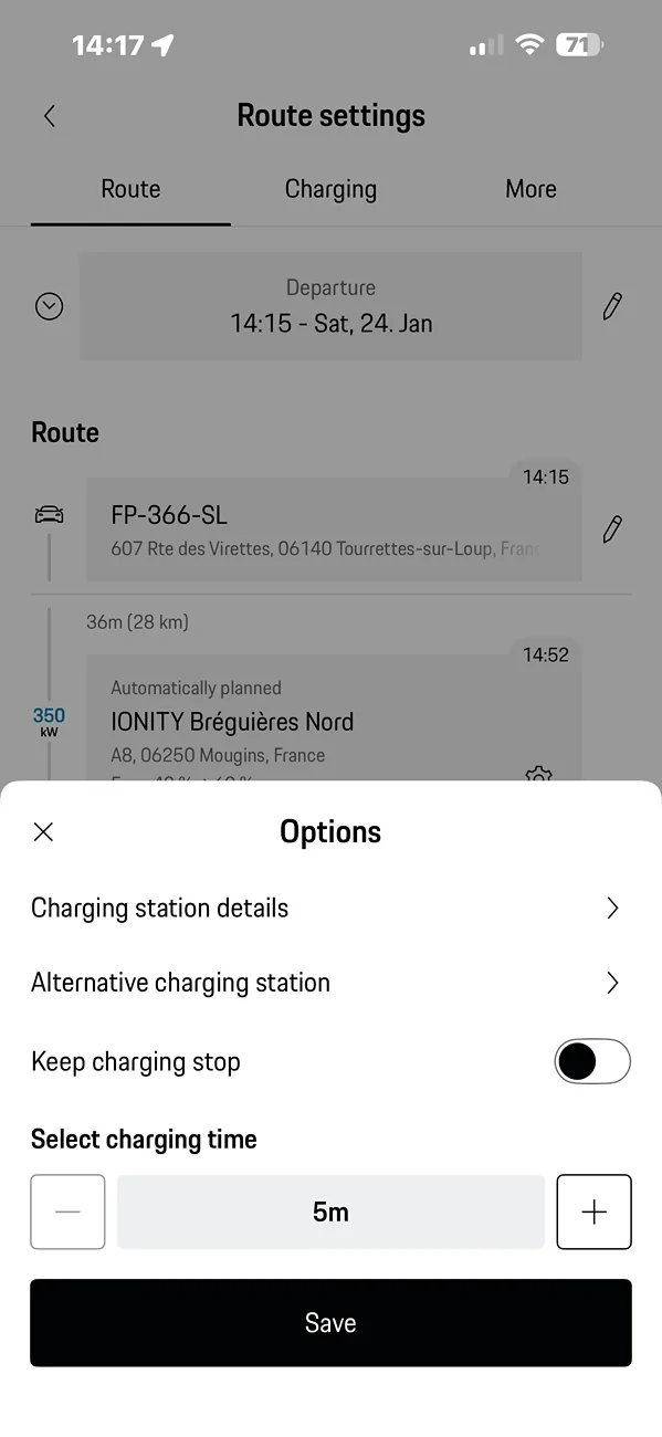

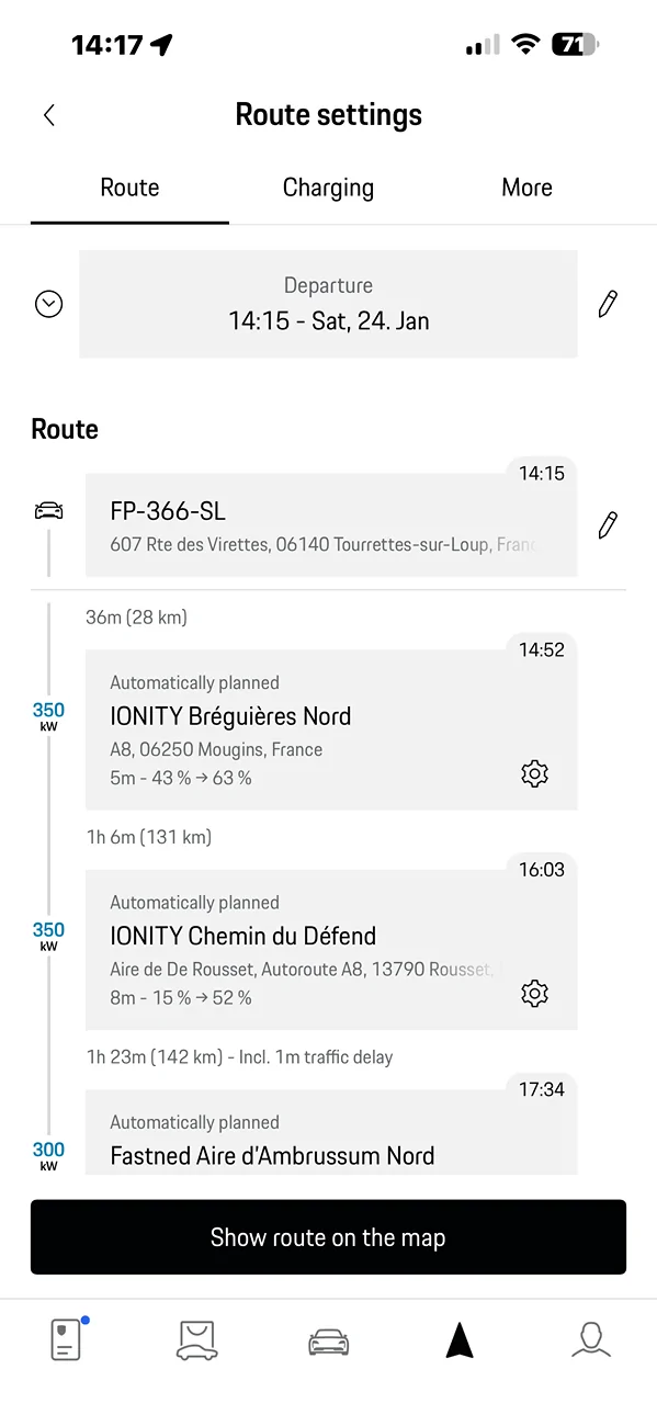

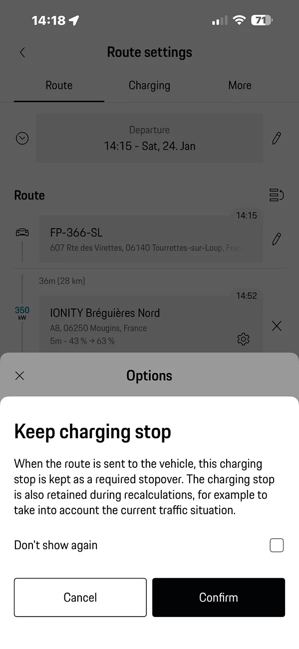

You mean in the app. Does that do anything useful? I have planned my route sometimes in the app, followed by Send (to car). But while the car acknowledged receipt of my destination, it always redid the route planning from scratch. Have you witnessed it respecting your app favourites?
Normally the app’s destination will be the only thing that is transmitted to the car.
However if you plan the route in the app you have the possibility to
1. Decide the charging networks you want in the app, say Ionity.
2. You can then lock in each one of these charging stops, and they should stay, according to the app
see pictures below
Porsche Taycan EU/UK: Ongoing navigation issues [Solved with PCM v3892] IMG_3373
Porsche Taycan EU/UK: Ongoing navigation issues [Solved with PCM v3892] IMG_3374
Porsche Taycan EU/UK: Ongoing navigation issues [Solved with PCM v3892] IMG_3375
This worked fine for me in the summer, but requires you to check every stop to make sure you agree with them.
The best part of it is that you avoid all the crazy stations that the planner will direct you to.
The down side is that you might have higher or lower consumption due to weather or traffic or speed travelled, but you have the desired charging network.
Try it
Ahhhh! Thanks!! I cannot find the filter for 1. But I found your Option panel by clicking on the icon next to each stop. To see the magic slider. Will try this out. 👍
EDIT: The warning is probably fair. The hard selection of a charging stop does prejudice the freedom of the nav to select better routes.
