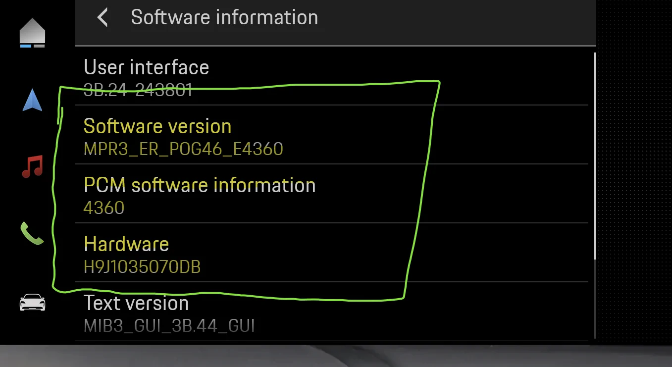

chun
Feb 4, 2024
2,505
2,295
Taycan Turbo 2020, Cayman GT4
I’ll wait until after the formal complaint process to ask. I don’t want to bother them unnecessarily.
You can see in the car settings.
Porsche Taycan EU/UK: Ongoing navigation issues [Solved with PCM v3892] 1770654726802-pu

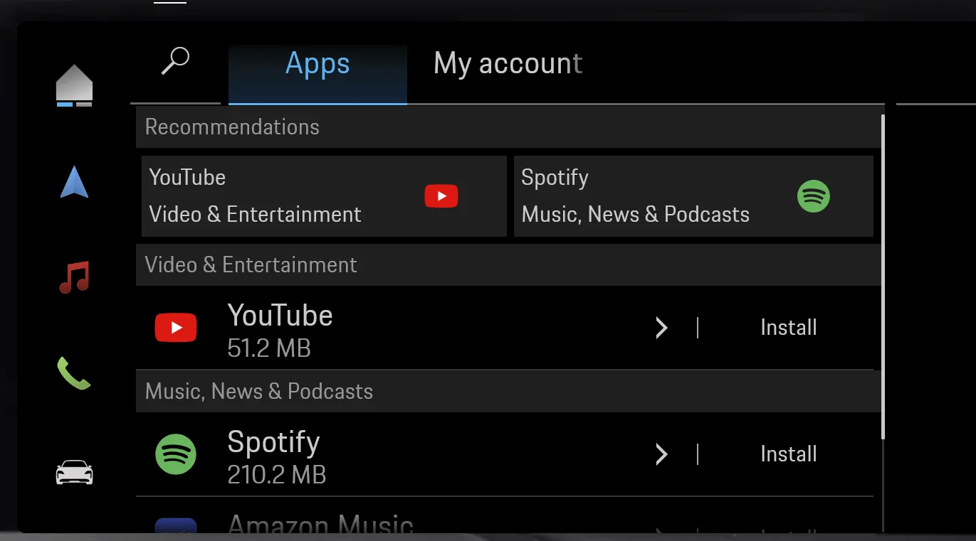

But there are a lot of software combinations that porsche is not handling properly.
4360 is supposed to have the app center, with youtube and everything. Some cars from 2025 have it, some don't.
This is a MY25, with 4360 and app center.
Porsche Taycan EU/UK: Ongoing navigation issues [Solved with PCM v3892] 1770654854803-0t
But I have dirven MY25 with 4360 without app center, but with a video app with youtube in it instead.
There's also 4405, which seems to be just bug fixing for 4360.
There's also 4578 which is what shipped with MY26, but compared to the MY25 running 4360 that I have as a replacement, there are 0 software differences.
And all of these software versions are installed on multiple versions of hardware.
Tully a mess.

Ah totally mis-understood. I was thinking part numbers of the PCM unit itself
3885
Tully a mess.
