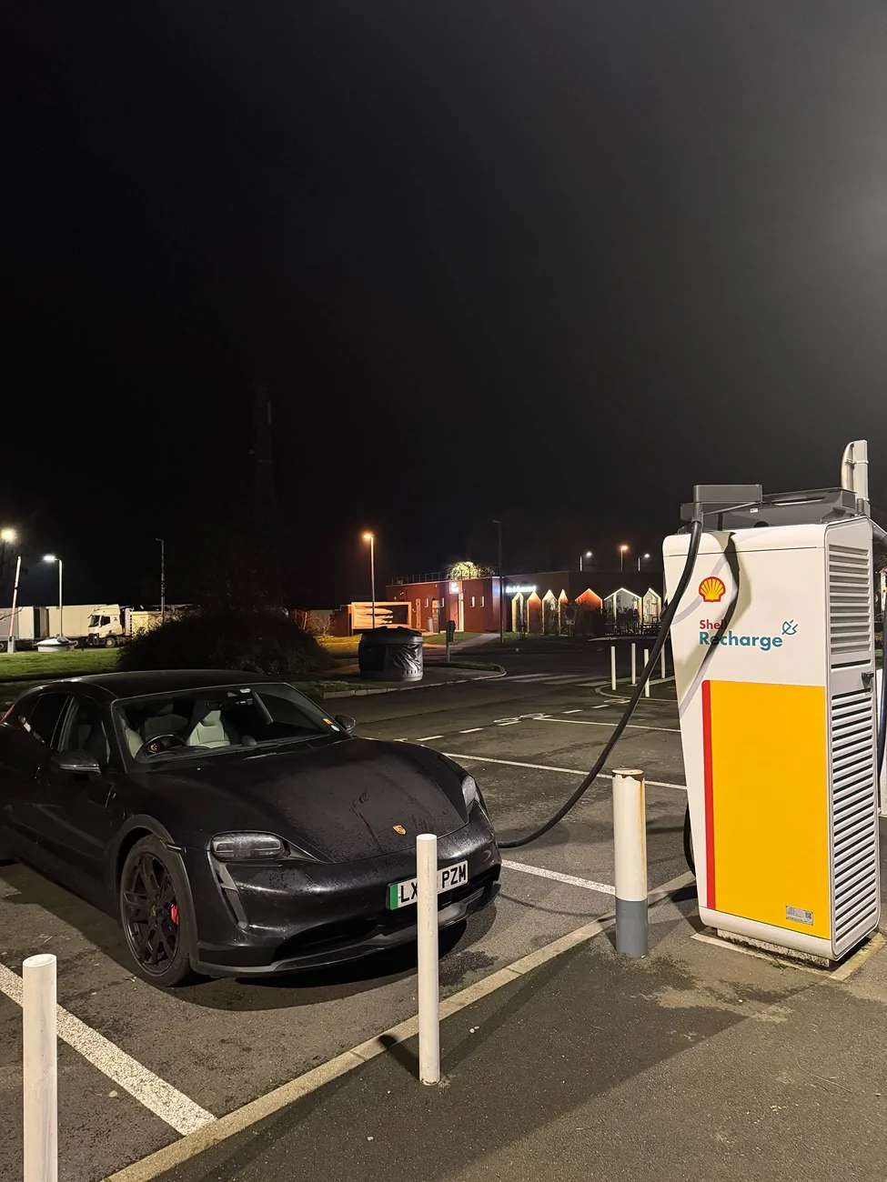

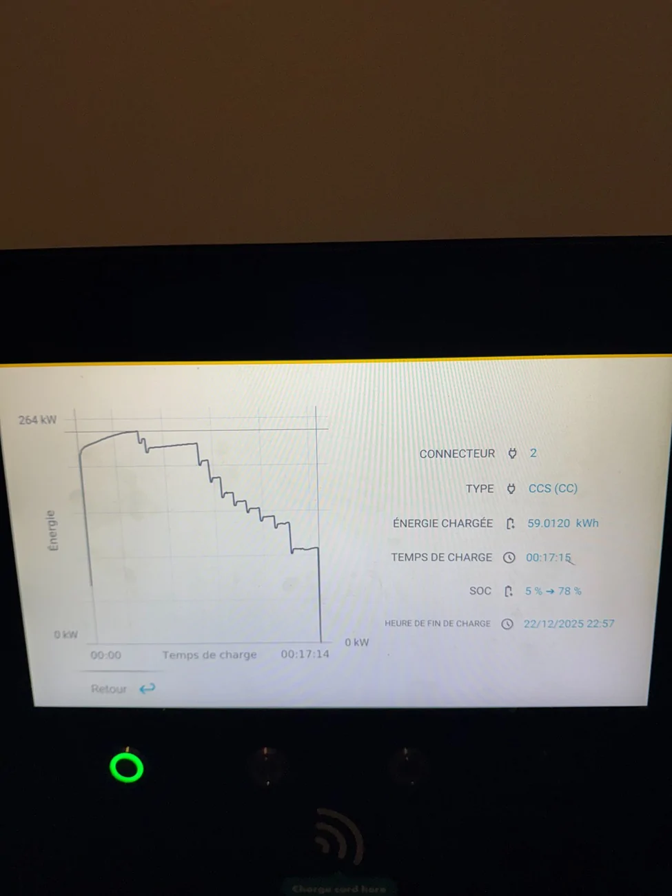

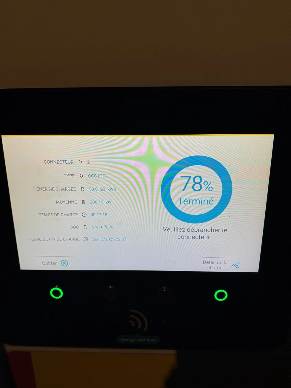

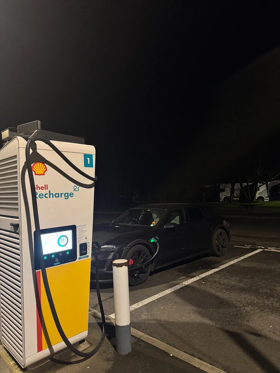

Hello all, during a recent trip back from the French Alps I experienced the best charging session I think I've ever had in my Taycan. This was at one of Aire de Rumaucourt's Shell Recharge 300kW units. Here are the stats:
Porsche Taycan Exceptional charging performance, or just the Taycan norm? IMG_0501
Porsche Taycan Exceptional charging performance, or just the Taycan norm? IMG_0503
The car is a March 2023 registered Taycan 4S Cross Turismo J1.1 with the 83.7 kWh Performance Battery Plus (standard on CTs).
- 5% to 78%
- 59.012 kWh delivered
- 17 min 15s
- Average charge rate of 206.19 kW
- Peak of 264 kW
- 230-260 kW sustained from 5% to 45-50% SOC
Curious to know how this compares to others!

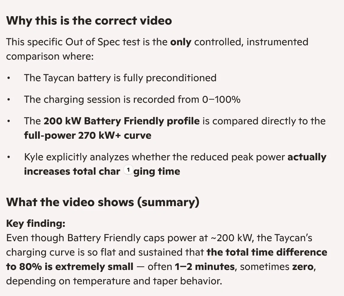

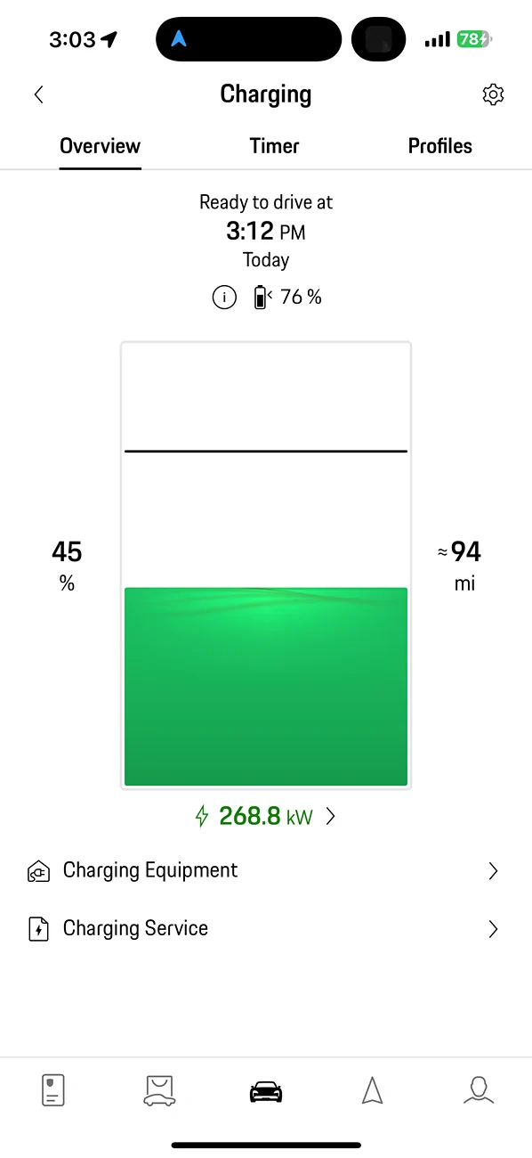

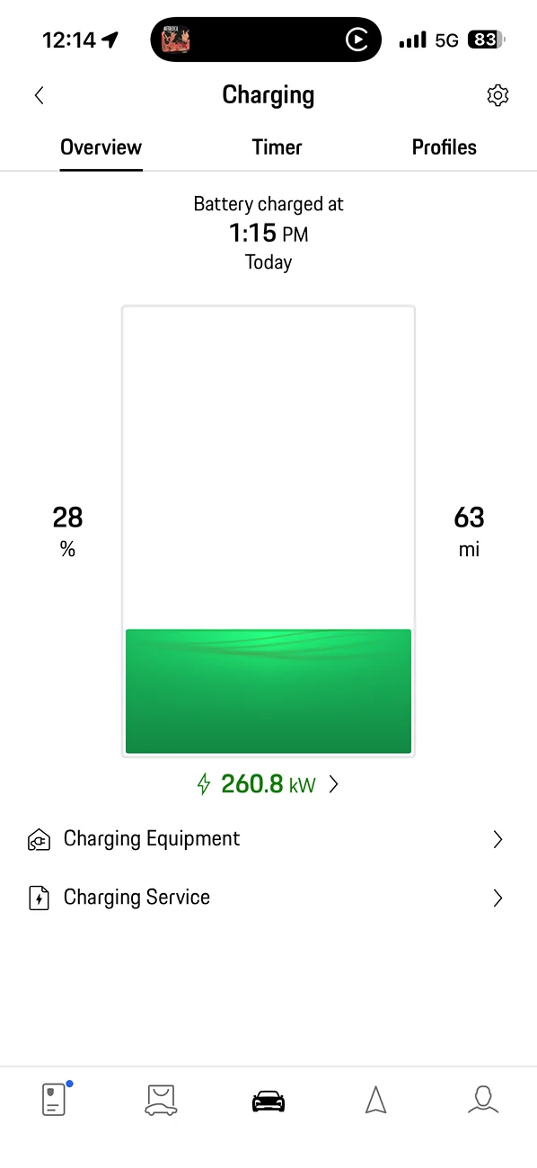

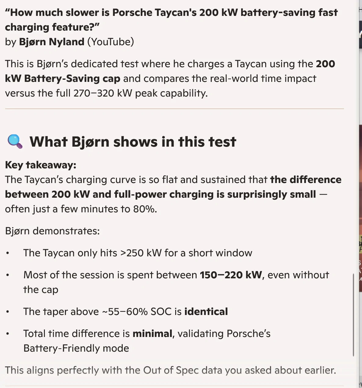

I am trying to say that when using Friendly is just as fast as without (zero gain in time to charge from 10% to 80%, rabbit and a hare, only both get to 80% at the same time), I will find evidence. However, you are putting undue stress on the 3 components known to fail and weak: Battery Cells, Front Fans, and OBC that must work at extreme levels for no gain.
I tried it once and never again. Yes, it went to even as high as 290kw or so as I remember to about 50% then battery temp was exceeding 131F, then fans going at max speed, but charge rate went to really low and by the same 20 min time I was may be at 85%.
Youtuber, that I will find did many tests with high end equipment to show zero benefit.
This is not the video that I am speaking of but still credible evidence as Kyle does good work, I am just not a fan of the long videos that he does. I will find the one that actually uses high end equipment that captures many parameters to come up to the same conclusion, but this below is good enough for me to choose a steady 200kW rates vs 290kW that stresses all the components for zero benefit.
Porsche Taycan Exceptional charging performance, or just the Taycan norm? 1775828640337-k
Found it, check out Bjorn Nyland.
Bottom line, keep Battery Friendly always on for the use case when you are charging from 10% to 80%-85% on the road trip.
