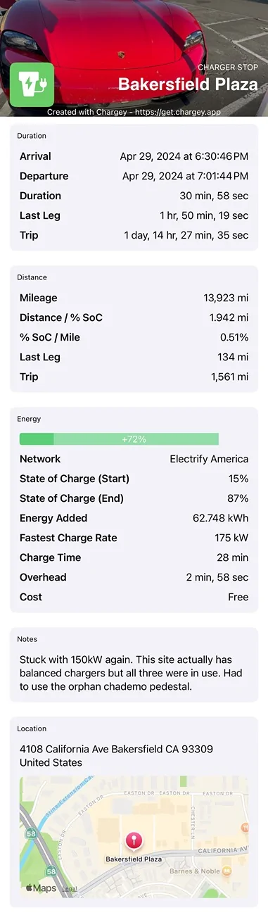

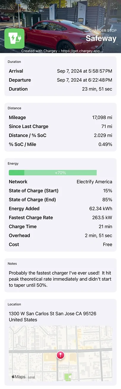

Here are two real world charges.
One near the theoretical max, one at 150kW.
Both were around 20 minutes.
The faster session added 50% more power in the same time.
Faster charging is faster. I get why you’re afraid of it though.

I had ChatGPT do an objective analysis:
You’ve basically got two nearly identical energy adds (~62.5 kWh), so we can compare cleanly.
🔋 Session A (Safeway — the fast one)
  • 62.34 kWh in 21 min
  • Avg rate ≈ 178 kW
🔋 Session B (Bakersfield — slower)
  • 62.75 kWh in 28 min
  • Avg rate ≈ 135 kW
⚡ How much faster?
By time:
  • 28 min → 21 min
  • ~25% faster (you saved ~7 minutes)
By average charging speed:
  • 178 kW vs 135 kW
  • ~32% higher power
In conclusion, I'm calling "MYTH: BUSTED" on "faster charging doesn't save time."

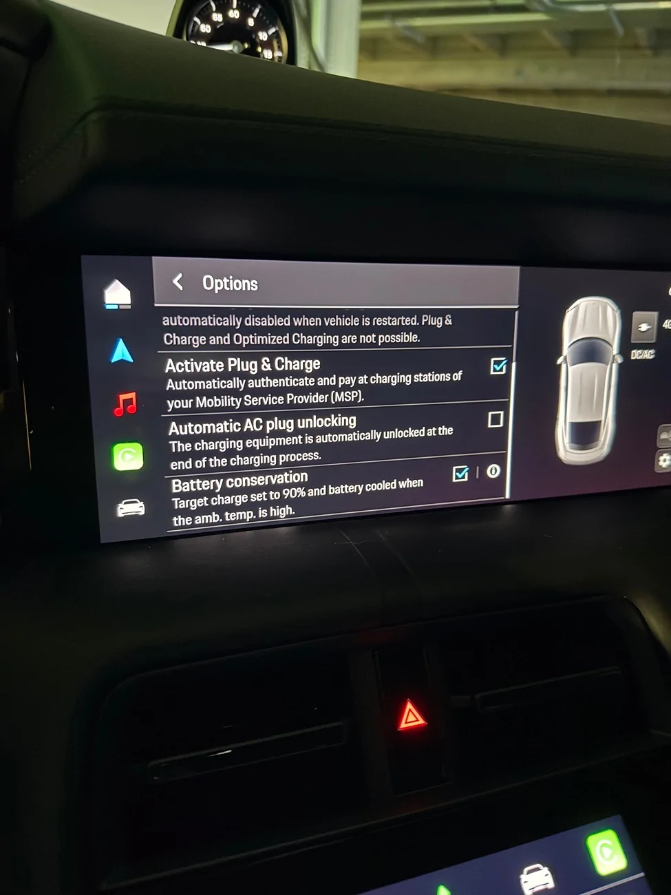

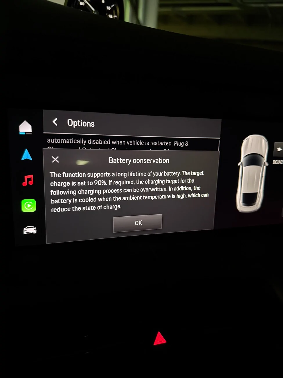

Normally I put on the "battery friendly" option when charging (Which changes the curve and caps it at around 200kW) just because we usually need more time at the stops than it takes when the option is not on :) I don't care too much about the battery temp as I only use DCFC a handful of times each summer.
I noticed this as well on my recent trip. The car was annoyingly ready before I was, causing me to rush back to unplug and re-park the car.
I'll use the Friendly mode next time to buy time. We also have stations that limit max charge to 85%
gnr3312
Dec 22, 2025
593
324
Austin
2024 Taycan 4S
Is the “Friendly” mode only on J1.2? Don’t think I’ve ever seen this in mine (2024).
