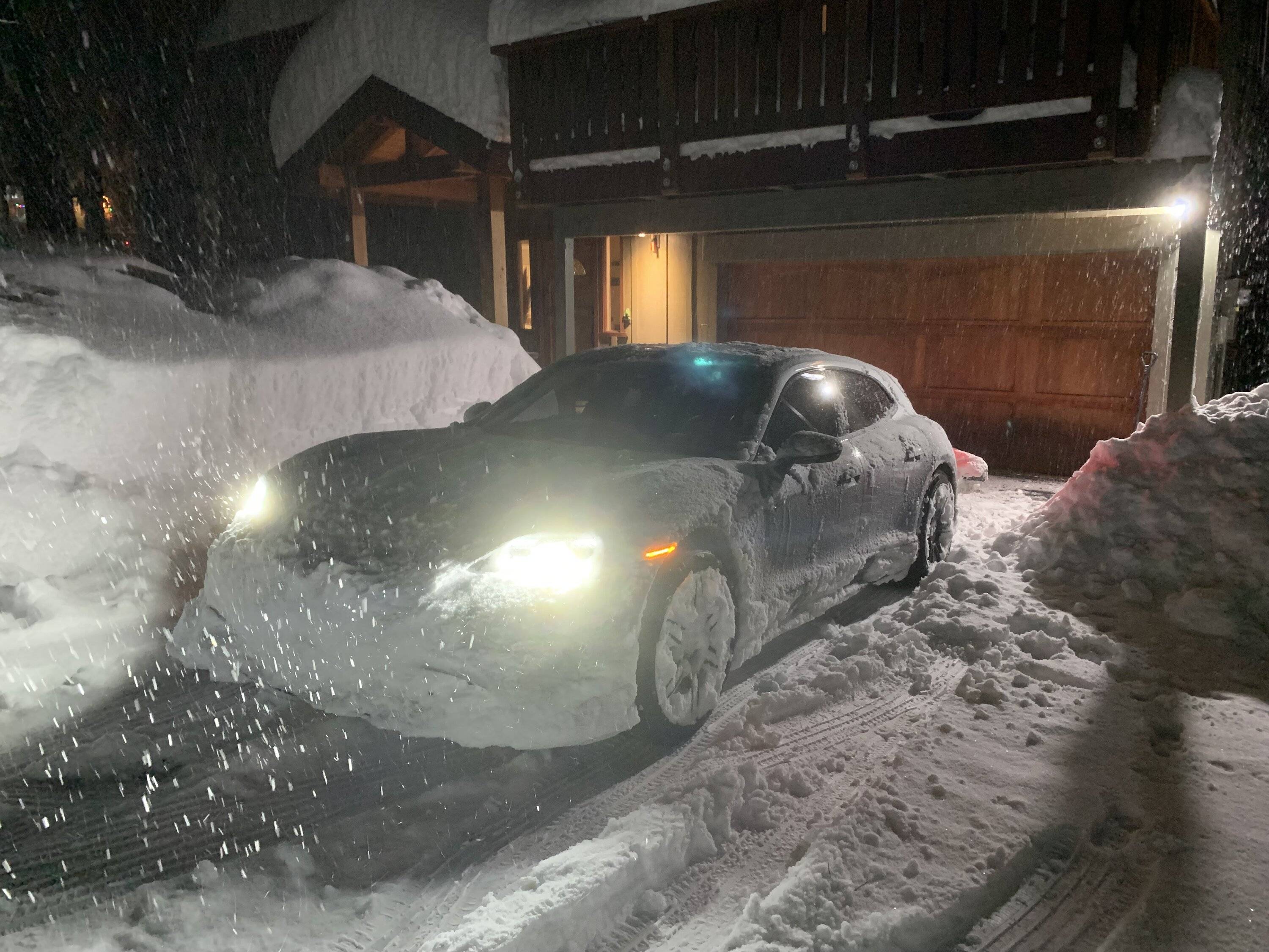

bsclywilly
Aug 13, 2021
711
1,184
San Jose
CT4
Did someone say plow?
Porsche Taycan Extreme Winter Driving pros and cons with Taycan IMG_9204
Got my aero wheel covers on too.
I’ve actually found the grill flaps to be closed most if not all the time driving in the winter. Surprised to see very little debris in front of the radiators after driving in some pretty crazy conditions.

"Unlike an ICE car, it never heats up on the hood, undercarriage etc. This can lead to snow build up in wheels, on hood and other cracks and crevices since there is no melting while driving. After three days of wet snow during day and freezing at night there was considerable accumulation."
I was confused at first on Sunday when I was driving home in a snowstorm and my hood stayed all snowy ... then I remembered, oh yeah, no engine up there!
Otherwise, no complaints.
Here's a pic of my CT in the snow when we returned from backcountry skiing to the trailhead.
The entirely unplowed trailhead parking lot, with about a foot of snow.
You can see how the front end has been acting like a plow as I pulled into the lot, in Gravel Mode with the Lift height setting.
Super easy though blasting out (with 20" Michelin CrossClimate2 tires).
TikTok here from my social media consultant (i.e., our teenage daughter), with skiing so good that a friend came all the way from Richmond Virginia!
(Actually, he came all that way for the ski mountaineering race I had organized the prior day, but he *stayed* for the powder!)

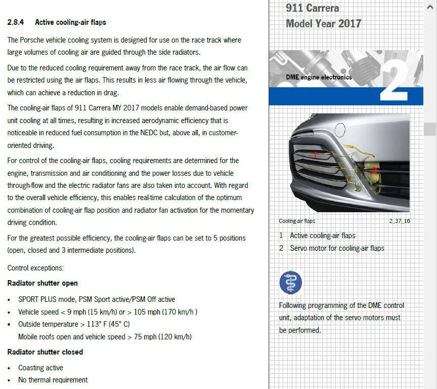

Do your grill flaps close when it’s cold.
I have never seen my flaps closed! Guess that is one for service to check.
My consumption driving in wintry Sweden and Norway is 30 -34 kWh per 100 km. which seems very high. And the air intakes are fully open and now very dirty with salt and Schmitz
I suspect the cooling flaps operate on a similar algorithm as other Porsche cars (see below description for 991. Below 9mph they're always open which explains why you never see them closed. I noticed that the tops of the flaps are alot dirtier since they face forward when closed.

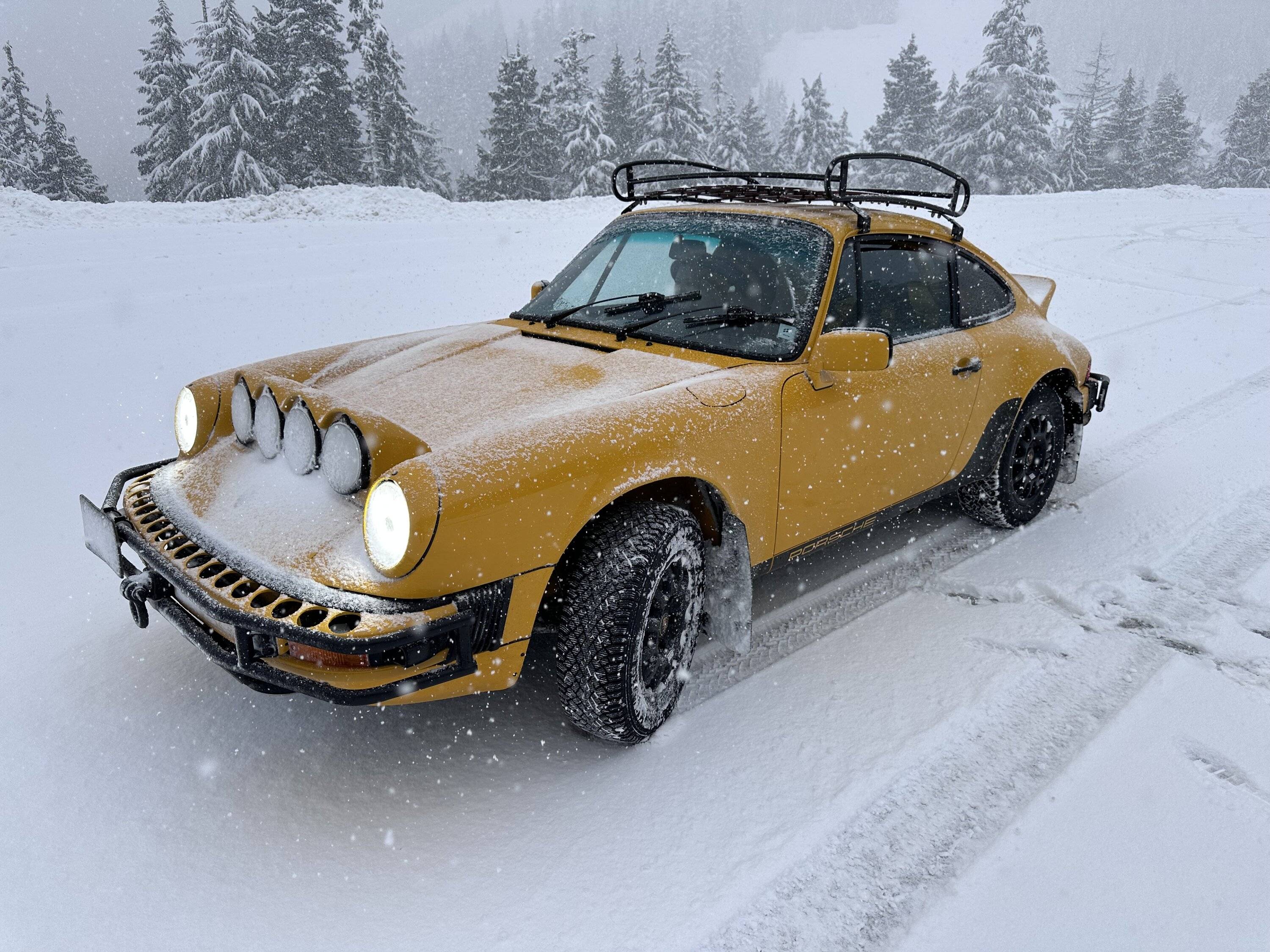

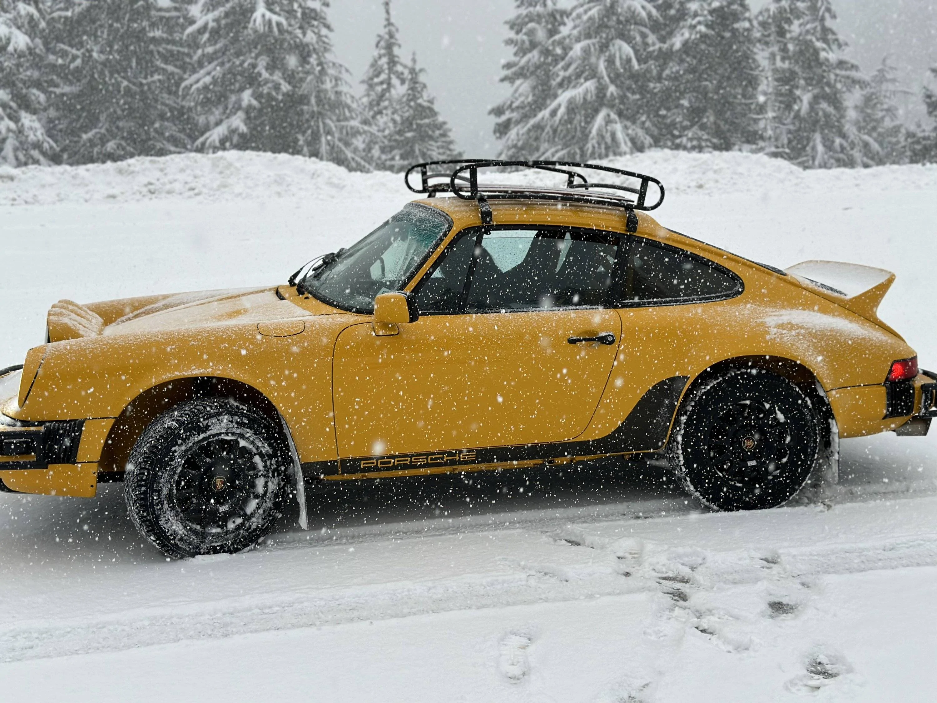

Winter tires are always tough to optimize. Deep snow you want narrow high profile with more of a lug. Frozen asphalt and ice you want wider and less tread.
I have a 1982 911sc on basically tractor tires and it is greet in deep snow.
