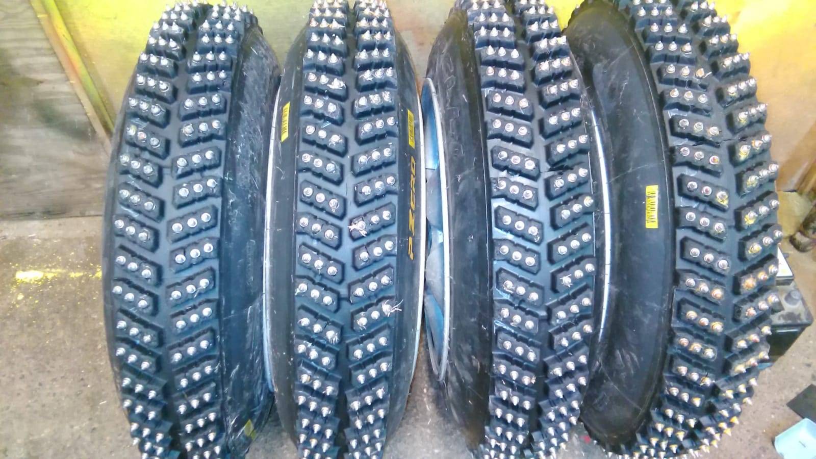

Trashcan 4S, 997 C4, Willys MB + MBT, 628 CSiA, ST4S, 750 Paso, AJS, Condor ..
Interesting and comprehensive observations.....yes, the window freezing has been a challenge, but I can usually give the window a tap and get things going...It happens with the other Porsches with window drops. We have not had enough heavy wet snow to have the wheel packing that you describe. Have you tried Nokian tires? Their silica compounding should help with braking/turning on icy roads.
The window drop has been problem since it's invention.. more or less. It's as bad now as it was in 628 BMW 1982.
The Nokian winter's are good on ice and very good on hard snow. With Taycan's traction control it really shoots out of snowy corners.. but in the next corner where you have 5-10 cm of loose powder - the wide one is not the best. There's a reason why the rally tyres are not so wide.
(we use these on our lake track)
Porsche Taycan Extreme Winter Driving pros and cons with Taycan IMG-20190303-WA0001
3,907
3,552
Well that is real fun on ice tracks. Have been doing that with Subaru’s some time ago! So much fun!
