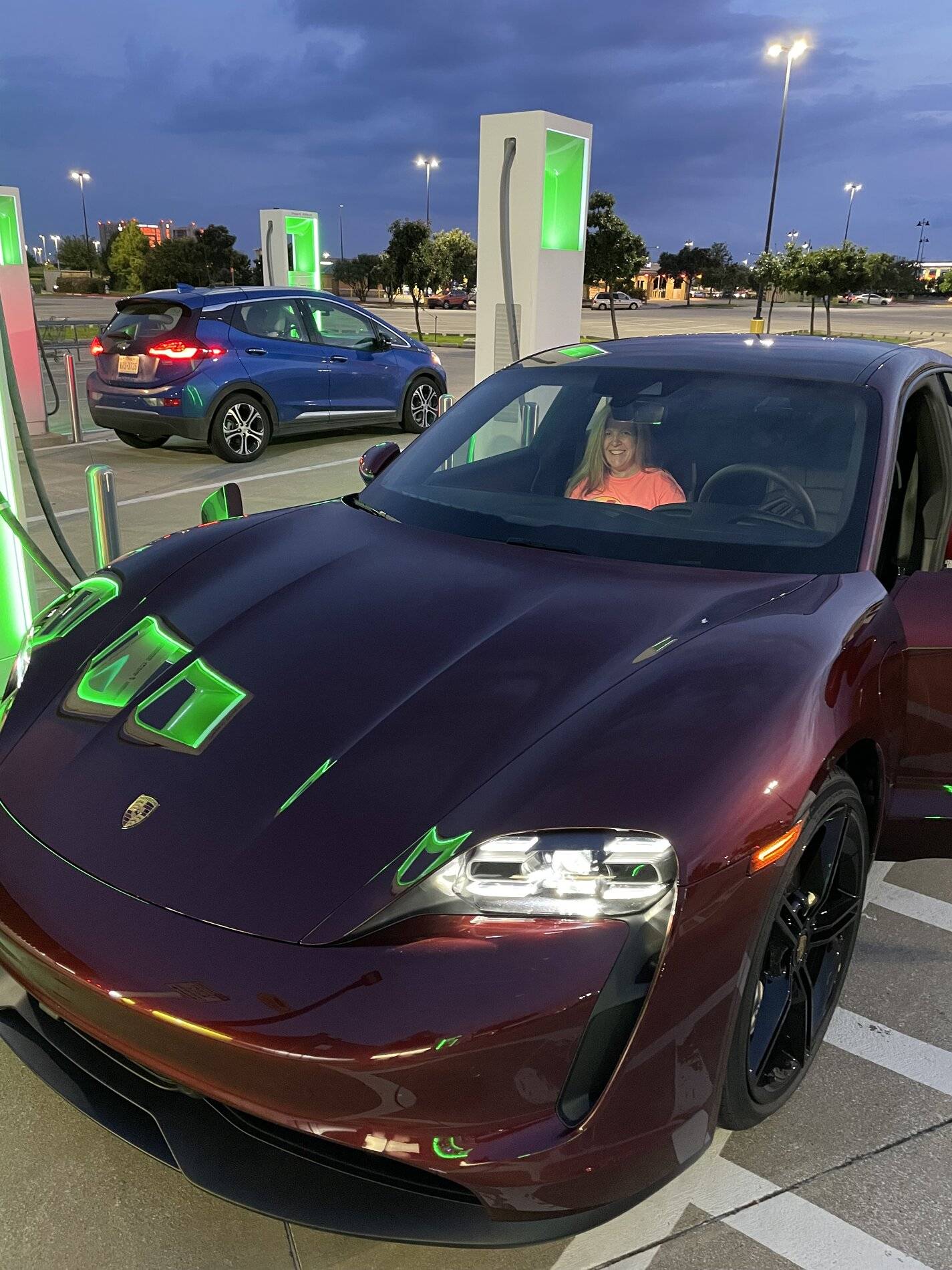

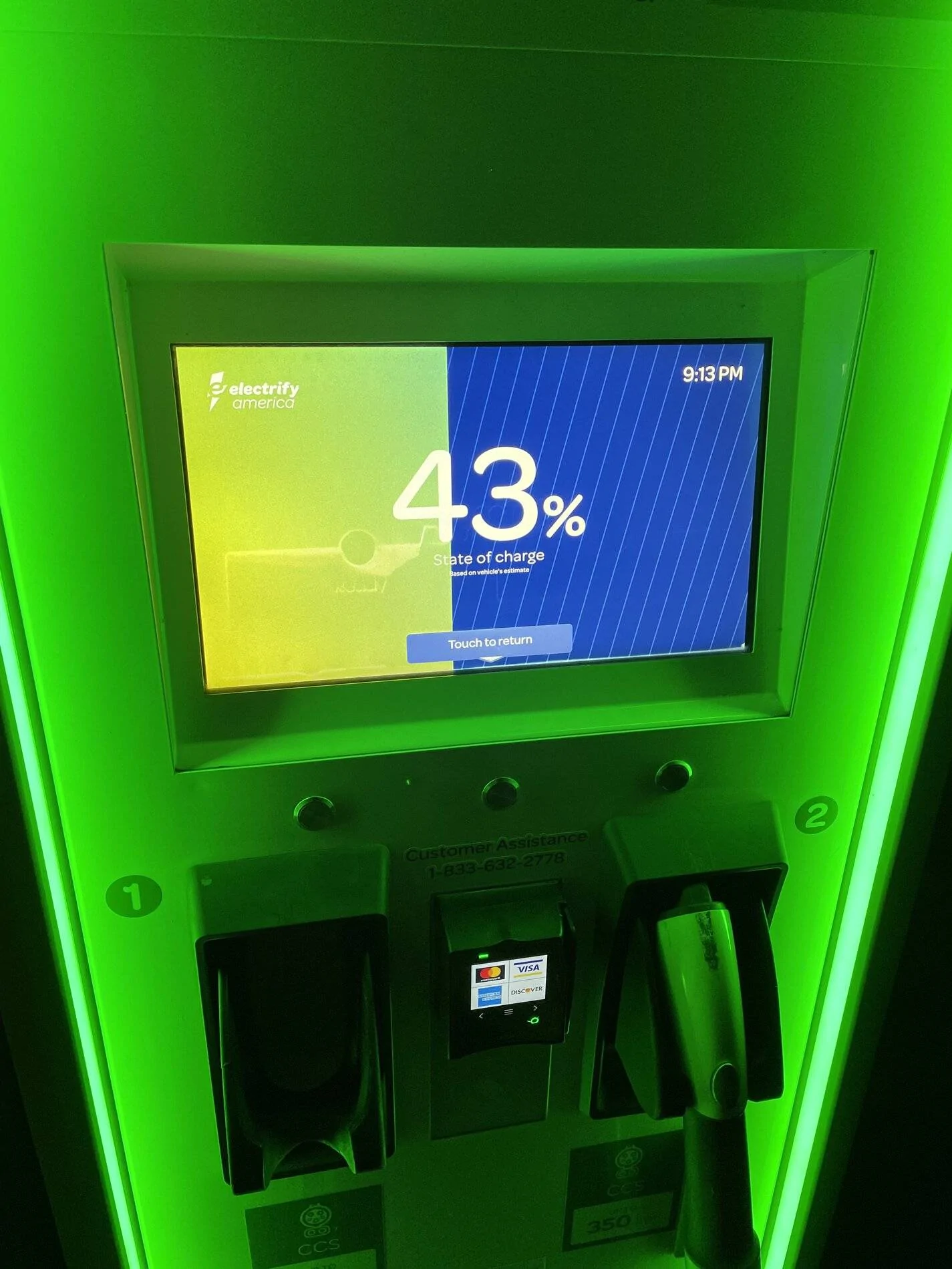

We decided to make a mini road trip to the nearest EA charger and try it out. The first 350kw charger I tried refused to work. The second one did work (after 2 tries) but inexplicably stopped 10 minutes in, which was suboptimal. It was rated at up to 350kw but it ran just over 150kw...is that a normal experience?

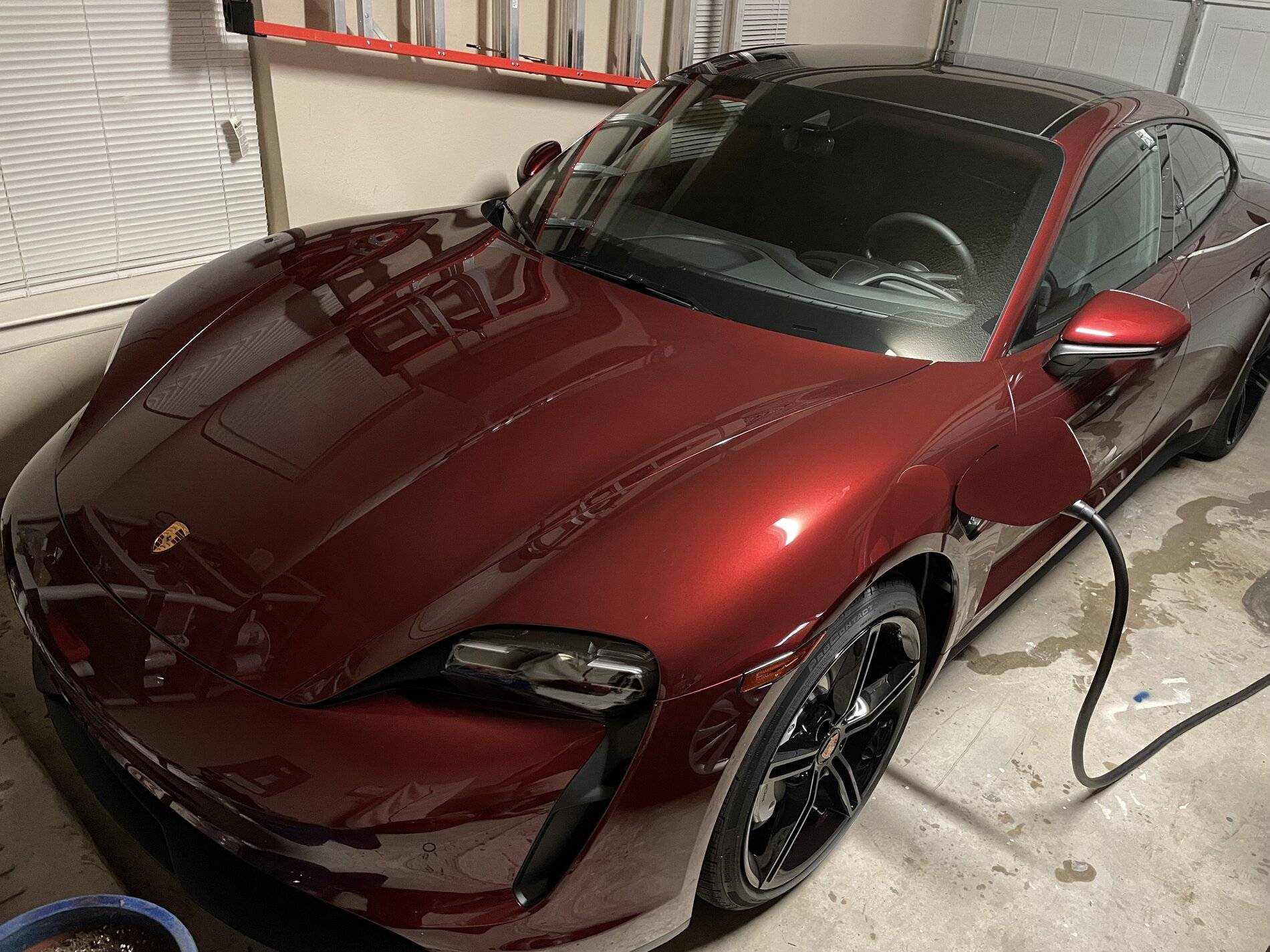

I then took it home and hooked it up to a Tesla HPWC with a TeslaTap and...that didn't work either! I discovered that the problem was the general charging profile was set to 25% and we were over that. I wonder if that affected the fast DC charging too?
I need to enable Plug and Charge and give that station another try.
Onboard charging at home kinda sucks (1/2 the speed of the Tesla) presumably due to a slower onboard charger.

What’s the amperage of your HPWC circuit? Did you spec the 19.2kW on-board charger? With David’s new 80A TeslaTap mini & my HPWC, so far I’ve seen the car demand nearly 18kW when topping off to 80%.

Sadly no. I see just shy of 11kW on the 60 amp teslatap to a 48 amp wall connector on a 60 amp circuit.

  • 25% minimum charge does not affect DC fast charging
  • 11 kW (48 amp charging) is the standard factory option - this is behaving correctly for a home charger (like the Tesla Wall chargers)
  • let us know how plug&charge works
  • 150 kW for an EA station is pretty common - you won’t get more than that unless your battery is below 20-30% SOC…but I’ve owned Tesla‘s for 7 years, and the Taycan charges faster due to less tapering until 90% SOC - ignore the peak charging marketing number - this car rocks at charging with more than 150 kW charge rates deep into the 80% SOC range
congrats - beautiful color - my favorite other than my Blue…

don’t be sad about not spec’ing he 19.2 kW charging - currently it is incompatible with Plug&Charge - you can have Plug&Charge _OR_ 19.2 kW charging - but currently you can’t have both.
