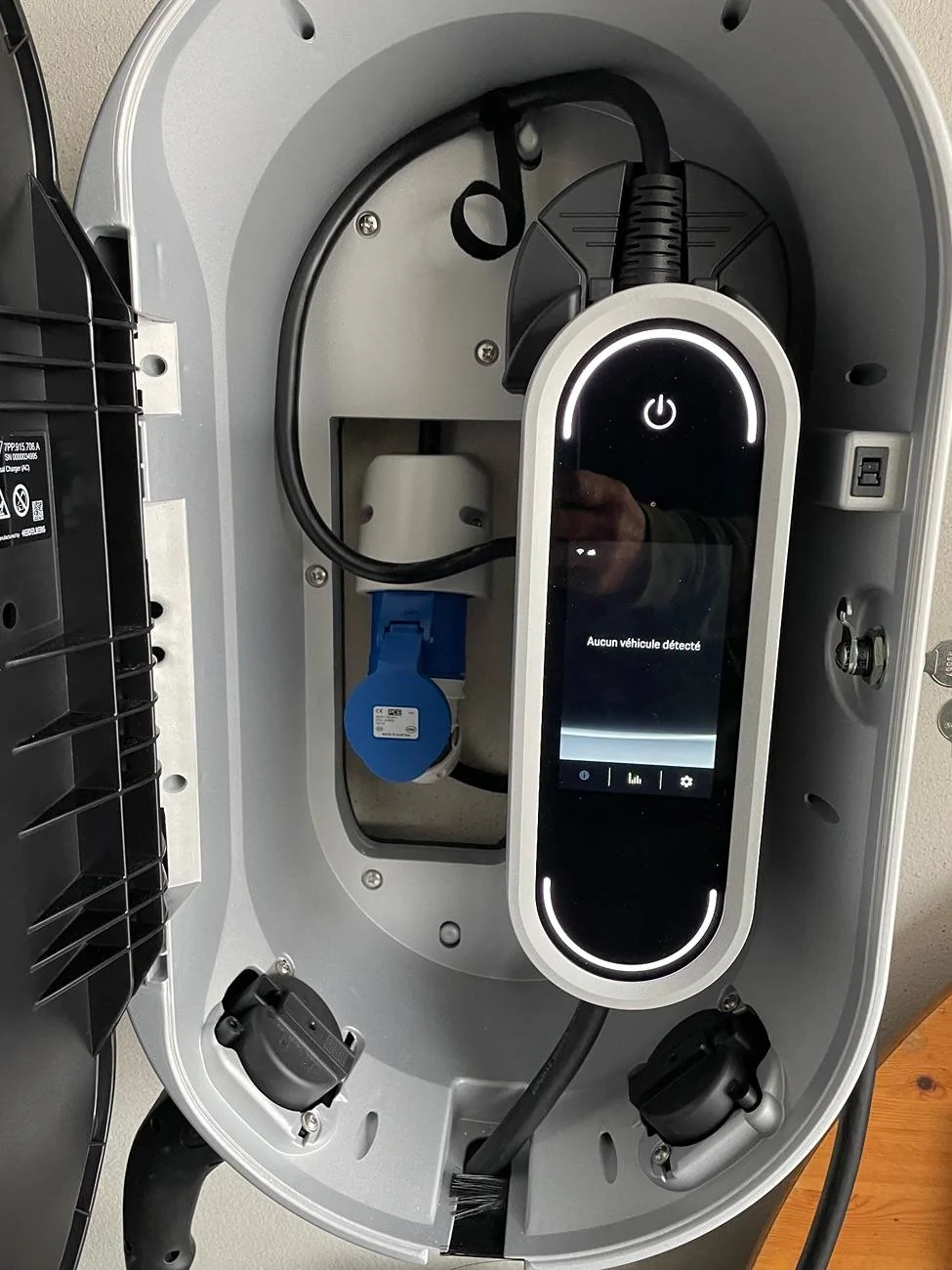

Good morning
I’ m using the Porche Connect Charger delivered with my car. My electrician put a 32a monophase plug and I installed the Porche Charging station. I set it up to 24a wich is enough for me.
It works well and allow to have full exchanges with myPorche App

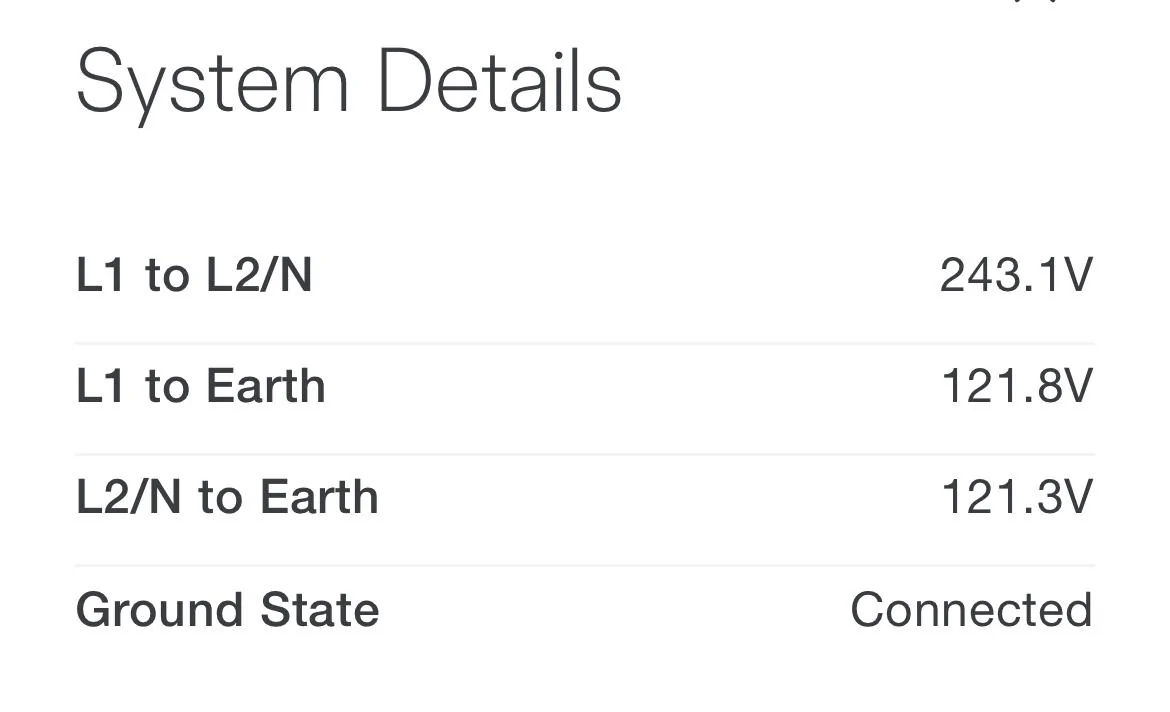

Hey everyone - I had the Tesla universal wall connect installed/hardwired today! Thank you for all the advice and guidance!
I see these figures in the system details in the Tesla one app. Do they look right for a 60amp circuit breaker installation for the maximum output of 48amps? I don’t have my car yet so I can only rely on what I see in the apps right now.
that looks correct - unit default to 60 amp breaker (48 amp charge rate) - if you didn't change it that should be the setting - there are other screens on the web portal where you can inspect that
_OR_
you can plug in your car and look at the charge rate on the lower center screen - if the charge rate is above "9 kw" - you're getting the "full" 48 amps.
243 V is 100% in line with specifications and expectations for your hook up.
