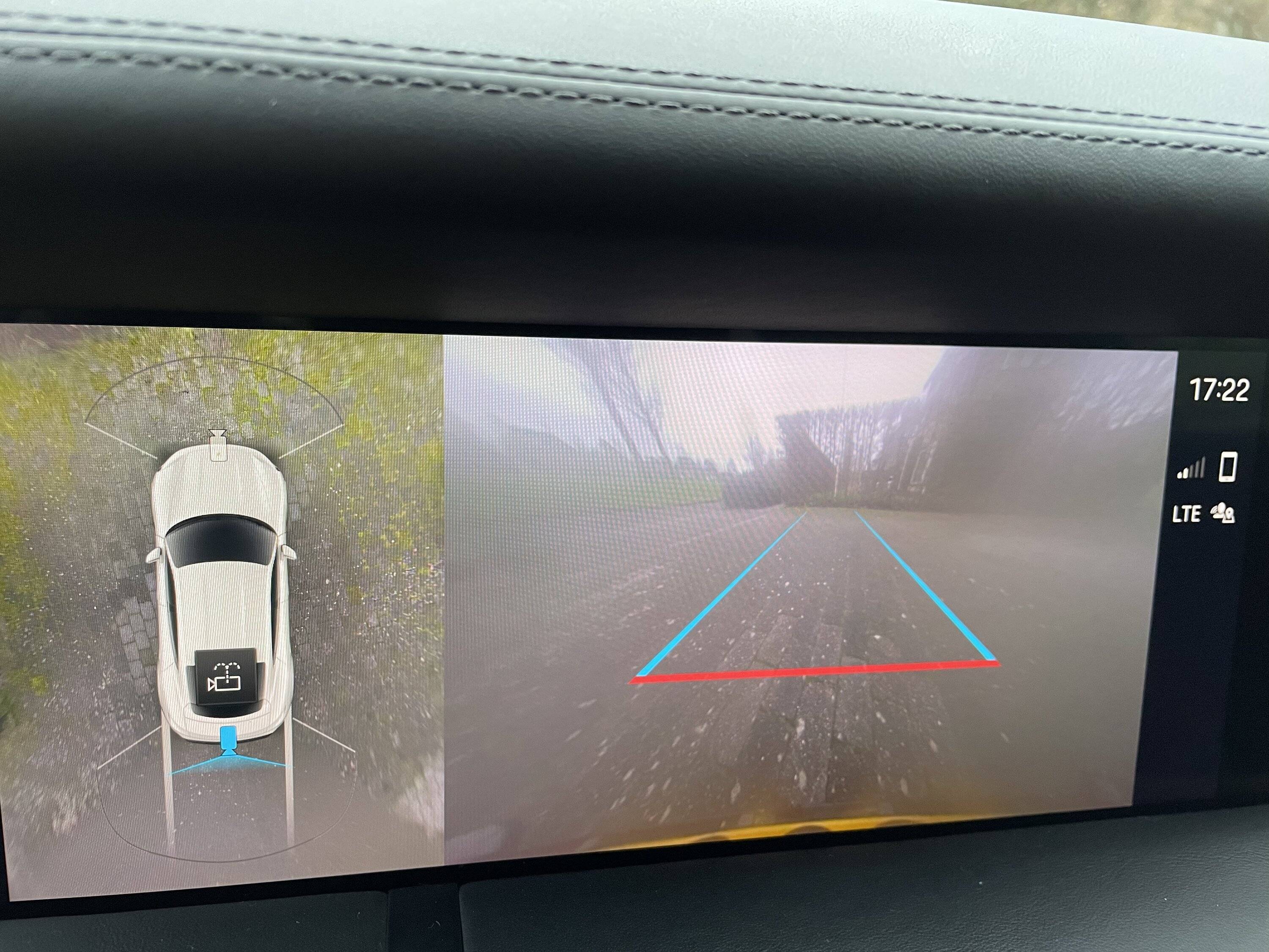

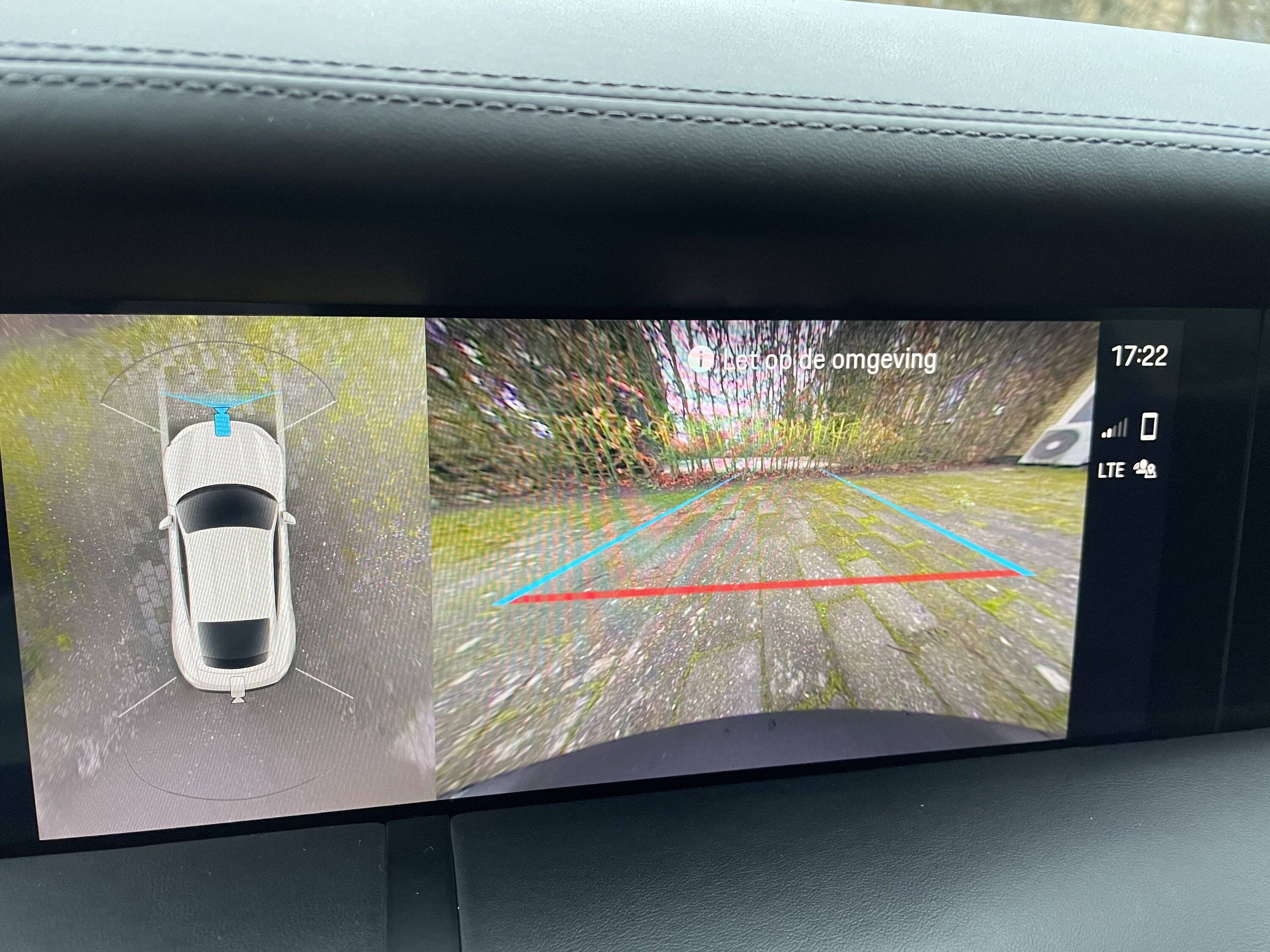

My front cam is more crisp than my rear cam, rear cam seems foggy, lens is clean, I know how to spray. Also look at 360, is this normal?

Faulty - take it back. Having posted a picture of the camera being perfectly clean : )

Yes, lens is clean, looks like camera is no longer air tight and condensation on inside.

Had my front camera replaced after bad seal with water entry

However, I’d say that your camera is faulty and needs repair. Much have loose housing somewhere. The rear camera isn’t perfect, but it’s a lot better than that.

I'm sure they'll fix it, just hope they diagnose over whatsapp, rather than driving up there 2x

Dealer will replace cam next Tuesday, leak and condensed on inside.

Camera has been recplaced today, the picture is as it should now.
