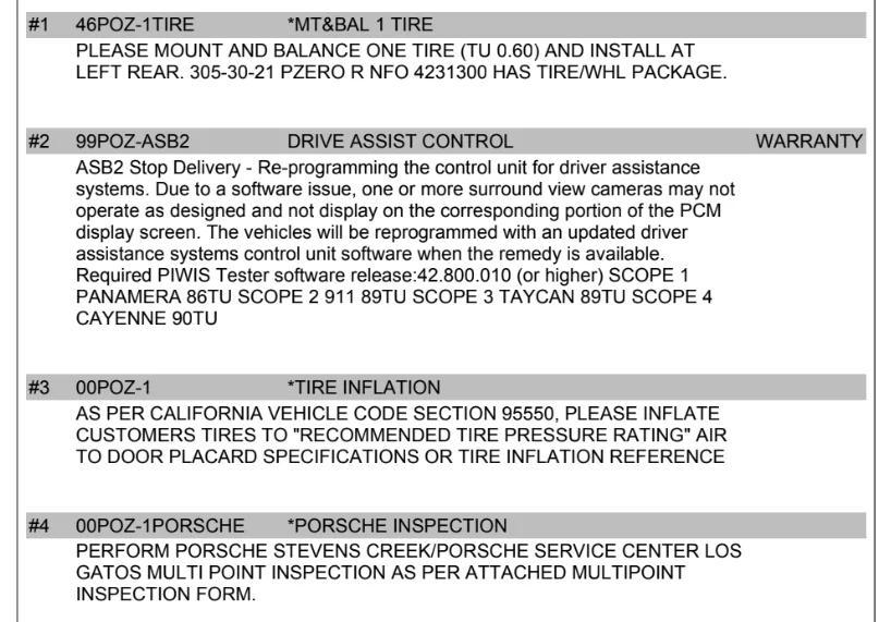

You guys should read what they are actually saying in there.
"The vehicle will be reprogrammed [...] when the remedy is available"
They only checked that the recall is applicable, the recall action was not performed yet, because the remedy - the updated software - is not yet available.

You guys should read what they are actually saying.
They only checked that the recall is applicable, the recall action was not performed yet.
When mine was in for service, they kept it 90 minutes after the tire work was done to apply the patch. So something was done.
They only checked that the recall is applicable, the recall action was not performed yet, because the remedy - the updated software is not yet available.
In the US, the NHTSA (government) web site AND the Porsche US web site says: "the remedy is available"
