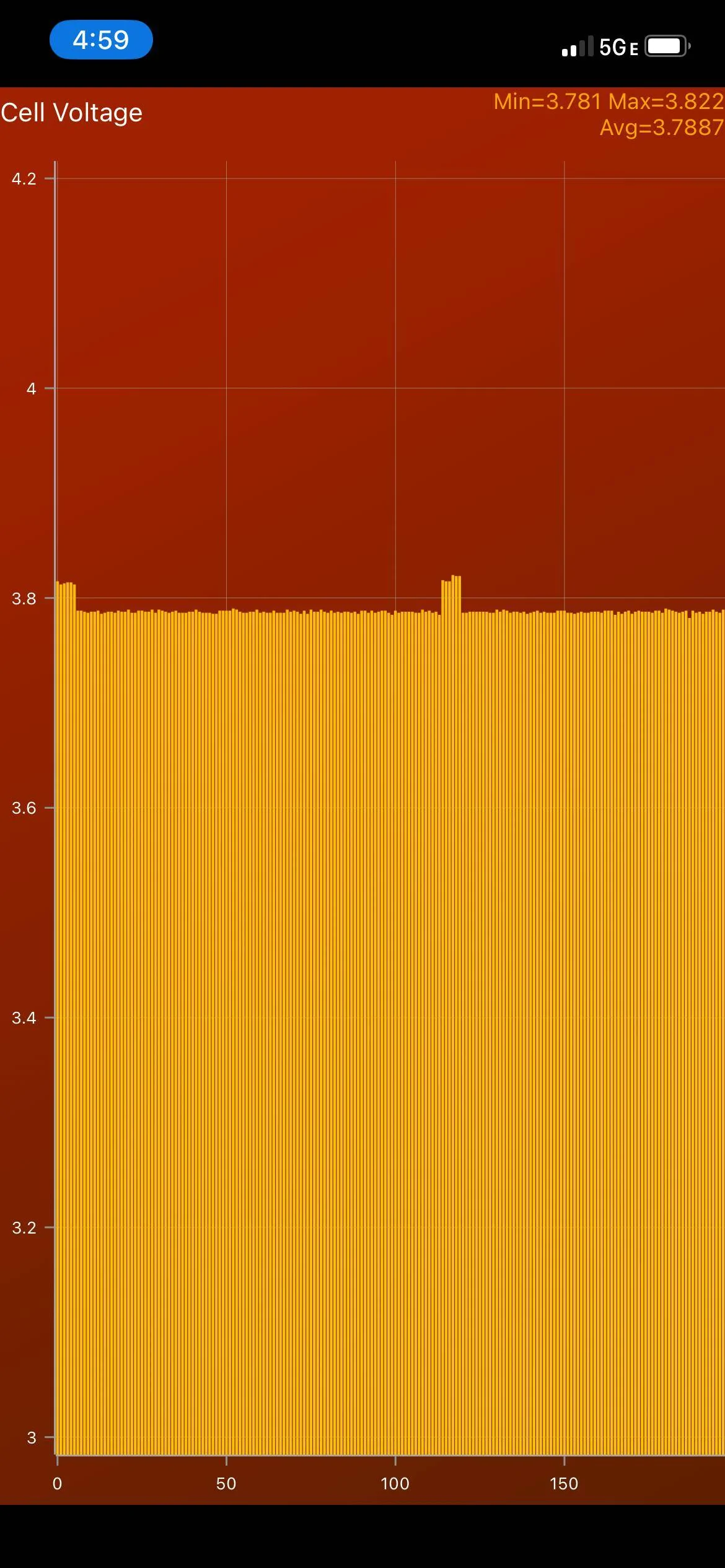

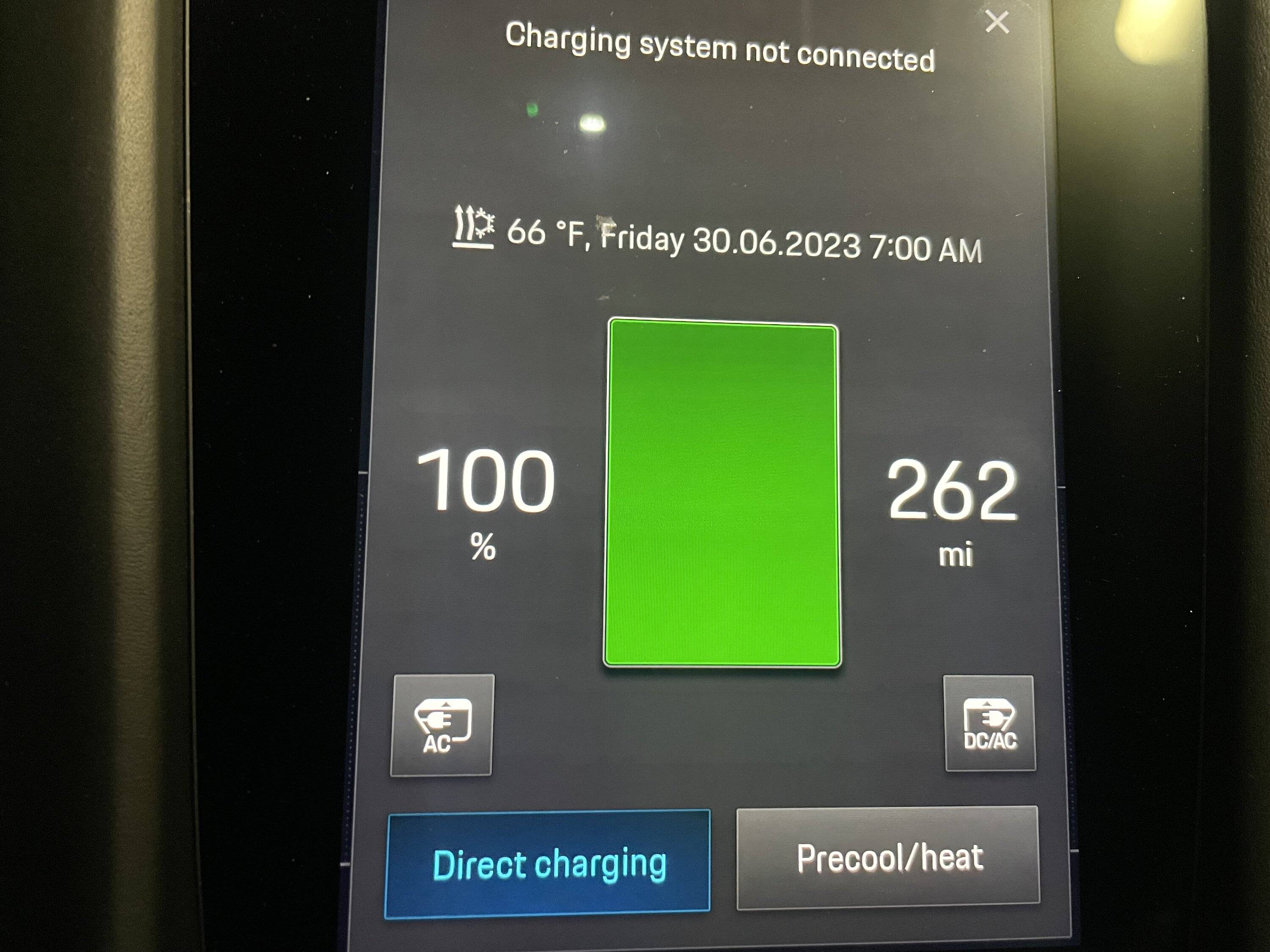

At this point, I've followed the recommendation to 'rebalance' the cells by driving to 15% or so and letting the car sit overnight, then recharge (using the home charger) to 100%. I did this couple days ago and the range improved massively - pic below. I will do the 'rebalancing in another few weeks and see if there is any further improvement, but I'm pretty much back to as good or better than before my two bad cells. The below pic is in 'Range' mode, and it's some 30 miles better than before the 'rebalance'.

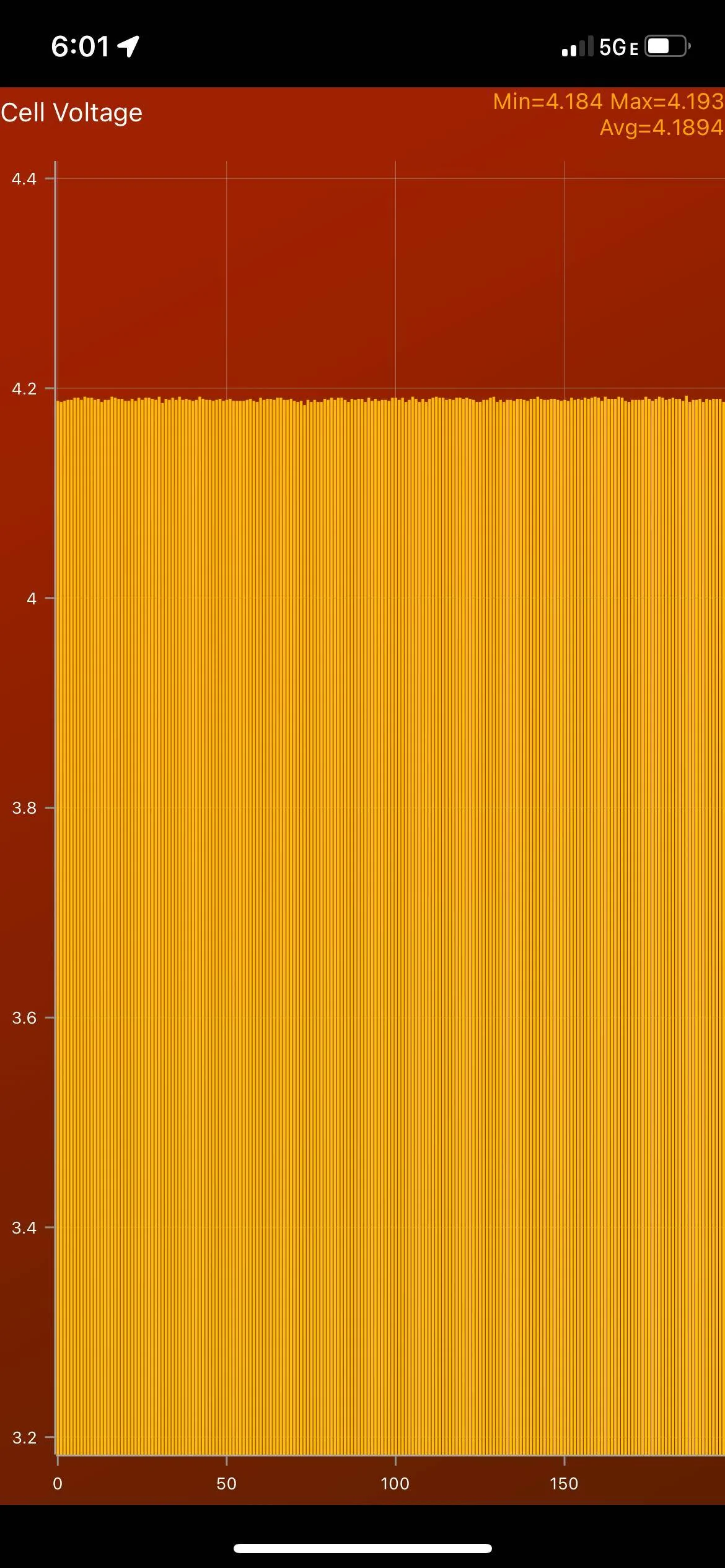

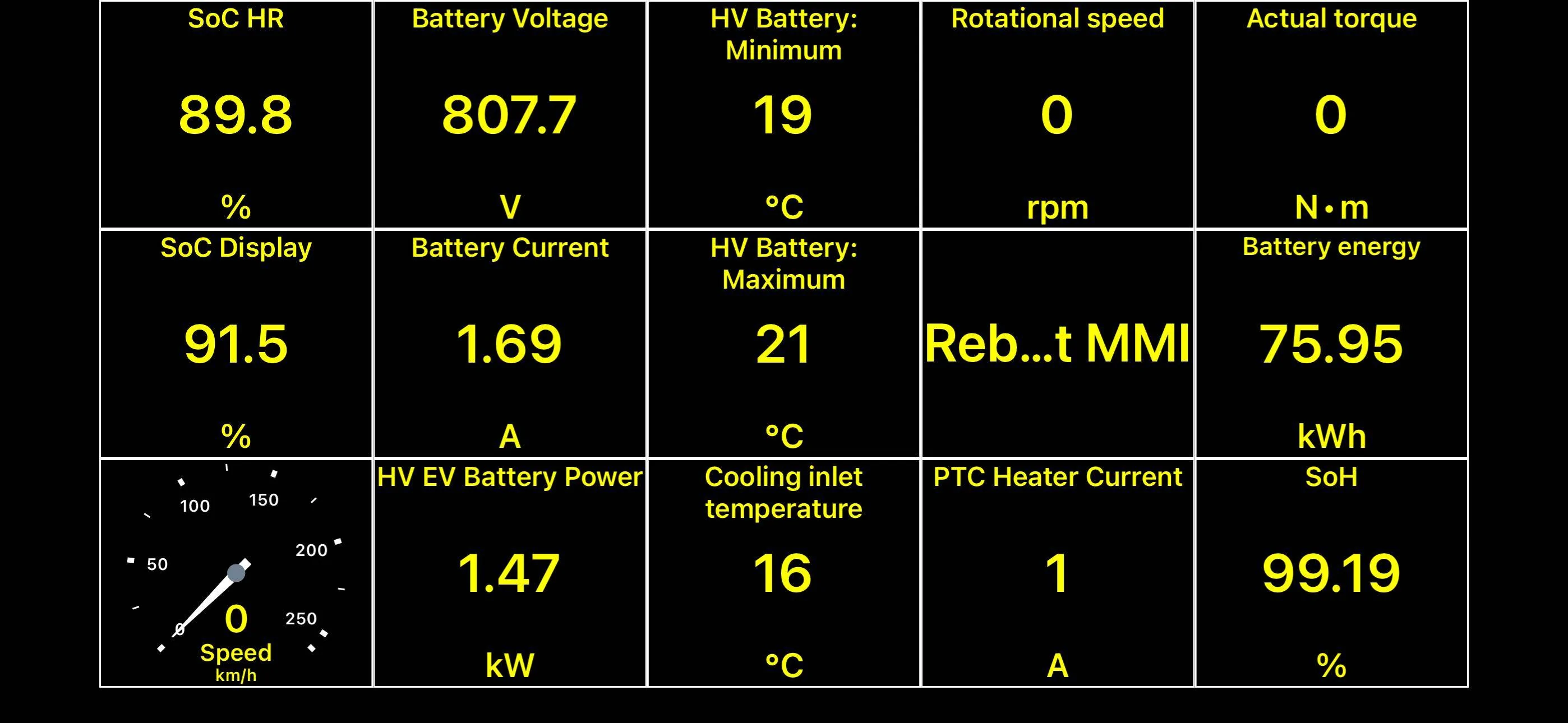

The most peculiar thing for me though is my SoH? I have driven the car about 3000 km after the repair, and my SoH still is over 99.1% which makes no sense after 58,000km’s.
I had planned to go out to the repair shop while here in Stockholm, to ask them if they have released some additional capacity from the reserve capacity? If that is even possible. Or else my CarScanner app is reading some false values? I have done about 10 readings now, but all in excess of 99%! I have even deleted the app and downloaded a new fresh verison, but still no change?

As I've stated before, and this is supported by the fact that an accurate SOH reading must be done at the dealer, and takes several days. Any OBDS reading of SOH is simply not an accurate measurement, so I wouldn't base any decisions on this reading. In terms of cell voltages, I'm still seeing quite an imbalance at the lower charge states between the two replaced modules and the older ones, but at high charge they are balanced (pic below). I would definitely follow the protocol outlined to me - run the car down to 15% or so and let it sit over night. Recharge to 100% using a slow (home) charger. Do this 3 times, then do it every month or so. That is what the battery tech recommended, and it seems to be working.
