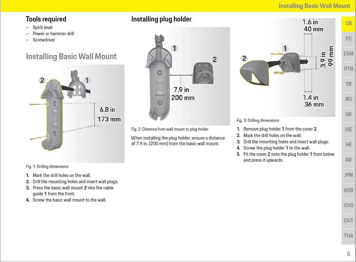

Did anybody got information from his dealer that there is also a basic wall mount available for the charger? It is shown in the installation manual. It should be less costly.
Porsche Taycan Getting Porsche Mobile Charger Connect before car delivery 1582353898744

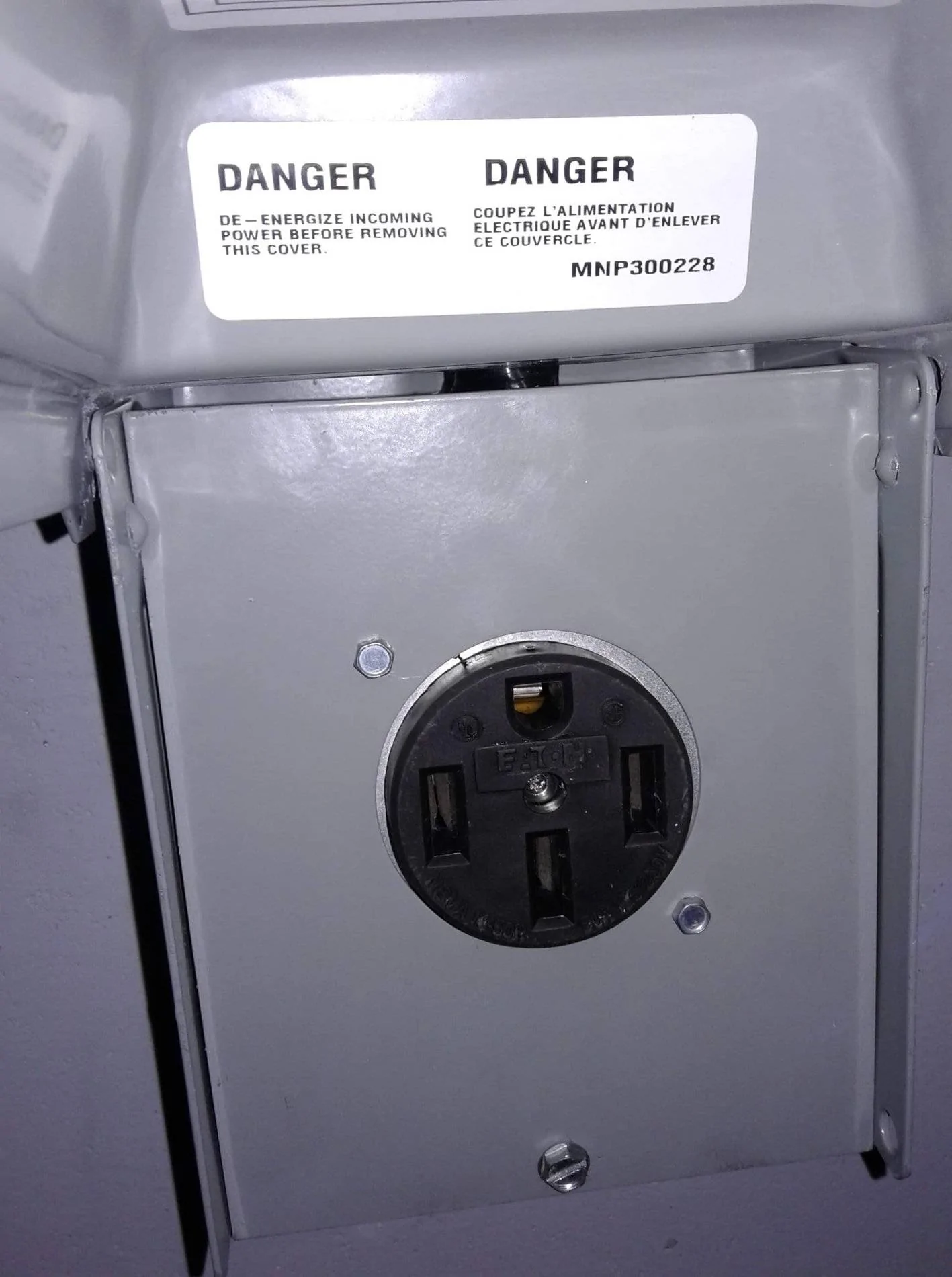

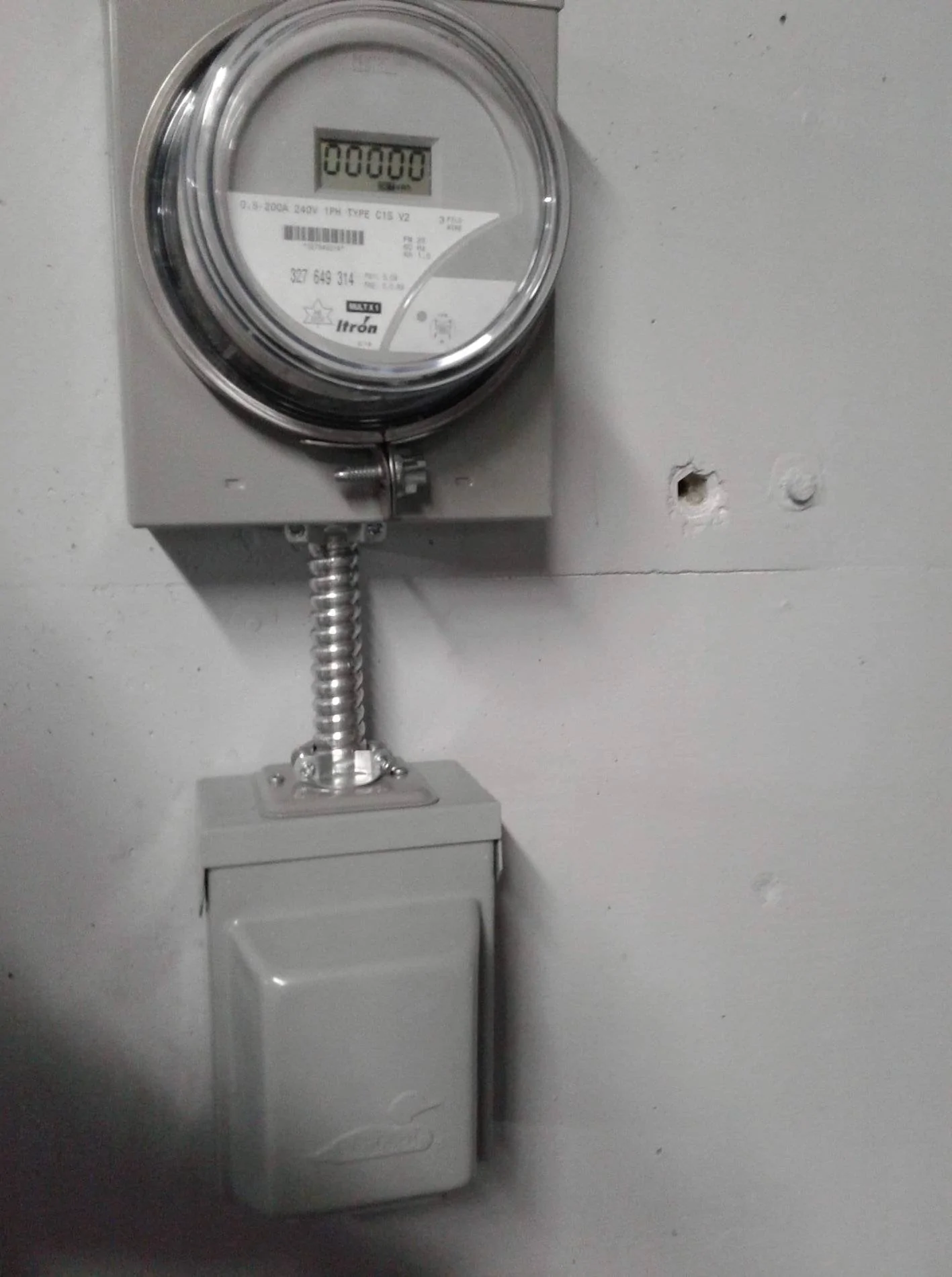

I am waiting my turbo S . I am lucky. I took the last available service in my condo buiding.
for your info
Description
Install 14-50 for ELECTRIc car with wire # 3 ALUMI. ( 200 feet from the the electric room )
meter 100 amp
Box 100 AMP.
oultlet 14-50 with lock. BREAKERS FEDERAL.2-40 AMP. CONECting box 1 inche TY-RAP.
Porsche Taycan Getting Porsche Mobile Charger Connect before car delivery 638C5A17-AD4C-49EF-9E40-A644E2A6C728
Porsche Taycan Getting Porsche Mobile Charger Connect before car delivery 94F57B07-6C01-40D0-926E-3505FE5658B2
Looks nice. I'll have to get me one of those.

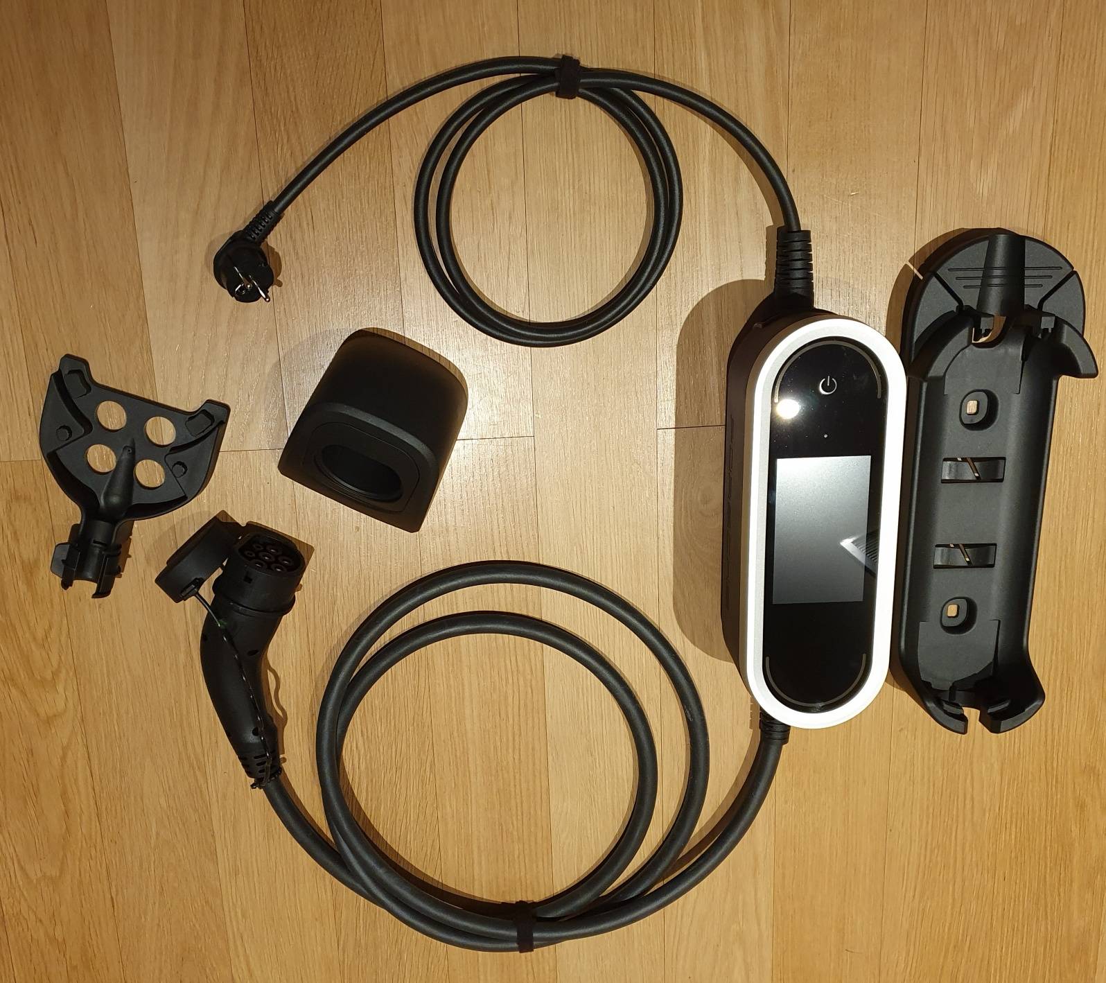

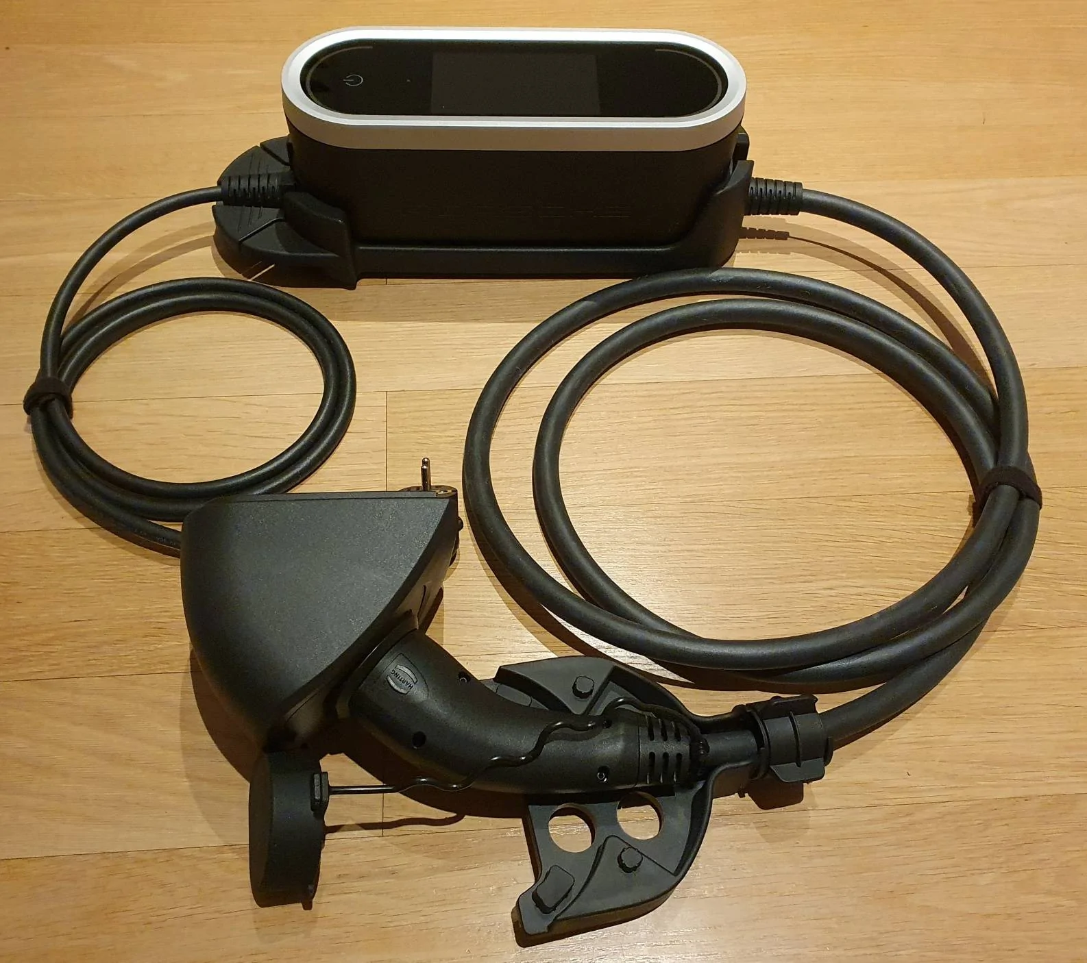

Hello,
here are two pictures of the charger as it came with the car. One picture is with the charger inserted into the wall mount and the plug into the plug holder. The other picture shows the charger and plug separated wall mount and plug holder. All these items were in the charger bag, no extra purchase was necessary as far as I can tell.
Cheers,
Henrik
PS: The cable guide should be next to the wall mount, not to the plug holder.
Porsche Taycan Getting Porsche Mobile Charger Connect before car delivery PT_MobileCharger-1
Porsche Taycan Getting Porsche Mobile Charger Connect before car delivery PT_MobileCharger-2
