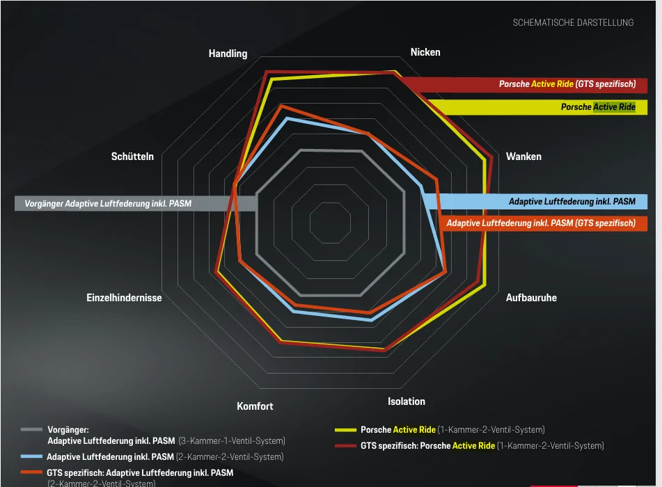

Maybe this graph will add value to the discussion. It is comparing J1.1 Air Suspension Standard / GTS with J1.2 PAR / PAR Active Ride
I was concerned that the GTS-ride would be too stiff. I have now 6k km on my J1.2 GTS ST odo (20 inch wheels) w/ PAR and LOOOOVVVVEEE the ride: So smooth, still so agile in cornering. Totally amazing. Great invest!!
It's purely damper compression/rebound valve characteristic settings in the suspension controller, nothing else. So only a software change, as the hardware itself is identical.
Of course if you would overlay e.g. GTS in normal and then a 4S in sport, then the graph would be skewed towards the 4S being harsher and so on.
You can do that all the way until sport plus where the GTS will be the firmest.
So that leaves the question: does the Turbo GT has an even more aggressive PAR tune than the GTS?
The tune differences are not PAR it's 90%+ the dampers. PAR has no effect on the high-frequency low-amplitude shaking (vibration) of the car, that's all wheel size and damper settings.
Oké let me rephrase myself ;)
Does the Turbo GT have an even more aggressive damper tune than the GTS?

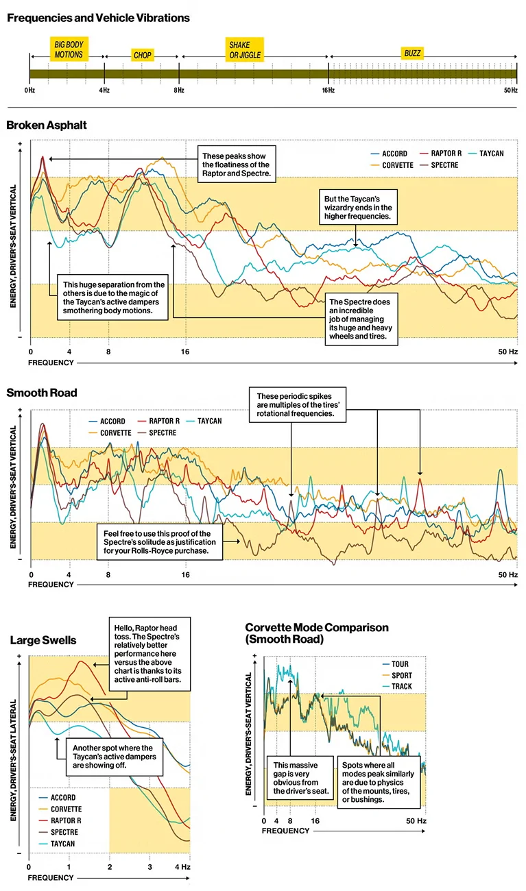

Car and Driver did a great test to show this:
https://www.caranddriver.com/features/a63410460/ride-quality-test/
Final graphic from that article shows how PAR greatly reduced low frequency (<4Hz) changes, but doesn't do much better than traditional suspension for higher frequency shaking and buzzes:
Porsche Taycan GTS Ride Quality with or without Active Ride 1771177234751-x2
