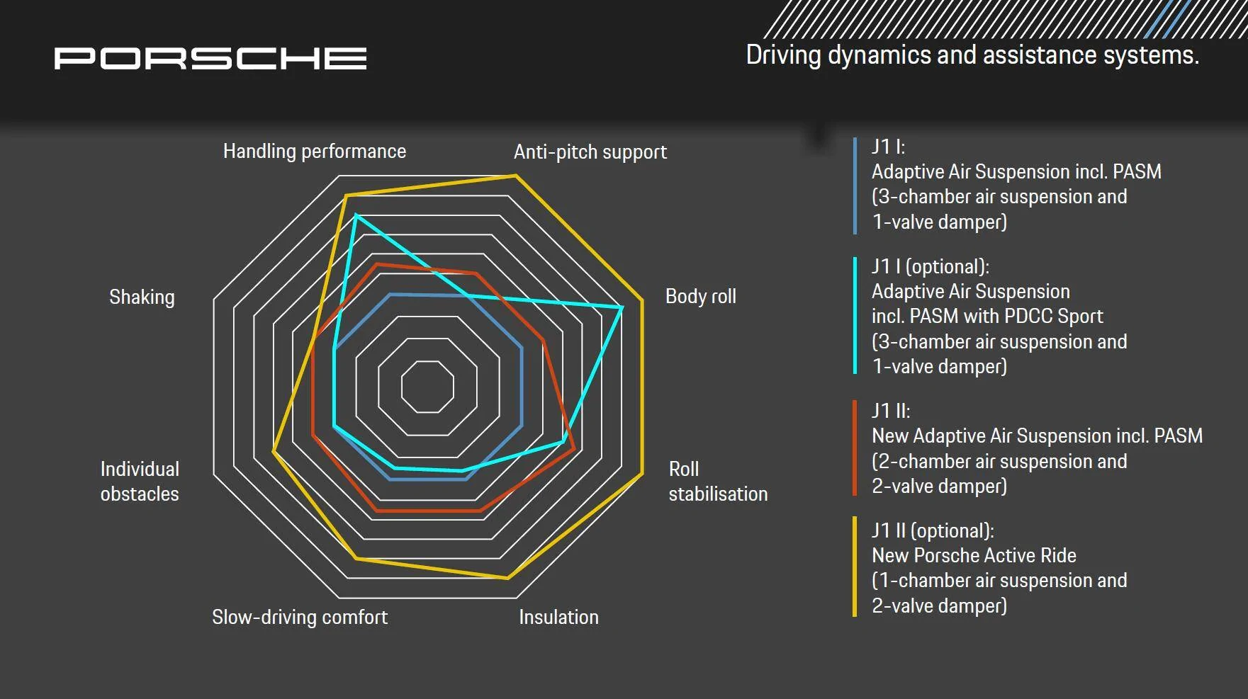

Porsche Taycan GTS Ride Quality with or without Active Ride Fahrwerksdetails
Maybe this graph will add value to the discussion. It is comparing J1.1 Air Suspension Standard / GTS with J1.2 PAR / PAR Active Ride
I was concerned that the GTS-ride would be too stiff. I have now 6k km on my J1.2 GTS ST odo (20 inch wheels) w/ PAR and LOOOOVVVVEEE the ride: So smooth, still so agile in cornering. Totally amazing. Great invest!!
sounds good - thanks for sharing. - clearly better ride than the 21” wheels with Summer Performance tyres.
How sharp is the steering with 20” wheels?

Porsche Taycan GTS Ride Quality with or without Active Ride {filename}
Would you happen to have any other slides on the GTS differences?
