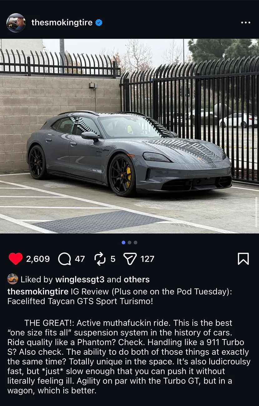

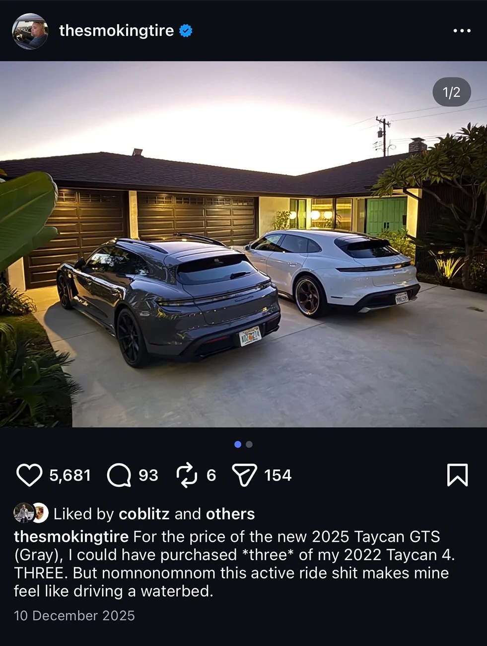

Also interested in hearing people’s thoughts to this post on Instagram by Matt Farah (TheSmokingTire), claiming the GTS with AR is on par with the Turbo GT’s agility & makes his CT4 J1.1 feel like driving a waterbed. 🤔

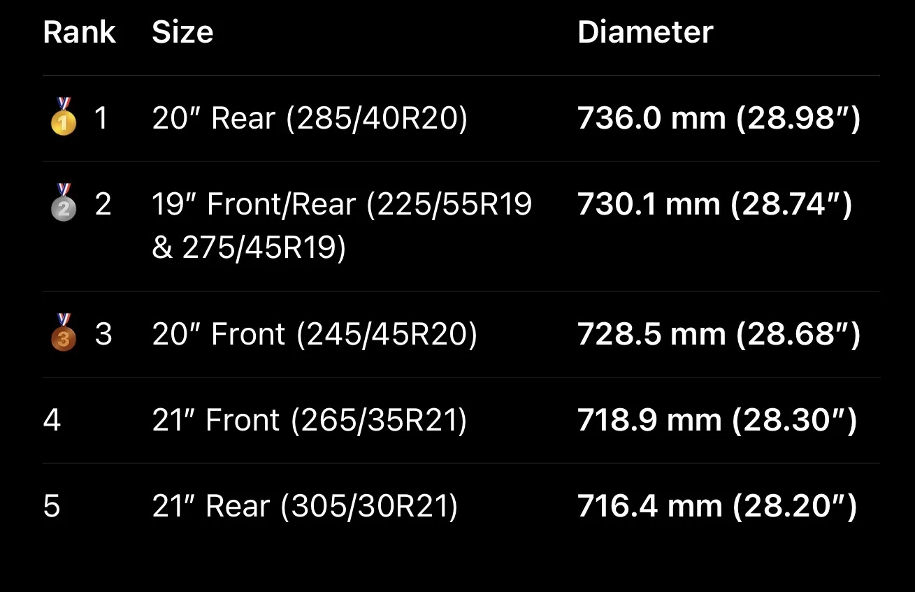

Odd fact on tires, 21 inch rears have the lowest overall tire diameter. 2.7% smaller than the 20 inches. Was not expecting them to exactly match but this is a surprisingly large difference, means the 21 inch set up will have a slightly higher tractive force 🤣
