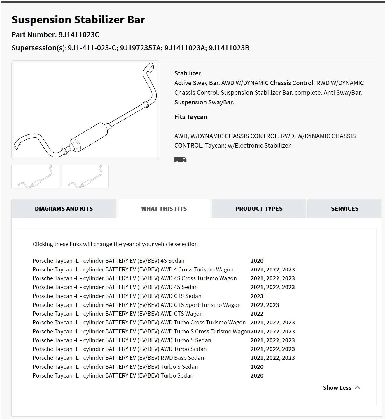

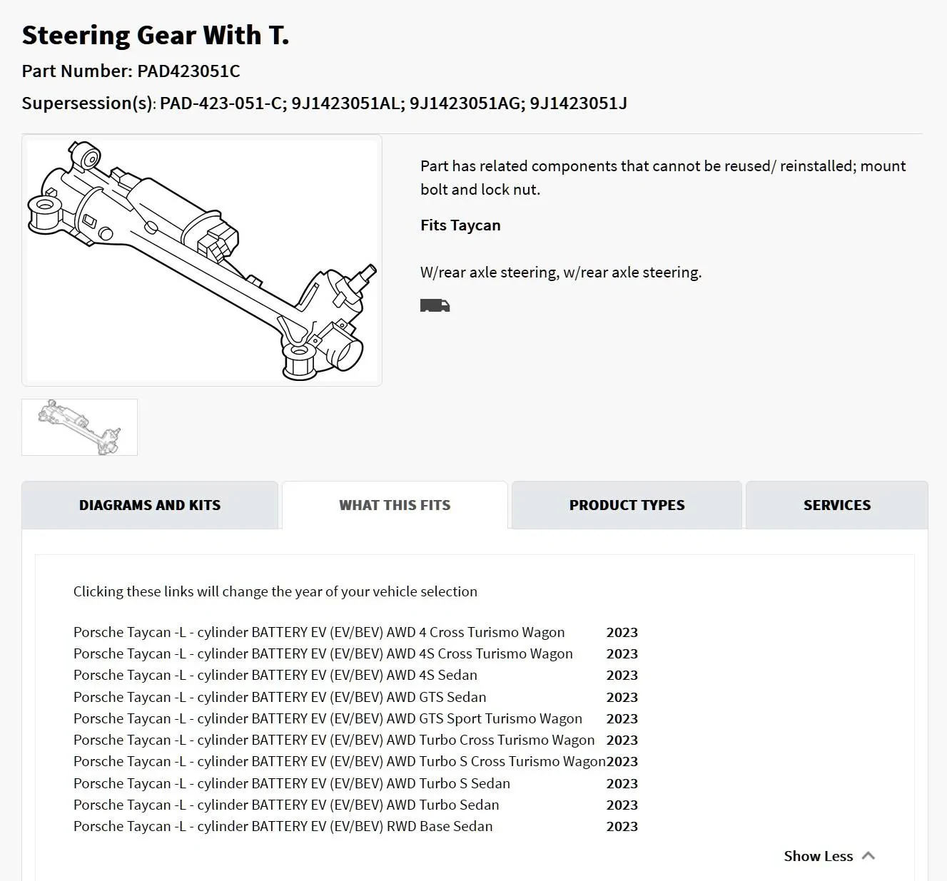

I checked on a Porsche dealership parts department site, and I checked suspension parts. I did not check exhaustively, but in every case the same part was on both the GTS variants and Turbo variants. And usually a lot more Taycan models. And in the case of the RAS steering rack, the rack is also shared with the Panamera. The air springs were the same, GTS or Turbo, the sway bars were the same, the coil springs and struts, the front and rear steering racks.
I'll attach just two of the many examples since I quickly realized there was no point in keeping record any longer since they were all the same.
It looks like the GTS differs from the Turbo only in software, and that any difference in feeling or handling characteristics is entirely due to software and specific configuration, not due to any suspension hardware.
So just as people speculate that the GTS could have the same power as the Turbo if the configuration parameters could be changed, it may be the case that the Turbo or other models could have the same "suspension" setup as the GTS if they likewise had the configuration.
I was pretty sure the active ARB and rear wheel steering hardware would be the same. It makes no sense for them to be differentsince they are software controlled. Both of these are options though, not standard fitment (or at least not here in the UK).
I thought I read the normal ARBs were stiffer on the GTS.
