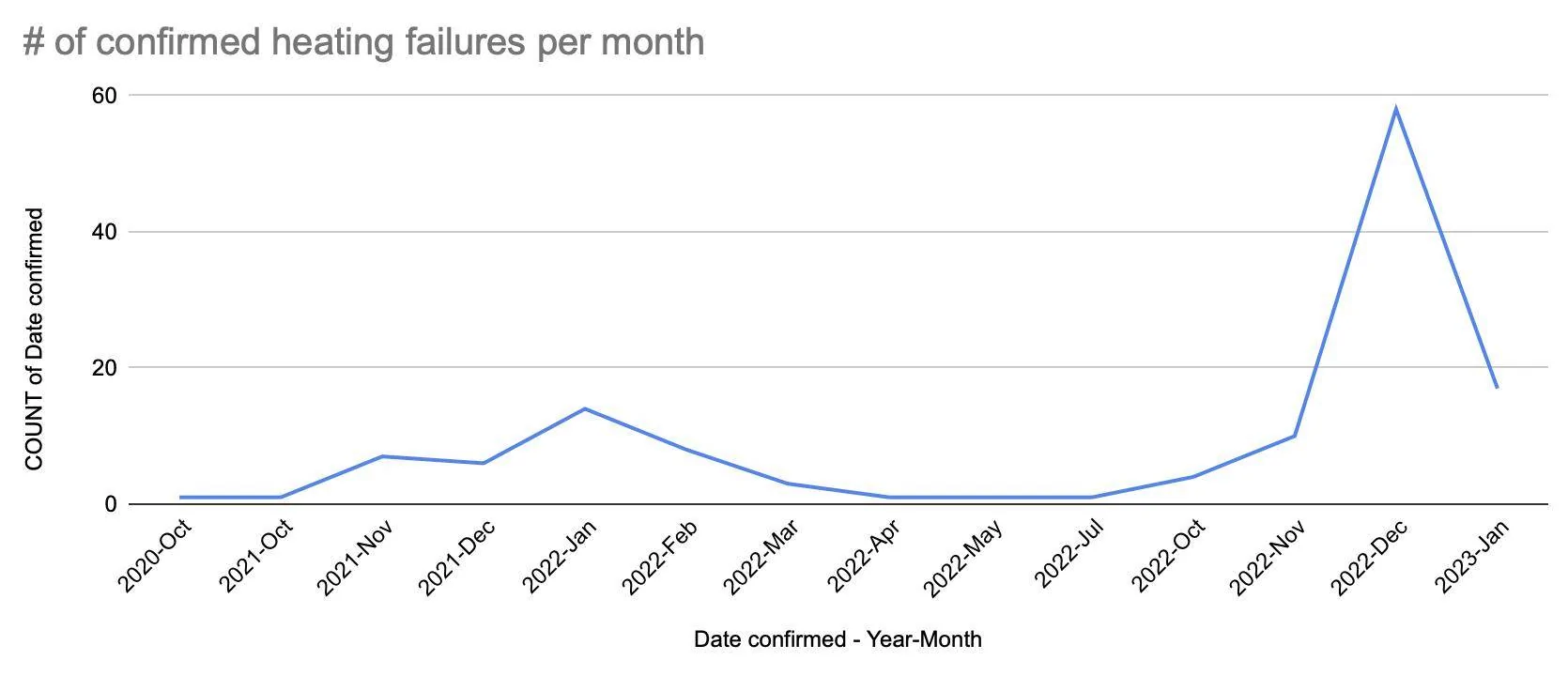

do you have # by country? We could compare that with country sales nbrs (even by Y) tomcone up with a % (i.e. US Y21, 300 units sold, 30% reported, so at least 30%)
or we could look at reported via forum / #forum users (by country) I’m really trying to get a feeling of realworld impact.

Could add country; will be based on profiles though so will be pretty spotty.
Maybe we should start a new thread where everyone can reply when they had the failure and when it was resolved? I think we are reporting in 4 or 5 different ones, I started this one in December after mine failed.
