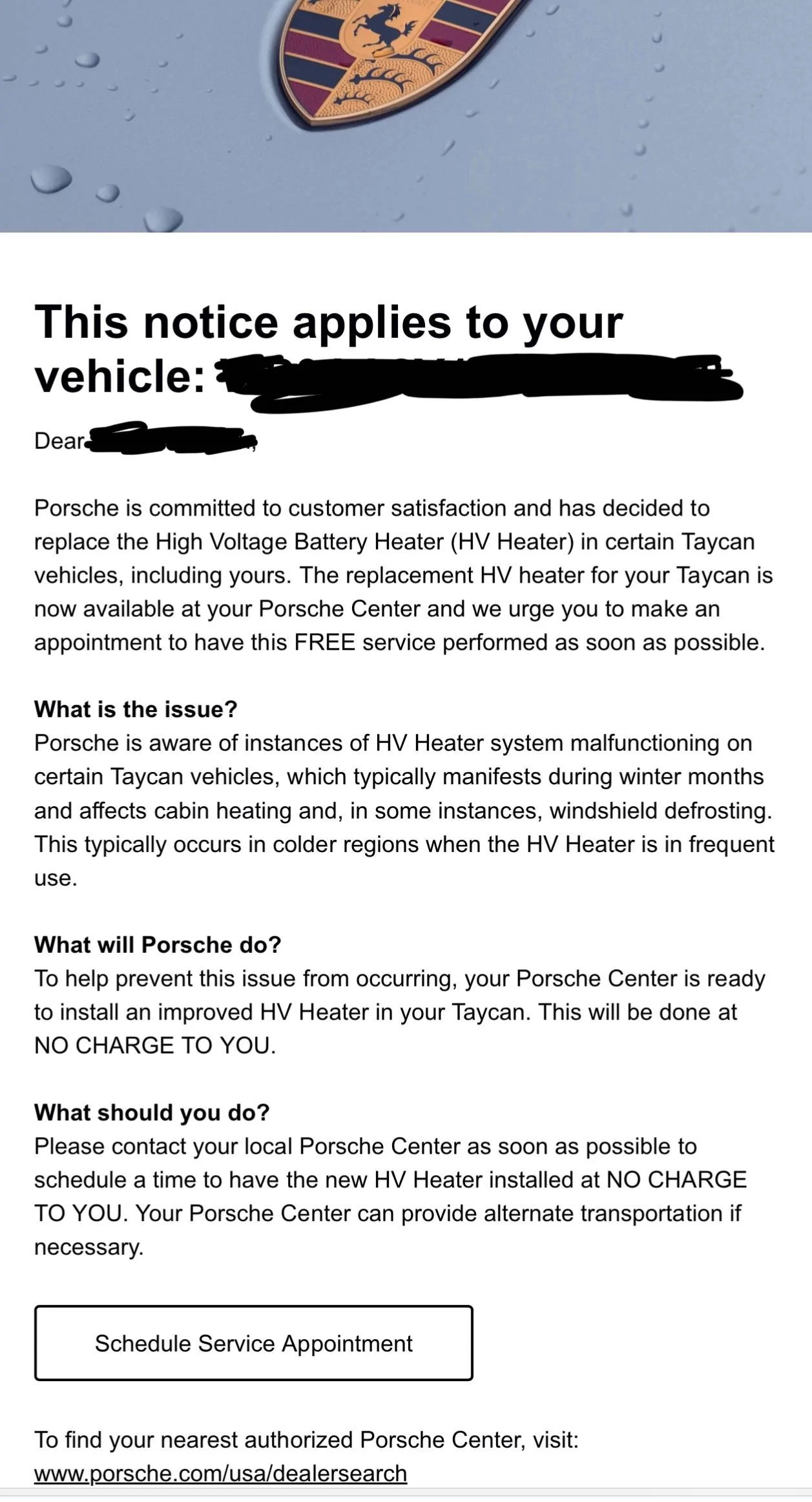

I received this today… Unfortunately my heater failed 2 weeks ago over the weekend and I had to bring it in the following week when a loaner was available. So mine failed before getting this notice.
Porsche Taycan Heater issues anyone? IMG_0398
