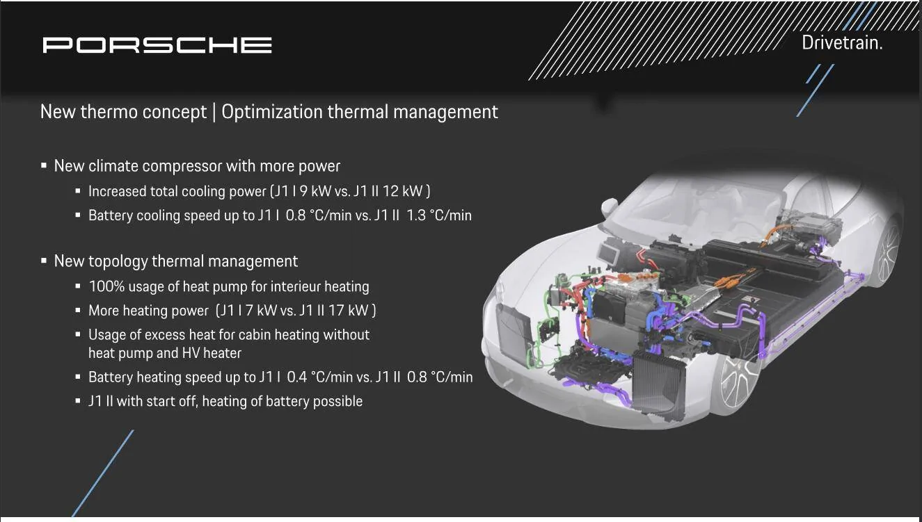

J1.2 seems to have a stronger heatpump & different ECU coding.
You would think they would just deploy those on j1.1 also as replacement, seeing how often the old model fails...

No, much stronger heat pump and different ECU managing heating; can be seen in my previous post.
