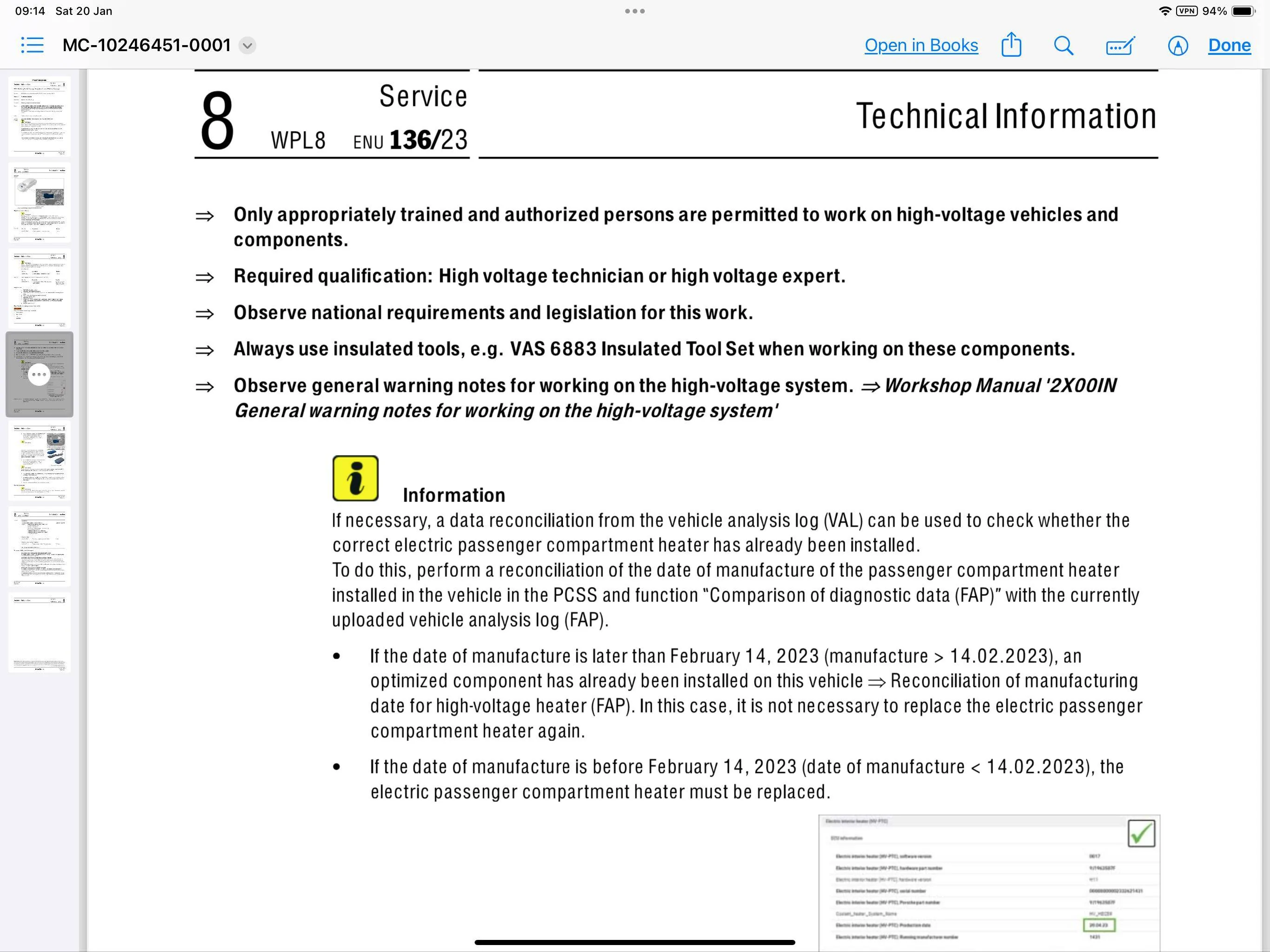

Registration in uk was end March 2023.
Still not clear if it’s date manufactured
I don't think your car delivered in UK late March 2023 would have the revised heater fitted.

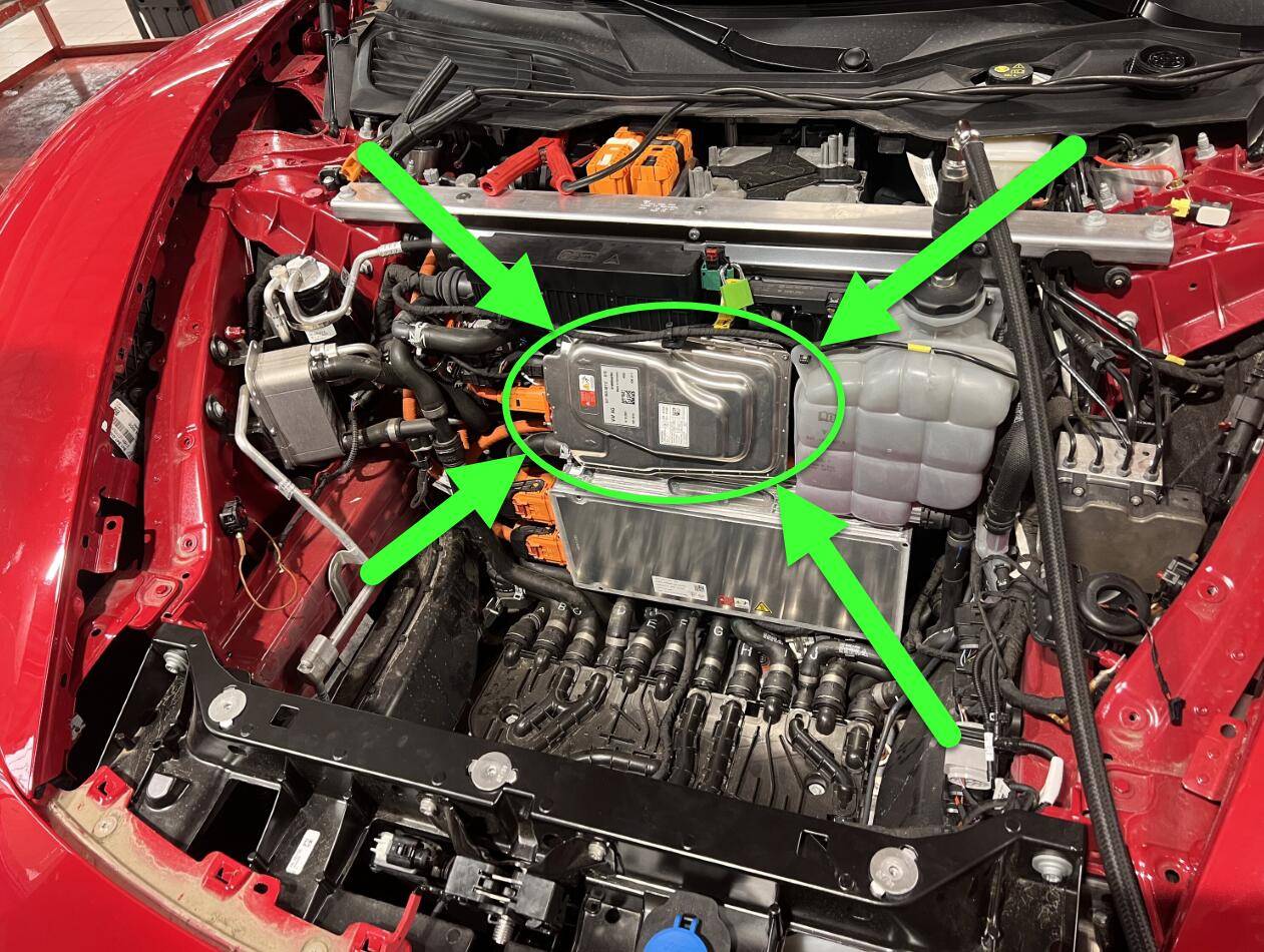

If you can be bothered, removing the front trunk liner, would expose the unit; the date stamp on the front of the heater.
Nicked a ready made pic from another thread ?
Porsche Taycan Heating and ventilation campaign. 1705773176757

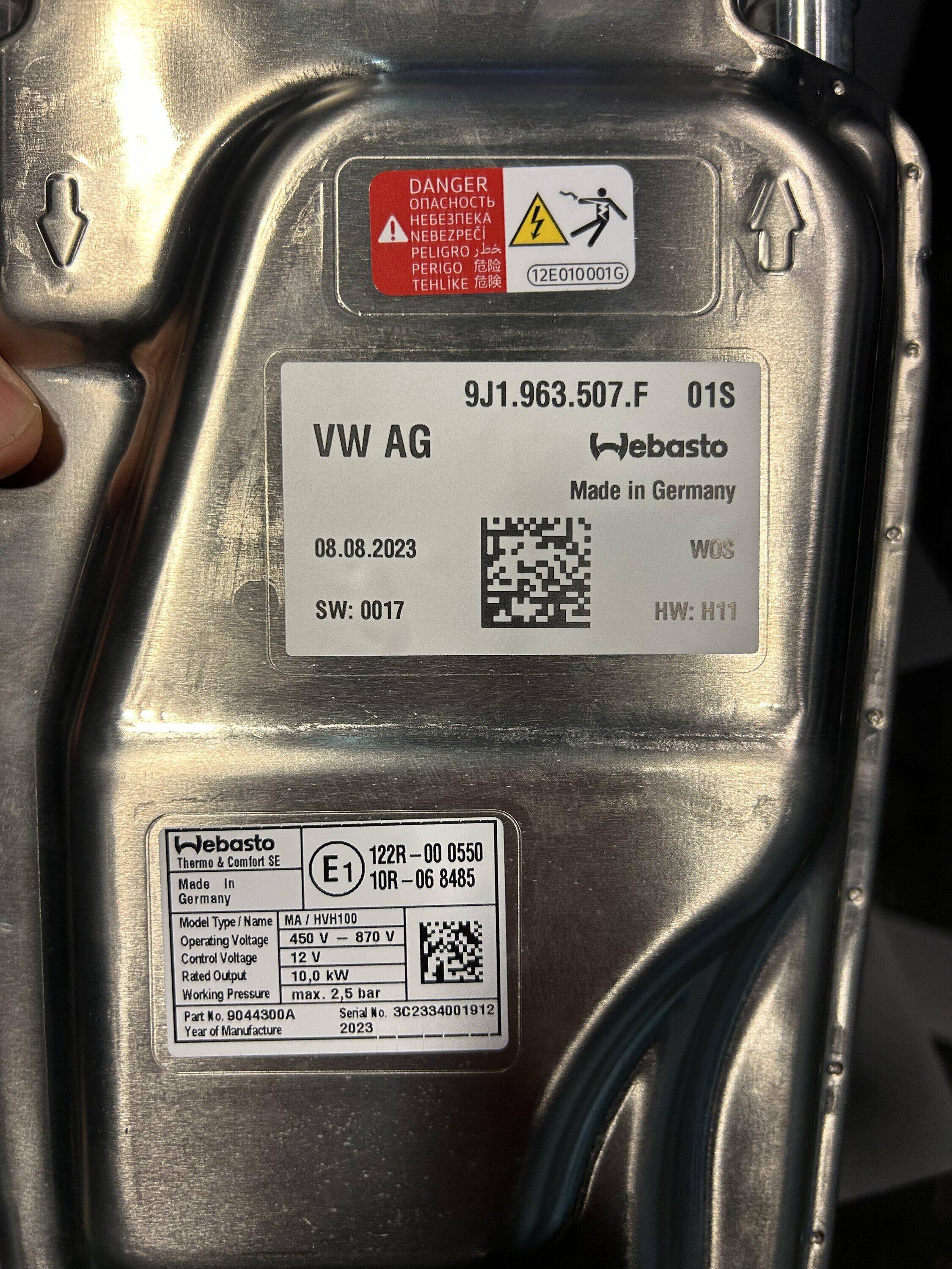

Stickers on the front ID the date of manuf. Also nicked pics from here.
New unit / post refresh / better soldering on the PCB:
Porsche Taycan Heating and ventilation campaign. 1705773334058
