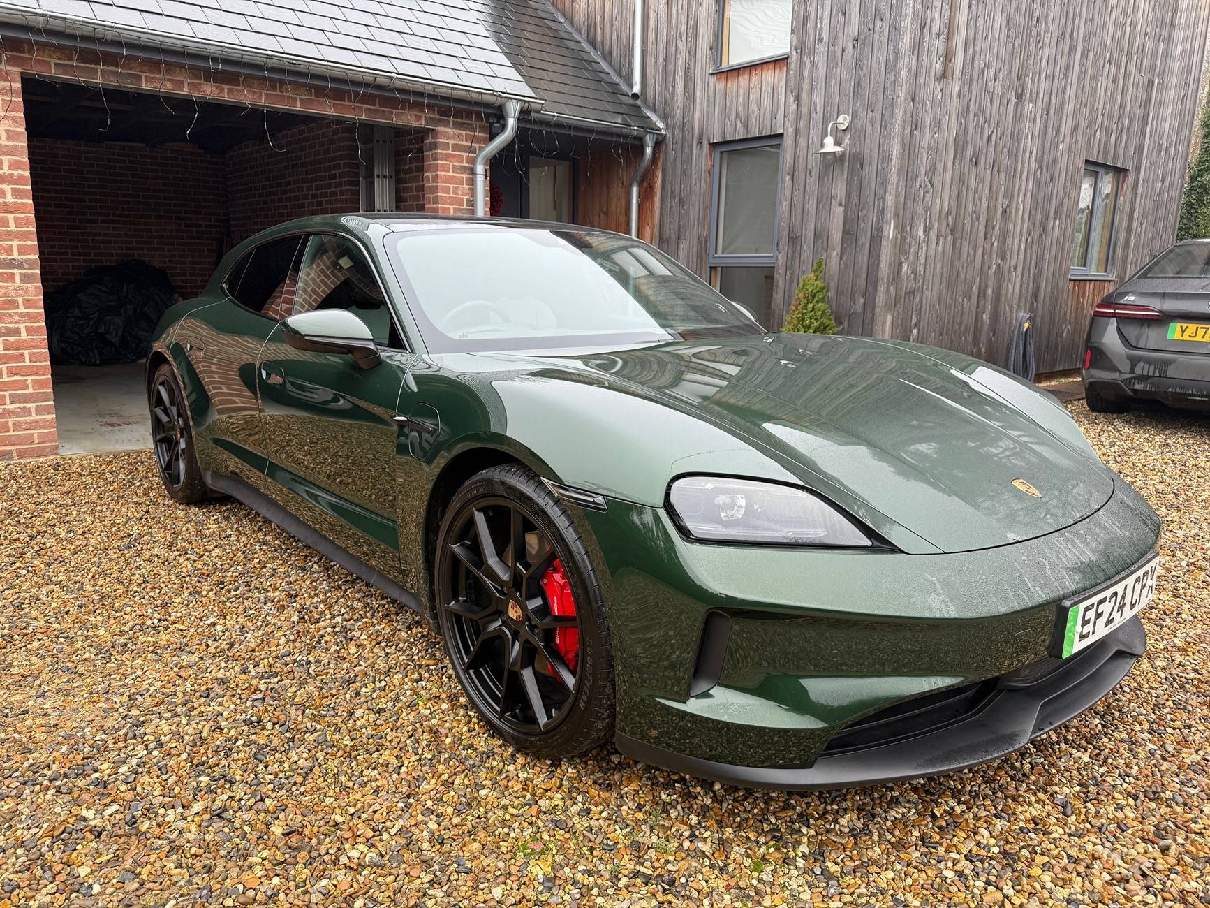

What is "broken" on yours?
As I read it the J1.2 on the pictures is a loaner while the 1.1 is at the workshop.

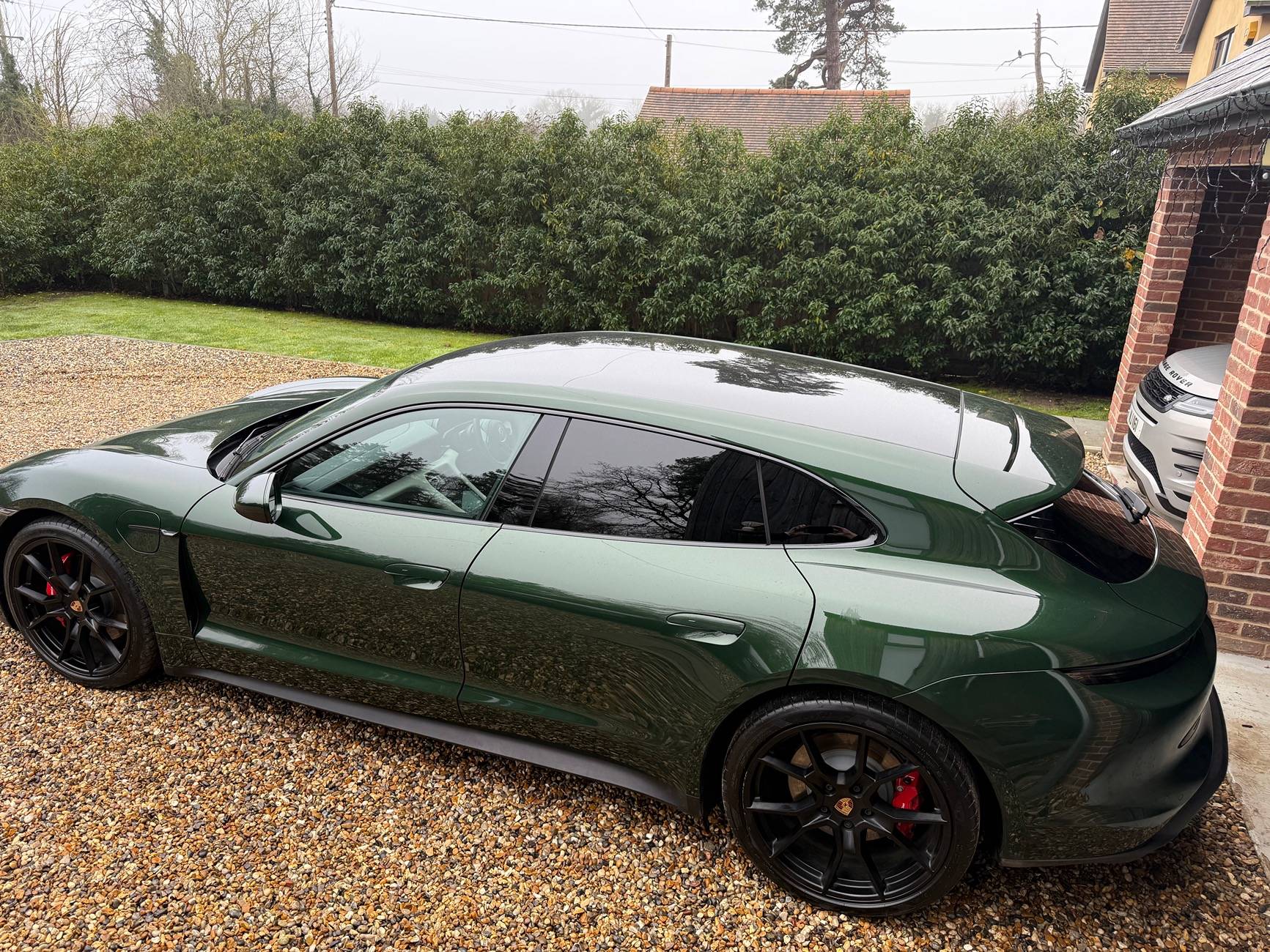

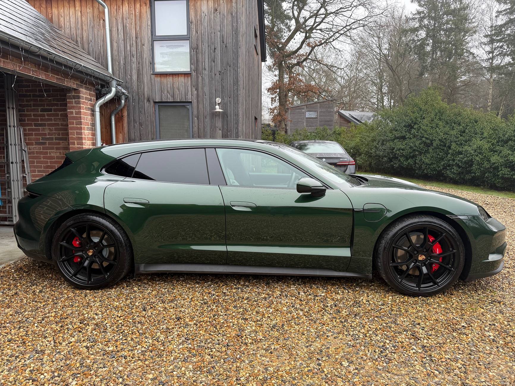

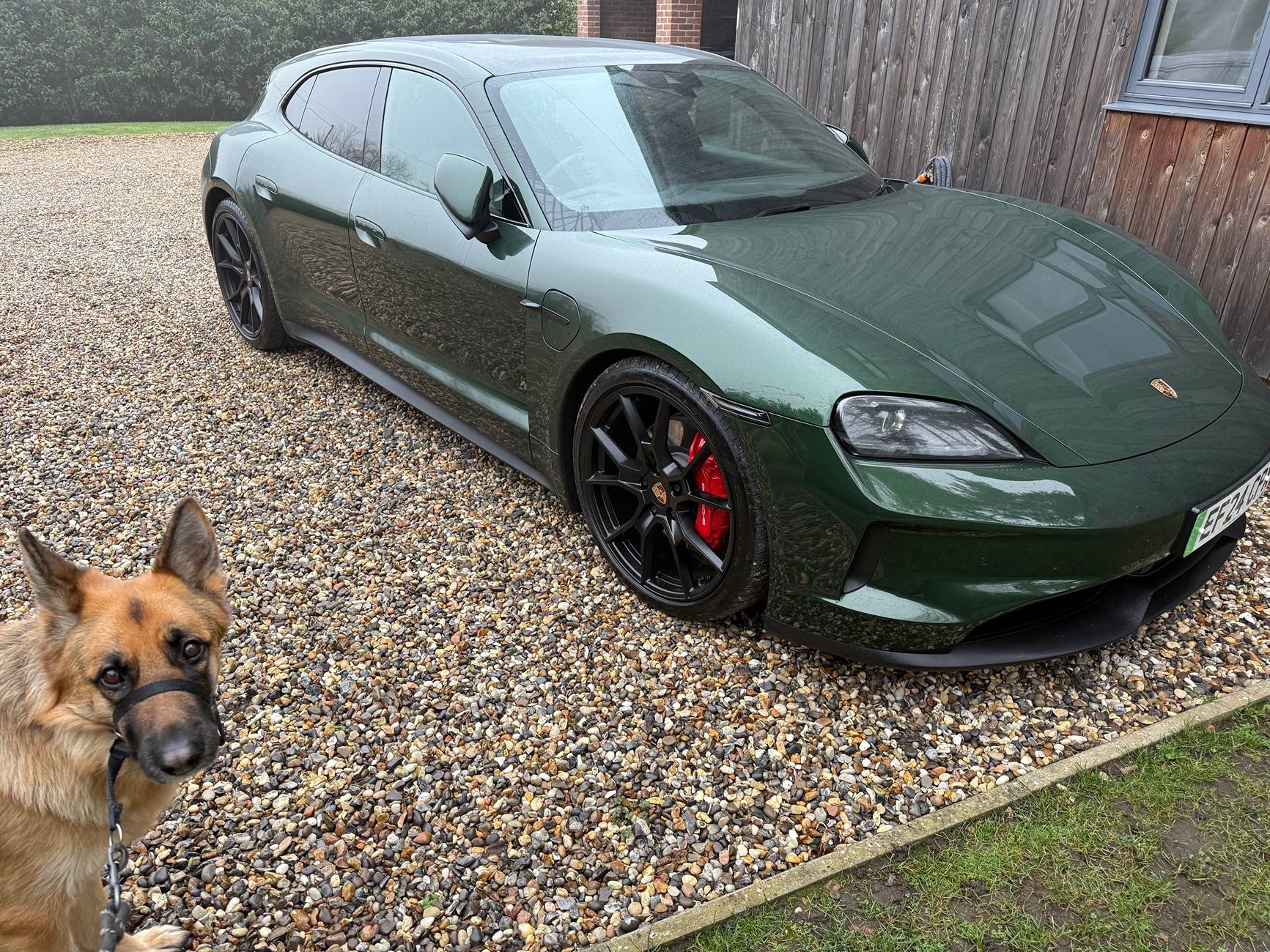

What spec is the loaner, out of interest....
Not sure on entire spec, and a bit of a mixed bag. Oak green neo paint, GTS wheels, powered charging flaps ( must admit I would now spec these) standard red brakes ( nit as good as my PSCBs, but better in wet)pan roof ( again would spec this if doing again) interior standard in main but light coloured leather, 3rd seat rear, matrix headlights, red rear Porsche light and dynamic swoop feature ( do like this a lot but checked and £1200 option!) Bose ( so much better than base stereo!) however doesn’t have sports chrono which I miss, and no surround cameras either. It’s a 4s.
