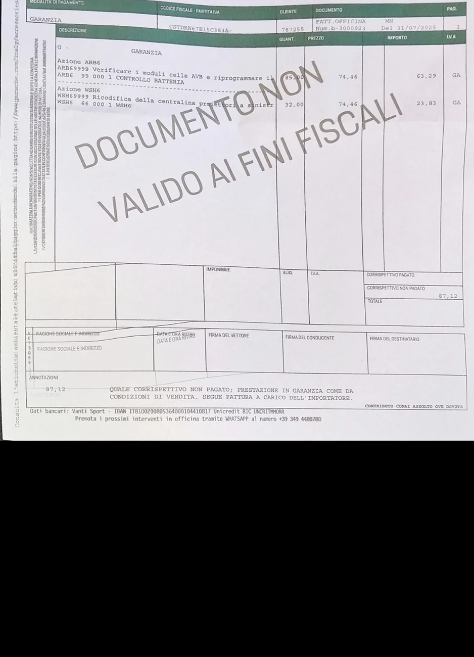

2022 Taycan Sport Turismo, Italy — no OTA updates received. Update performed at the dealership today during scheduled service, free of charge
Porsche Taycan WRS0 software available Screenshot_20250731_164634_Photos
