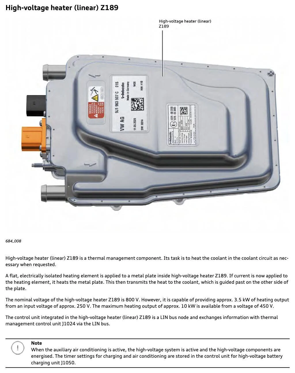

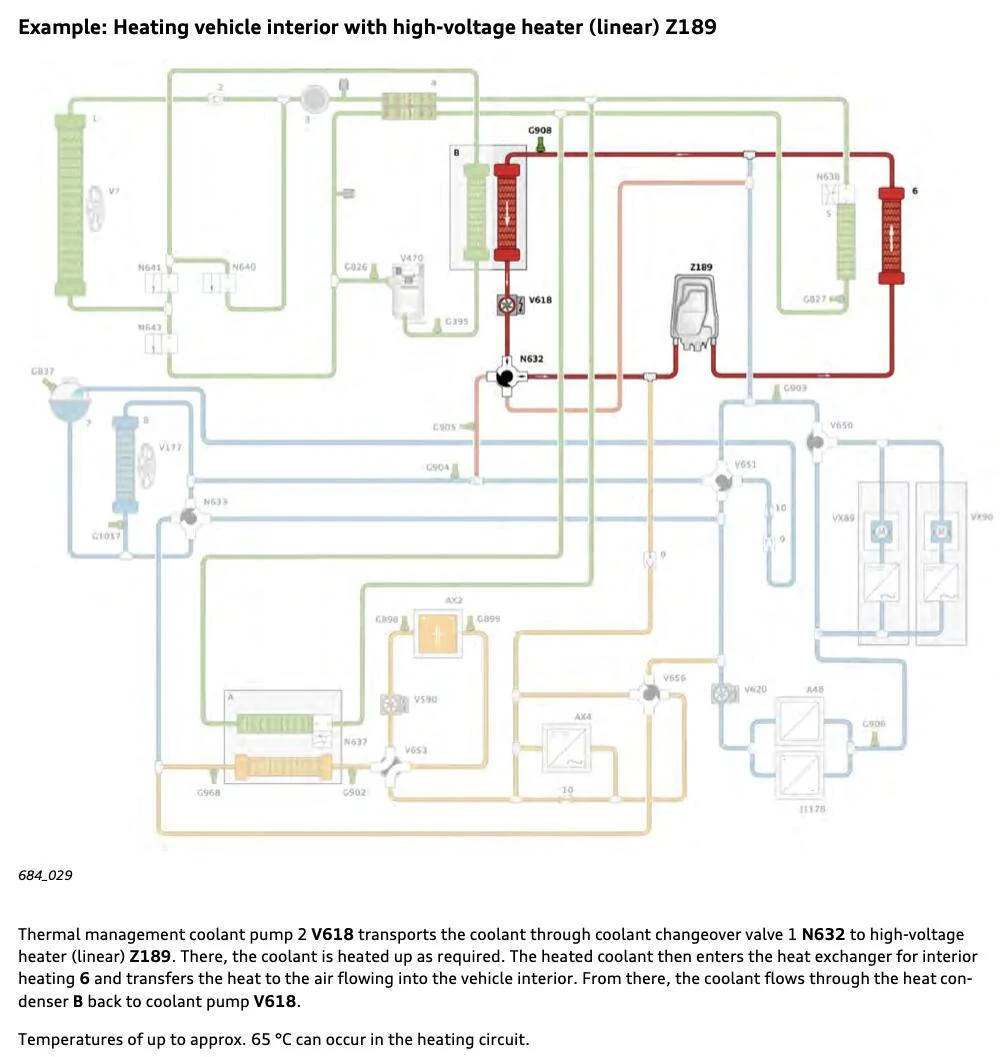

So about this failing heater issue that's seemingly widespread... is this just the HVAC cabin heating that fails or is the heat pump for the optimization of HV battery temps for charging that also fails, or are they one the same heating system? Or are they 2 separate heating system issues that people are having problems with?
Part of the same setup....extract below from Audi e-tron docs:

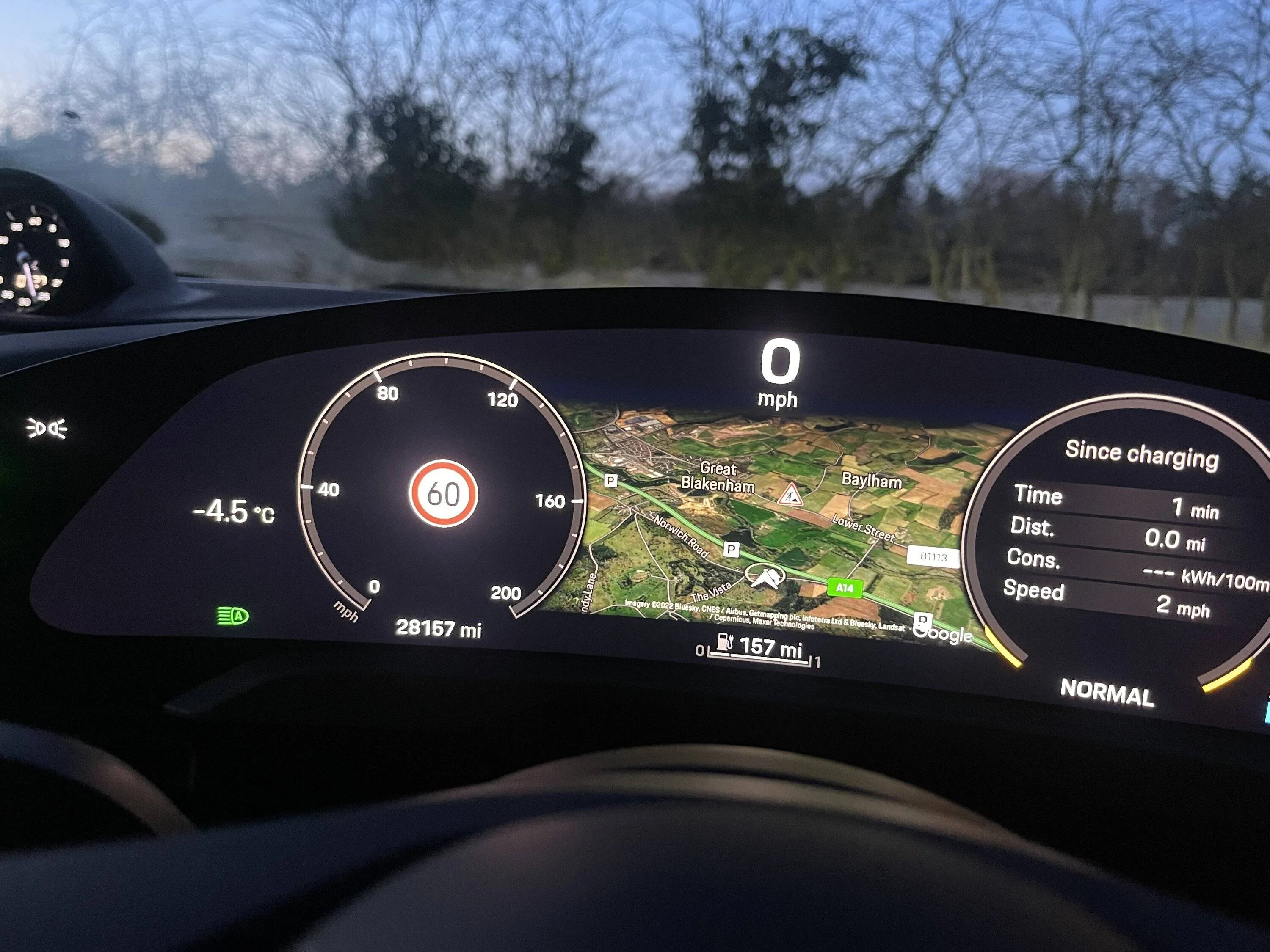

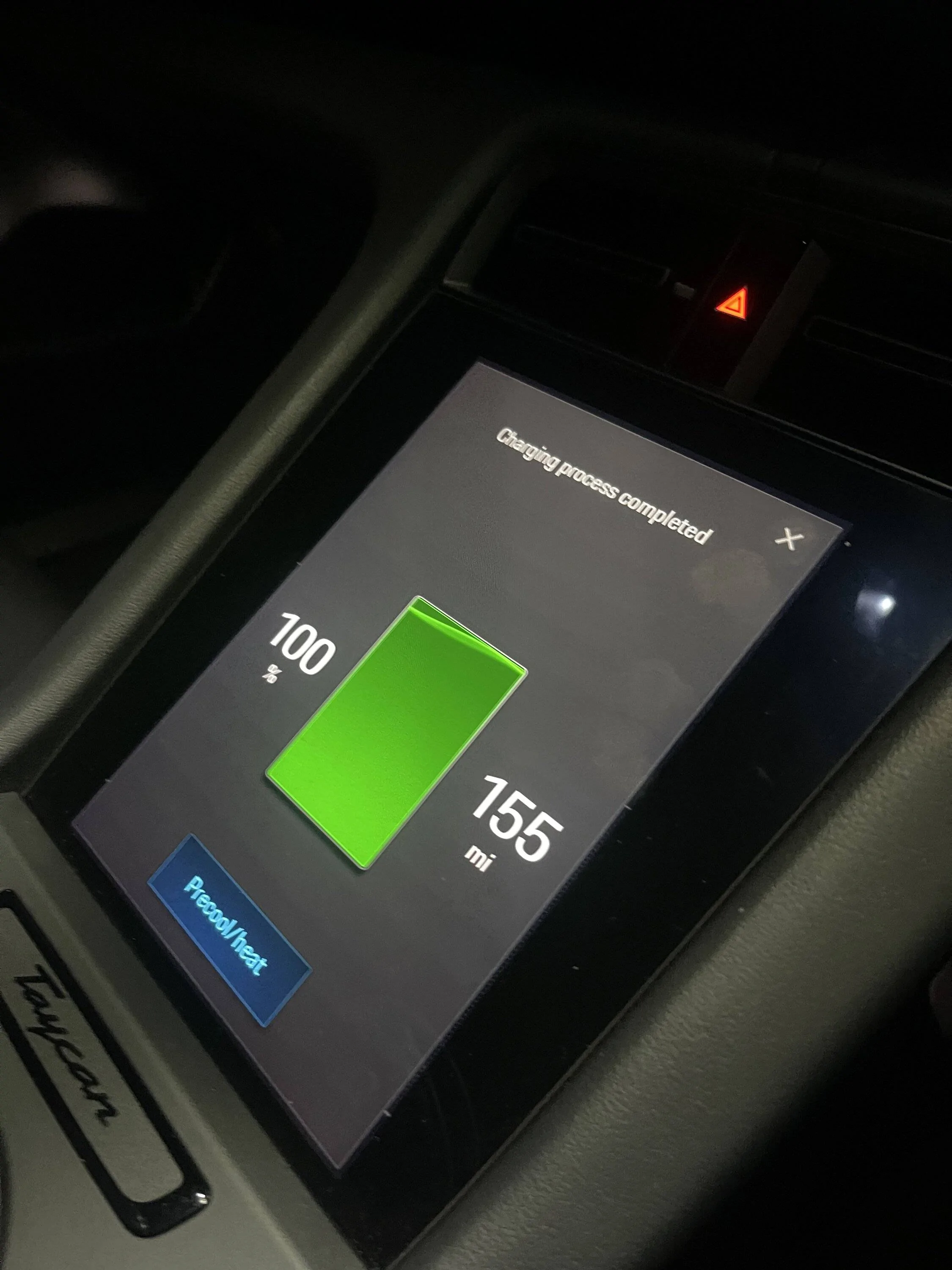

Well trip completed. No real drama but toes very cold! Heated seat worked well, and screen didn’t mist up but probably as so bloody cold in car!
Thought I might see an upside on range but nothing noticeable. 155 mile round trip and had 10% left, so a little better than first predicted ( small battery) but I was driving in range which is unusual for me.
Hire car being delivered tomorrow but I’ll keep the Taycan and drop off when they’ve confirmed part has arrived.
