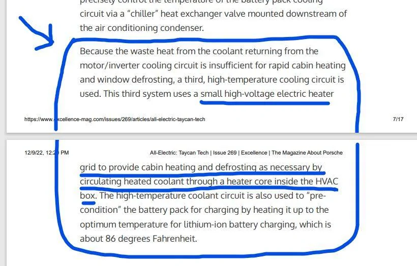

The heater that is being replaced in Taycans is a high-voltage electric heater that heats coolant for the passenger cabin, windshield defrosting, defogging, and cabin preheating. Picture of it and description are below.
Porsche Taycan Heating Failure 1671144335887
Porsche Taycan Heating Failure 1671144413715
Also, see attachment.
thanks for sharing this! however, I didn't quite understand how the HV heater, described as a third system, can fail the entire heating system once it's broken, but according to the mechanics at my dealer, it's a QC issue of the HV heaters which Porsche should have done better.

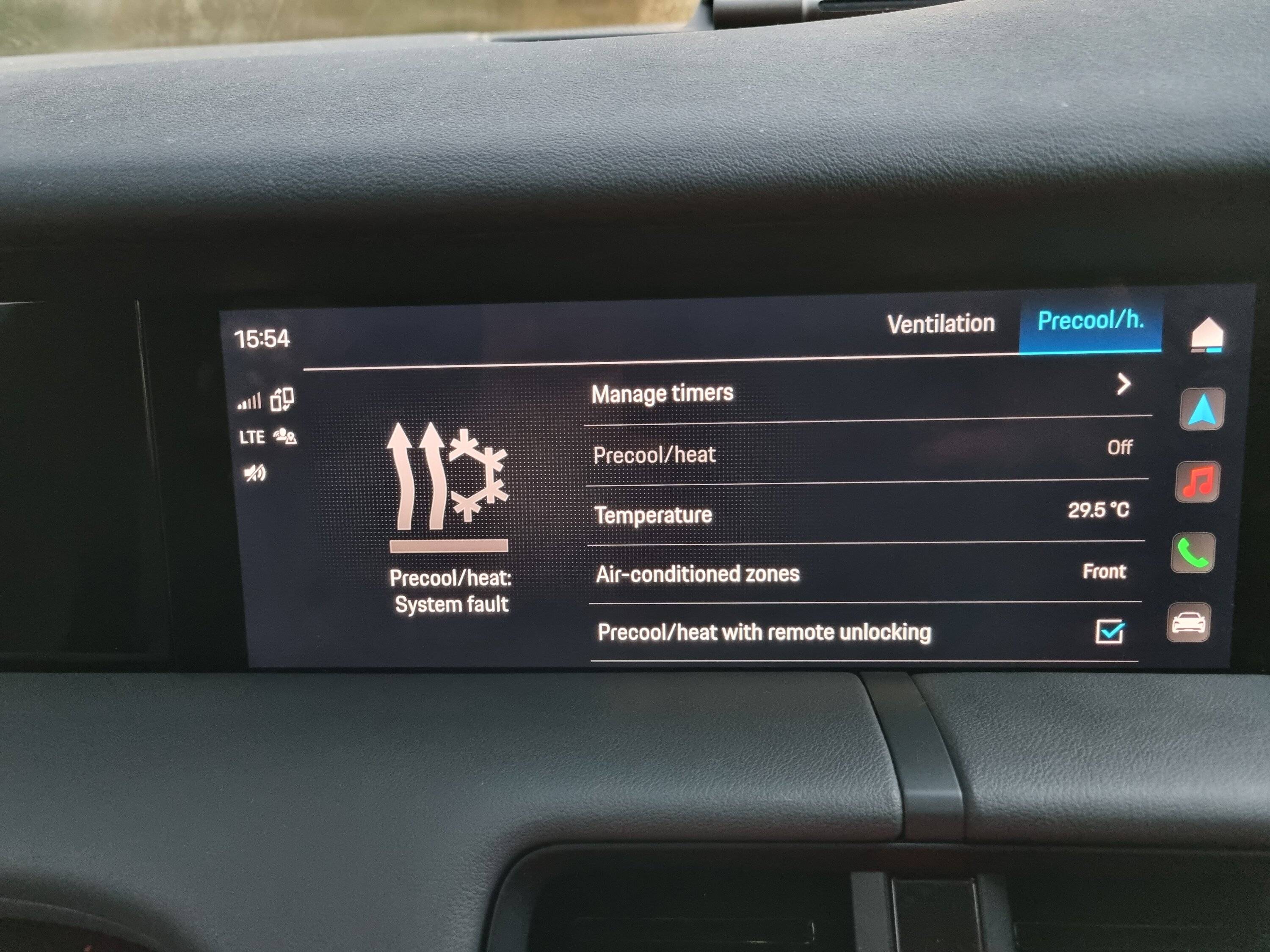

Bugger - my heater has just failed. Feels like it just a matter of time. Interesting my Range Rover Sport PHEV had a similar issue with its high voltage heater. Maybe most heating elements are designed around 240v and not 400/800v
Porsche Taycan Heating Failure 20221217_155407
