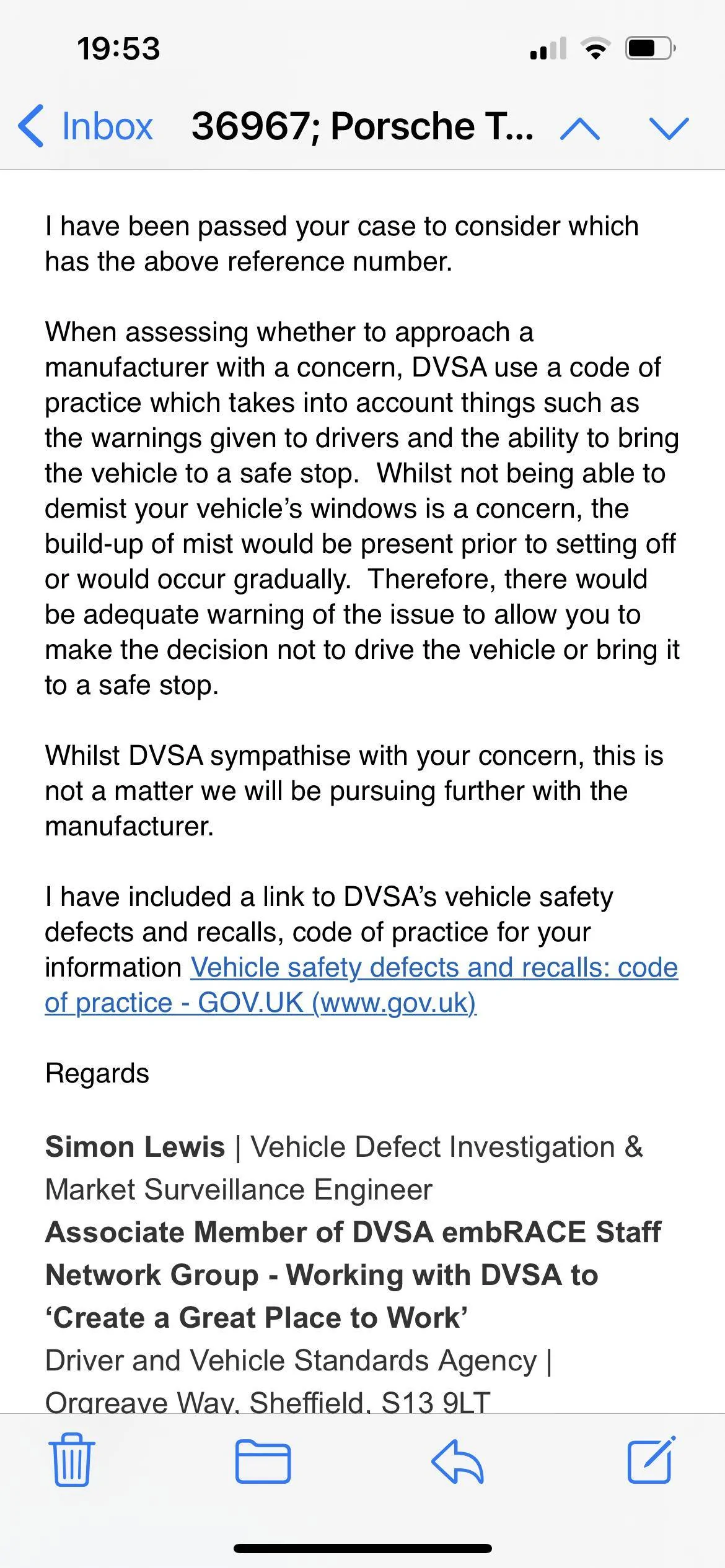

Make sure you cost them and get it recover as it won’t demist screen
I have already spoken to the dealer and will get Porsche Assist out sometime next week.
Car is at home, can use wife's.
Dealer knew as soon as I started talking what the problem was. They used their last replacement heater today unfortunately. More on order.
I will also fill in the DVLA form.
