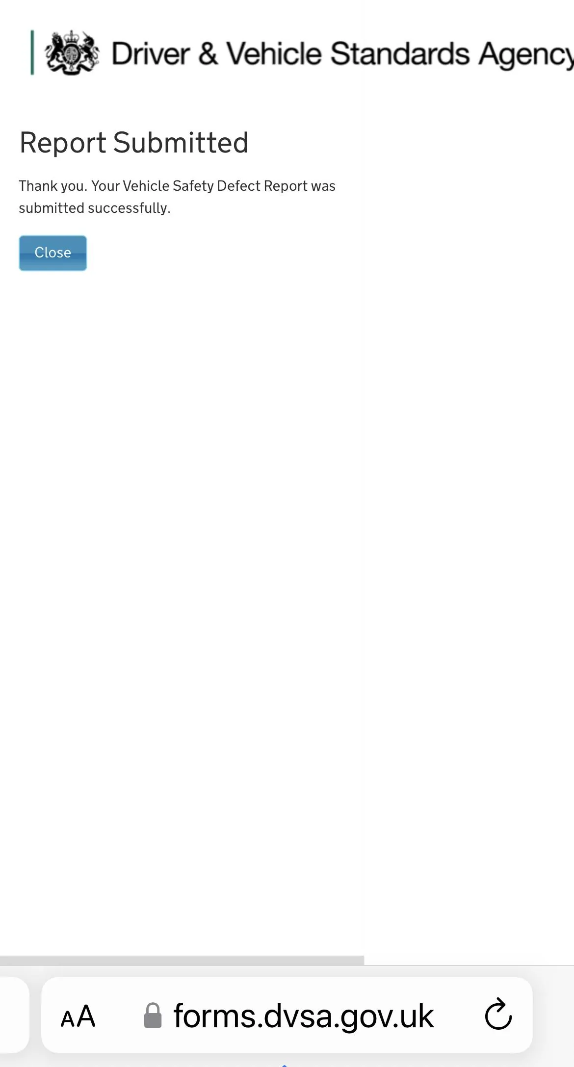

Broken heater eliminates windshield defrosting and defogging.
Serious safety defect.
Report it in UK per post #13 above.
(So far in US only 3 safety complaints to NHTSA).
