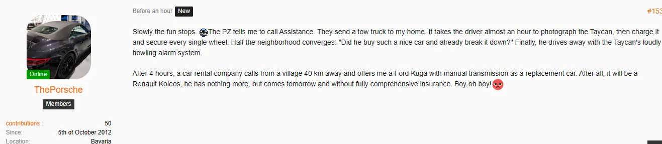

No heating in Taycan produced 06/22 with neighborhood comments:
Porsche Taycan Heating Failure 1673289997004
