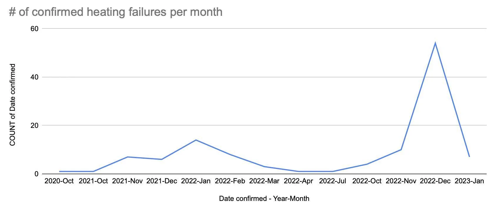

Those who have had it fail, do you run a charging timer? If so, is it set for daily departure.

When will Porsche finally issue a recall??
I hope they do issue a recall eventually if every car has a potential early failure but they would be totally mad to do it at the moment when they don't even have enough parts and personnel to fix the ones that have broken already.
766
4,598
3,729
And since a 2023 assembled on Nov 6 already had its heater fail, before a recall Porsche needs to figure out the root cause of the heating failure. Not clear that has occurred.
