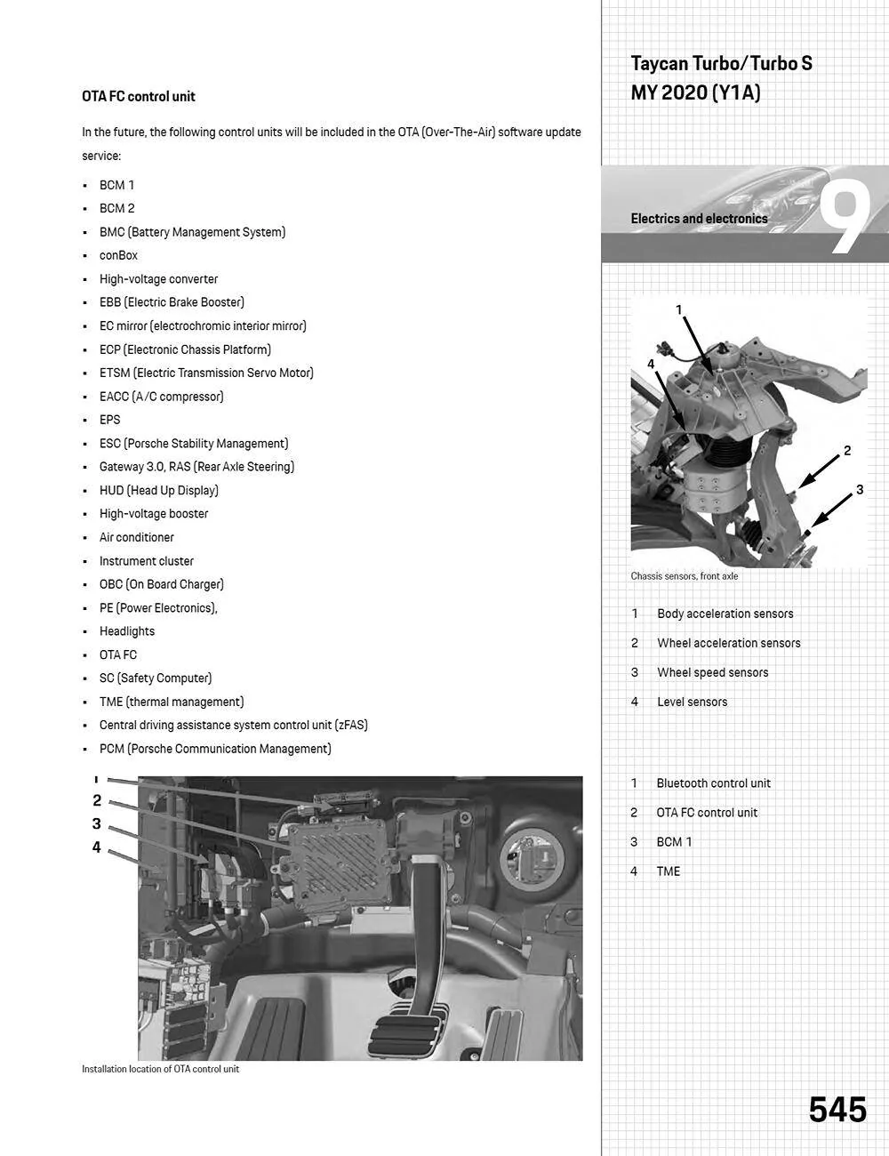

Porsche claimed Taycan had it too, so I will believe Macan has it only after they manage to do a major firmware upgrade via OTA (which never happened for the Taycan OTA).
Here is what Porsche said about the Taycan in 2019 (and yes, all 2020 Taycans already had this OTA module present). Notice that BMS (BMC) is on the list of modules it was supposed to be able to update.

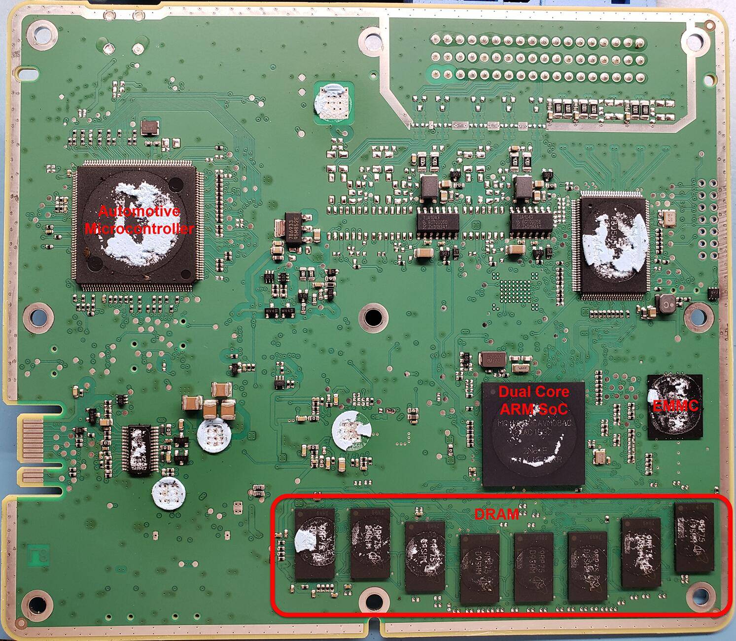

I worked on automotive OTA. If done right, it looks simple, like your your Apple or Google device update. However, system level OTA is a very complex topic, including things like you mentioned like ability to roll back if something fails. There is also security in the mix (which sometimes prevents rollbacks), and of course safety (you don't want a computer being updated suddenly open your trunk or windows by accident (or worse, apply full power to the motors). I suspect OTA was an afterthought for Porsche, they threw in some hardware the assumed they can just hire some interns to do the software for it. OTA and power management are often afterthoughts because it's not something project management has much clue about, but it seems like can be done quickly and easily.
PS> Porsche has dedicated, decently powered dual core ARM SoC in the OTA module, and another automotive microcontroller to go with it. Basically an equivalent of a tablet, just without a screen, but with lots of connections to various onboard buses. Here is what the OTA module looks like inside:

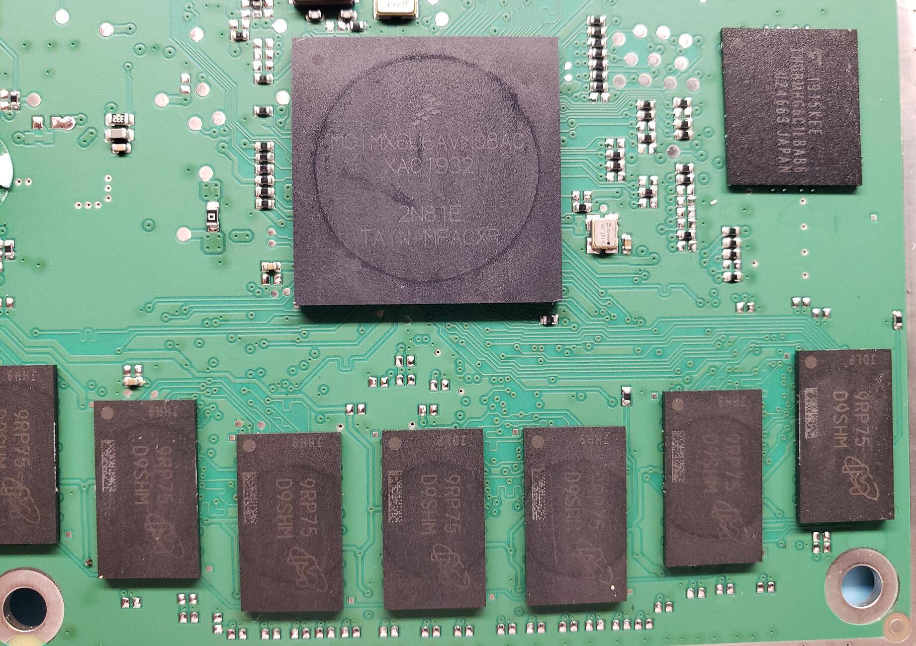

Sorry, for some reason I didn't take pictures of the whole board after I cleaned up the thermal goo, but here is the cleaned up SoC+EMMC+RAM (in case you were curious exactly what they used):
