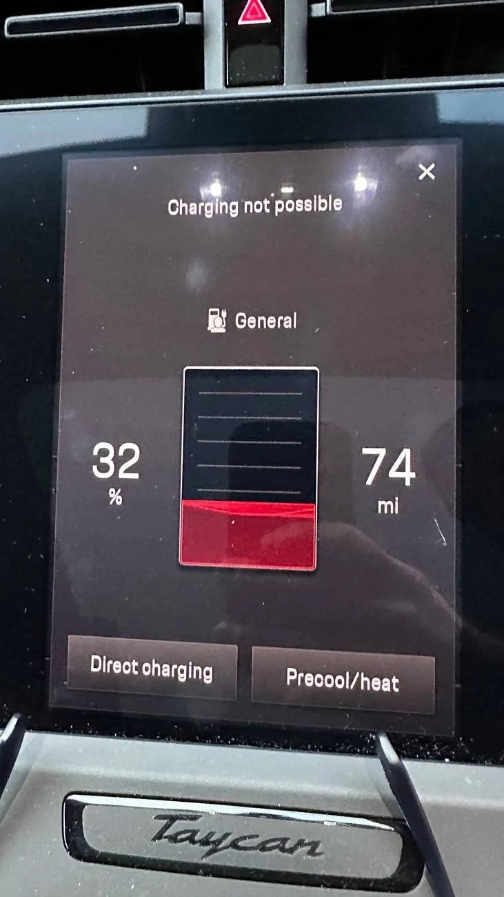

This sounds like exactly what it is, on board charger failed when trying to charge at DC, possibly when you get the initial very high blast of power.

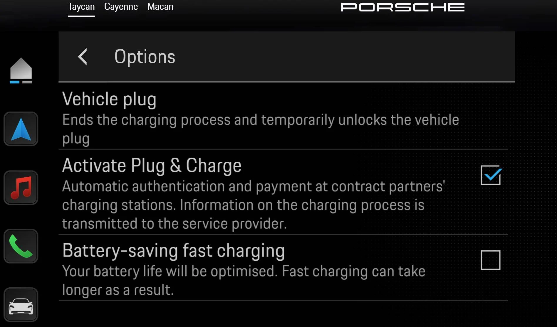

By any chance, is your "Battery-saving fast charging" checked or not:
I didn’t even know that was an option. I’ll have to check. It may be active since I have never charged above 180kw…

^ @Gino, please do not confuse AC and DC when attempting to rebalance your battery. The procedure specifically calling for AC charging as @Tooney is pointing out and ideally at a slower pace than usual, so I do it at 8kW vs. the usual 11kW. My last rebalance gave me almost 3% of SoH back.
Thanks, good information. The dealer wasn’t talking about balancing he just said it doesn’t matter if you are charging from below 5% to 80% or more using AC or DC charging. The onboard charger is designed to handle it. He said he has seen the on board chargers fail and he suspects that’s what happened since it won’t accept charge from either an AC or DC source even at the lowest current level.
All he could tell me is that it is not likely the HV battery itself is the cause of the charging system failure.
I guess I find out soon enough.

I do not think it has any relevance to the OP‘s sitauation. The car should charge just fine from 5% to 100% without any trouble at aDC charger.
It might not give any rebalance result at all , but it should not stop charging! Must be some faults now in the cars charging system .
Quoted for emphasis (in agreement).
It's not like any EV model has guidance to charge only via AC at first if you're run down the battery close to 0% SoC.
Do you have the 19.2kW (80A) upgraded charger? I know the ROW equivalent 22kW version has been known to be more unreliable design than the 11kW, so curious if we're seeing a wave of NA 19.2kW chargers fail (perhaps that is why it's no longer available in 2025 Taycans). Mine crapped out 2 weeks ago - similar symptoms - will not charge from AC or from DC. I didn't do anything special with the car, same sparse daily driving and AC charging for months. One day got into the car and realized that charging still says "Initializing" from the night before, after that is just said "charging not possible" to anything I plugged into it (AC both ports, DC). The car drove and used recuperative braking without any issues, so there was some indications it wasn't the battery. Took a week to get it diagnosed, turned out it is the onboard charger, parts ordered but holidays will only add time.
I think I have the 11kw…
