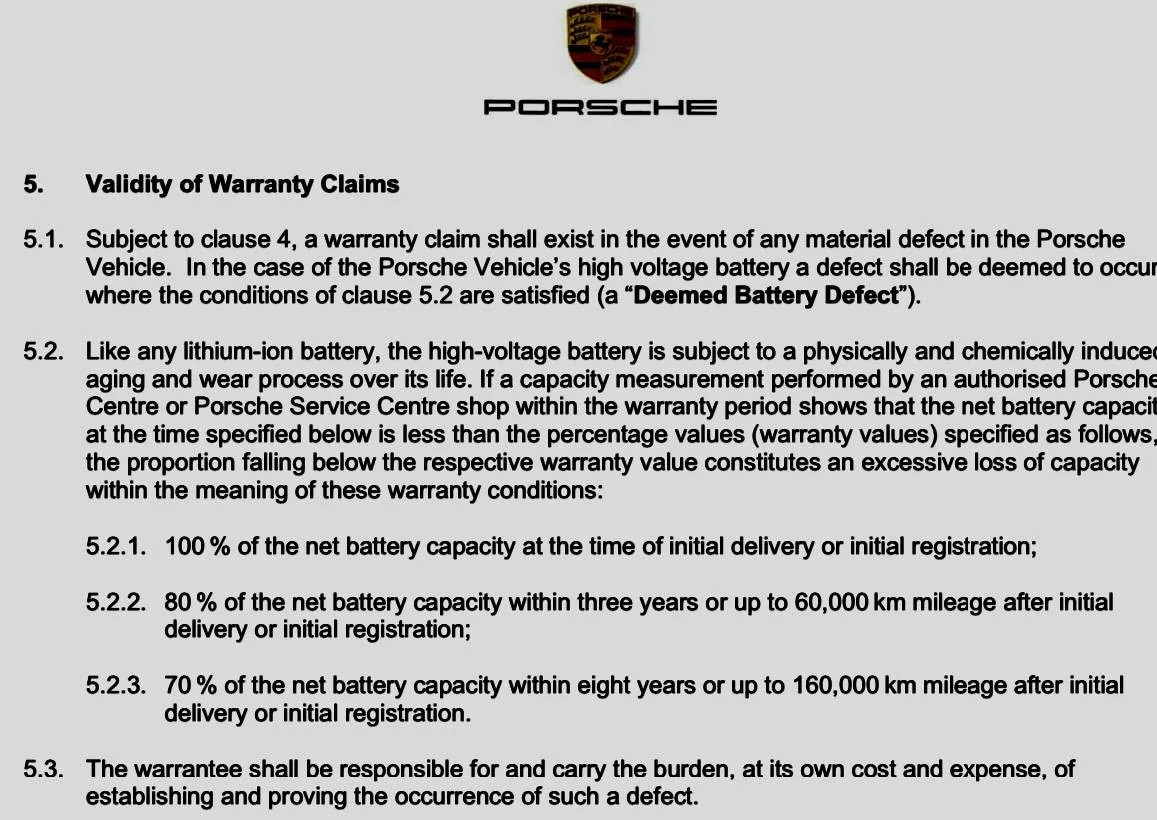

Would a 20% plus whatever actual loss of capacity qualify for warranty claim under Porsche's battery warranty? If so, demand a new battery under warranty, since the old one lost its capacity via a combination of Porsche restriction (20% instant loss) plus aging. If they need to give you a new Taycan with the new battery, I'm sure you wouldn't complain. ;)
The battery warranty is 80% at 3 years and 70% at 8 (happy to be corrected on the 8 yr figure). So it reasonable to argue that Porsche is complying with the battery warranty. Whether the car is of satisfactory quality, fit for the intended purpose, and ‘quiet possession’ is being denied are the likely legal points.
If Porsche has limited the battery capacity to 80%, then any aging would bring it beyond the capacity loss for 3 year threshold. Whether a hard limitation (no Taycan is really allowed to charge to 100% of every cell, software stops it at less) or a policy based limitation (a letter instructing you not to charge above 80%), it should be counted the same - it's a loss of capacity. Warranty protections should kick in for anyone with a <3 year old Taycan who Porsche instructed to limit their battery capacity. If not, what is the warranty for? Any battery manufacturer could just limit the battery capacity "for safety" and claim zero degradation until the end of battery warranty.

MY battery health is at 85% at 60.000km, according to OBDLink. This is bad by itself. With 80% charge limit it is much worse.
Here’s the battery warranty. For cars under 3 years old the manufacturers defect warranty should apply.
