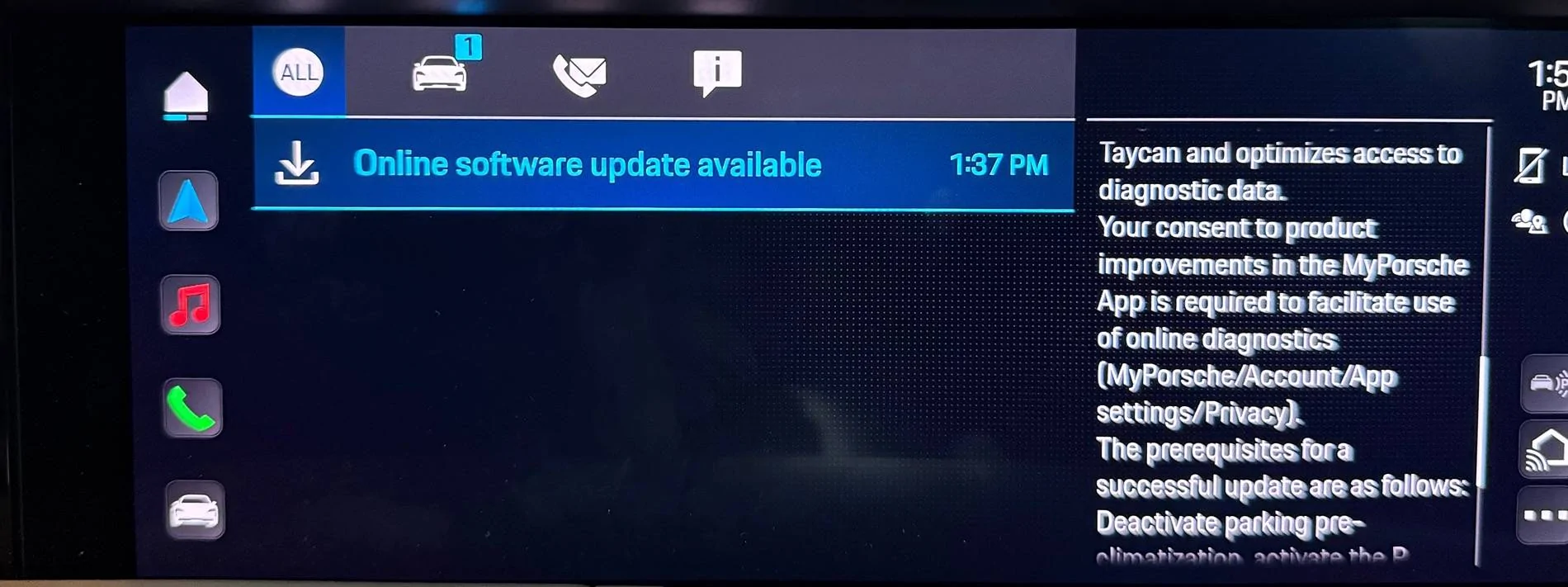

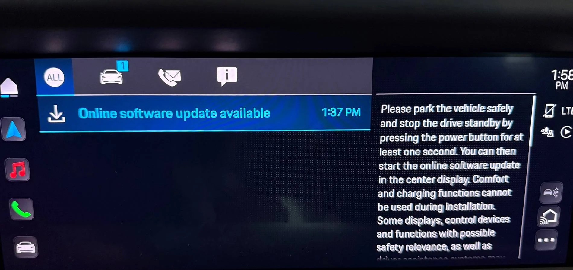

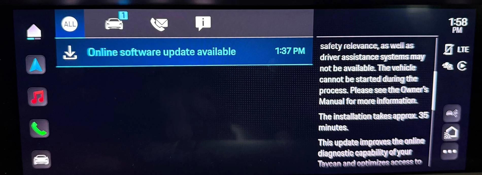

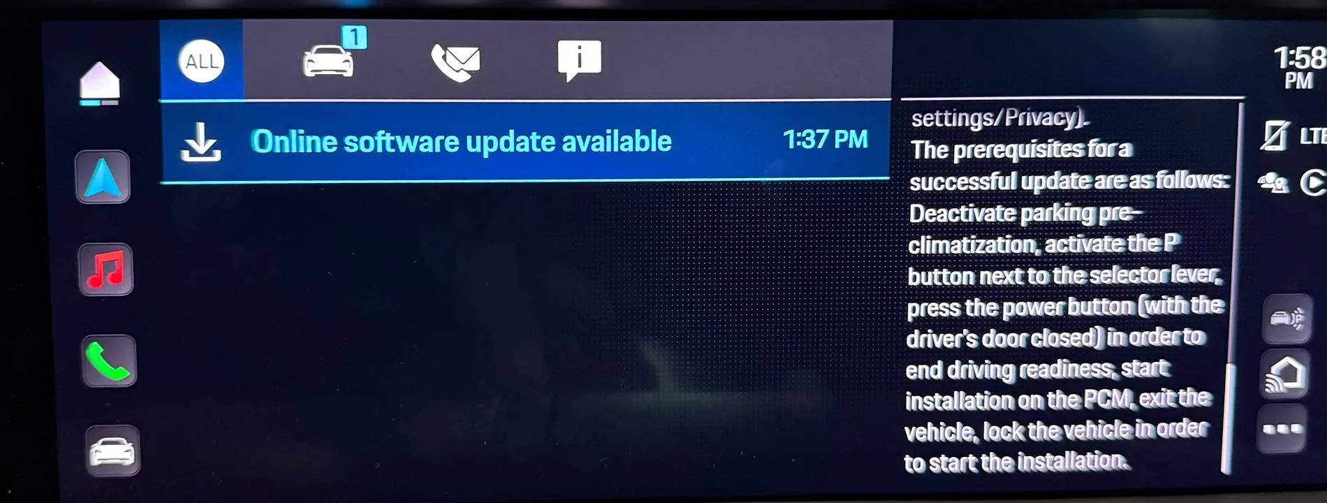

Today at 1:57 I was notified of an OTA update ready to install. Here are the details --
Porsche Taycan High Voltage Battery Recall EXPANDED - ARB6 & ARB7 IMG_5253
Porsche Taycan High Voltage Battery Recall EXPANDED - ARB6 & ARB7 IMG_5254
Porsche Taycan High Voltage Battery Recall EXPANDED - ARB6 & ARB7 IMG_5255
Porsche Taycan High Voltage Battery Recall EXPANDED - ARB6 & ARB7 IMG_5256

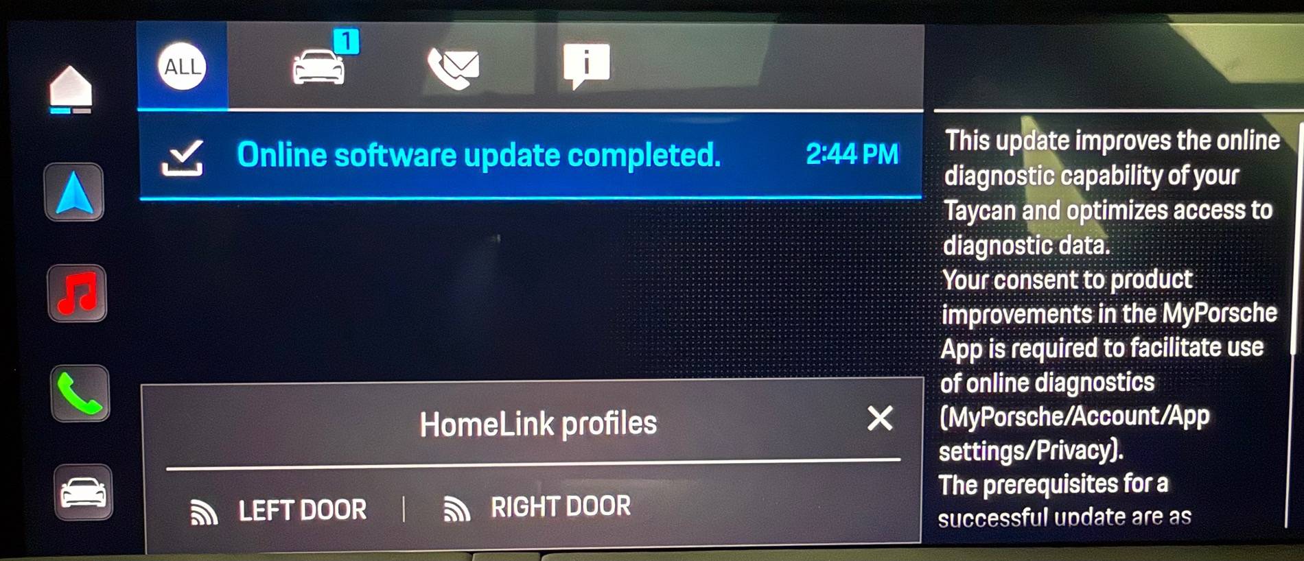

I waited the 35 minutes that was stated as the update time, went back to the car, and ...
Porsche Taycan High Voltage Battery Recall EXPANDED - ARB6 & ARB7 IMG_5263
So far I'm not noticing a lot of difference in the PCM, but for some reason it seems a bit snappier, and the My Porsche app seems a bit faster too.
Now wait and see if my battery is A-OK.
UPDATE
So after the update I noticed that I didn't get the usual "Goodbye" popup in the PCM when shutting the car down (long press on the Power button). Also, I couldn't see any current version numbers.
Two-Finger Reset was required, and now the PCM is back to normal. For the record, the following are the versions of various items --
  • Software Version - MPR3_US_POG46_K3882
  • PCM Software Version - 3882
Hope this helps.
One More Update
I don’t know if this is true for everyone, but my PCM seems a lot snappier for start up as well as connectionto CarPlay. I’d be interested in knowing what everyone else thinks.
