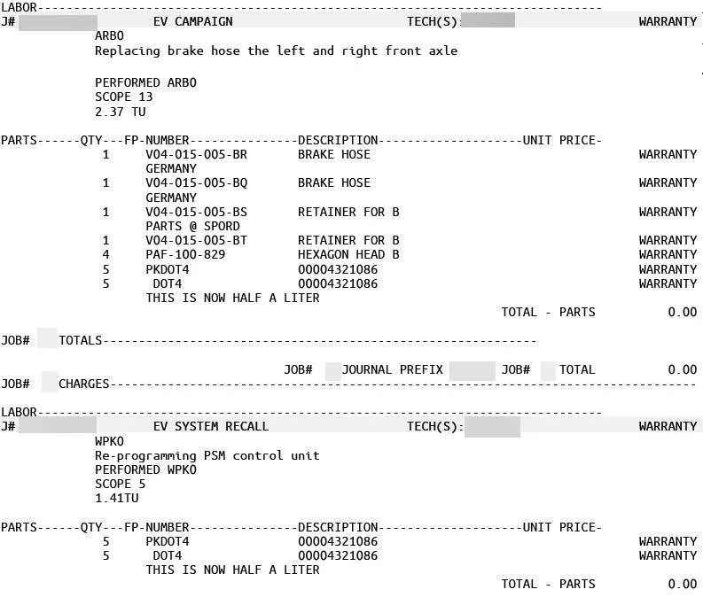

I did not watch mine, but here is what the billing looks like, separating parts and labor. Both ARB0 and WPK0 seems to have 5 of PKDOT and 5 DOT, which I assume is brake fluid. Not sure what "this is now half a liter" means. Also, anyone know how long is 1 TU (time unit)?

I believe 1/100 of an hour.
So 36 seconds? Extremely unlikely, as both ARB0 and WPK0 total billed time is 3.78TU, so that would mean they can do them both in under 2.3 minutes! Now that would be some world record efficiency! ;)
It's possible, and would make much more sense, if it is listed in hundreds.

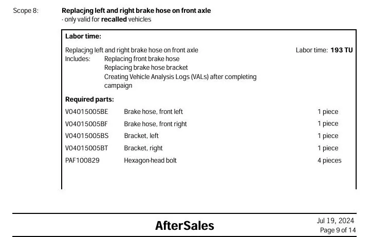

100 TU = 1 hour, from what I have read in lots of places.
Per TSB, replacing both brake hoses on front axle will allow slightly less than 2 hours labor to be charged for the work.
Maybe the tech who wrote @whitex report has a problem with decimals (or TU is more than 1/100 th hour..... ) or that tech is damn fast.
