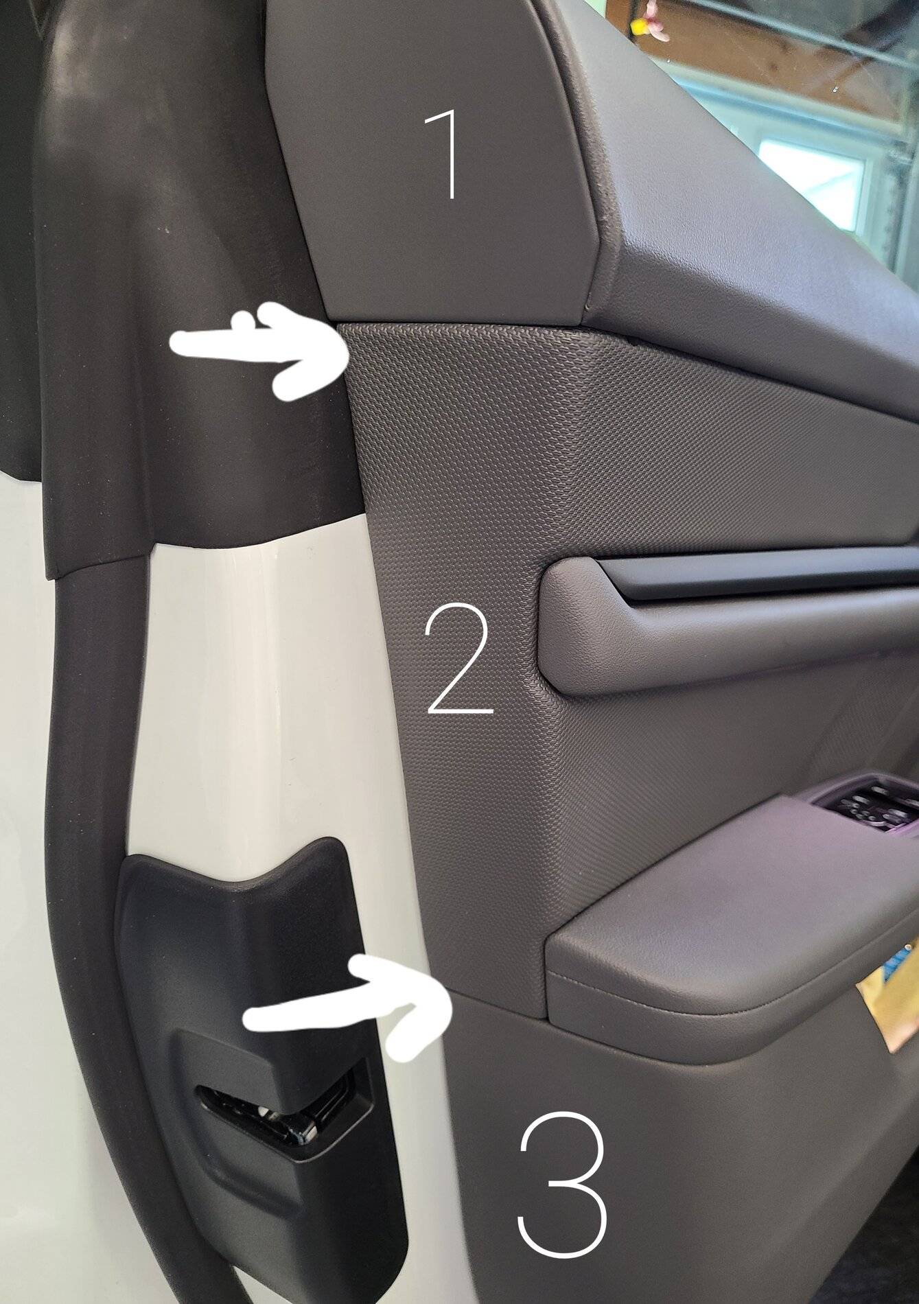

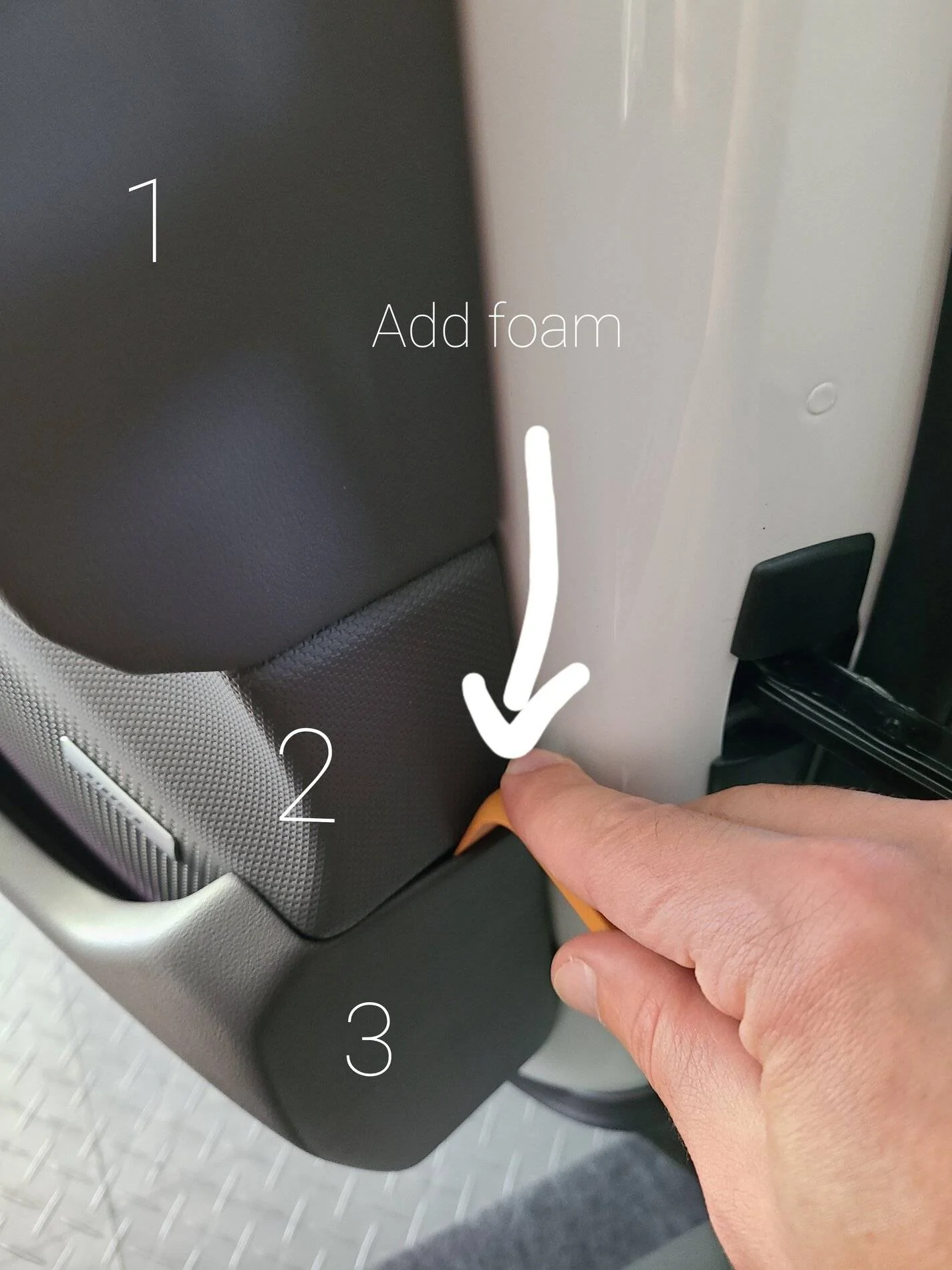

First read my post in the top of this thread. It should fix 90% of the rattles.
If you have minor rattles left keep reading. I removed the door panel to examine what is causing the rattles. The panel is flimsy like a card board. The panel is not one piece, it is three pieces attached together. See photo to identify the 3 pieces. Because the construction is flimsy the three parts move and flex independently and their joins rattle and squeak. Per original post, adding foam between the door chasis and the panel minimizes the movement and fixes the rattles. In addition you can add rigid foam in the joins of the 3 parts. In my case that helped resolve the remaining 10%.

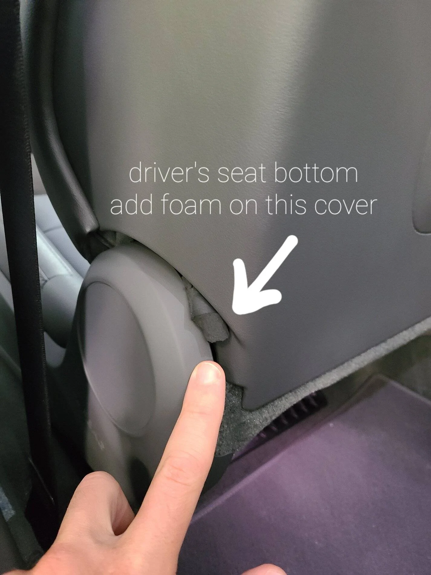

I also found a cover on the bottom part of the driver's seat to have some play and rattle a bit and I added foam there too. See photo.

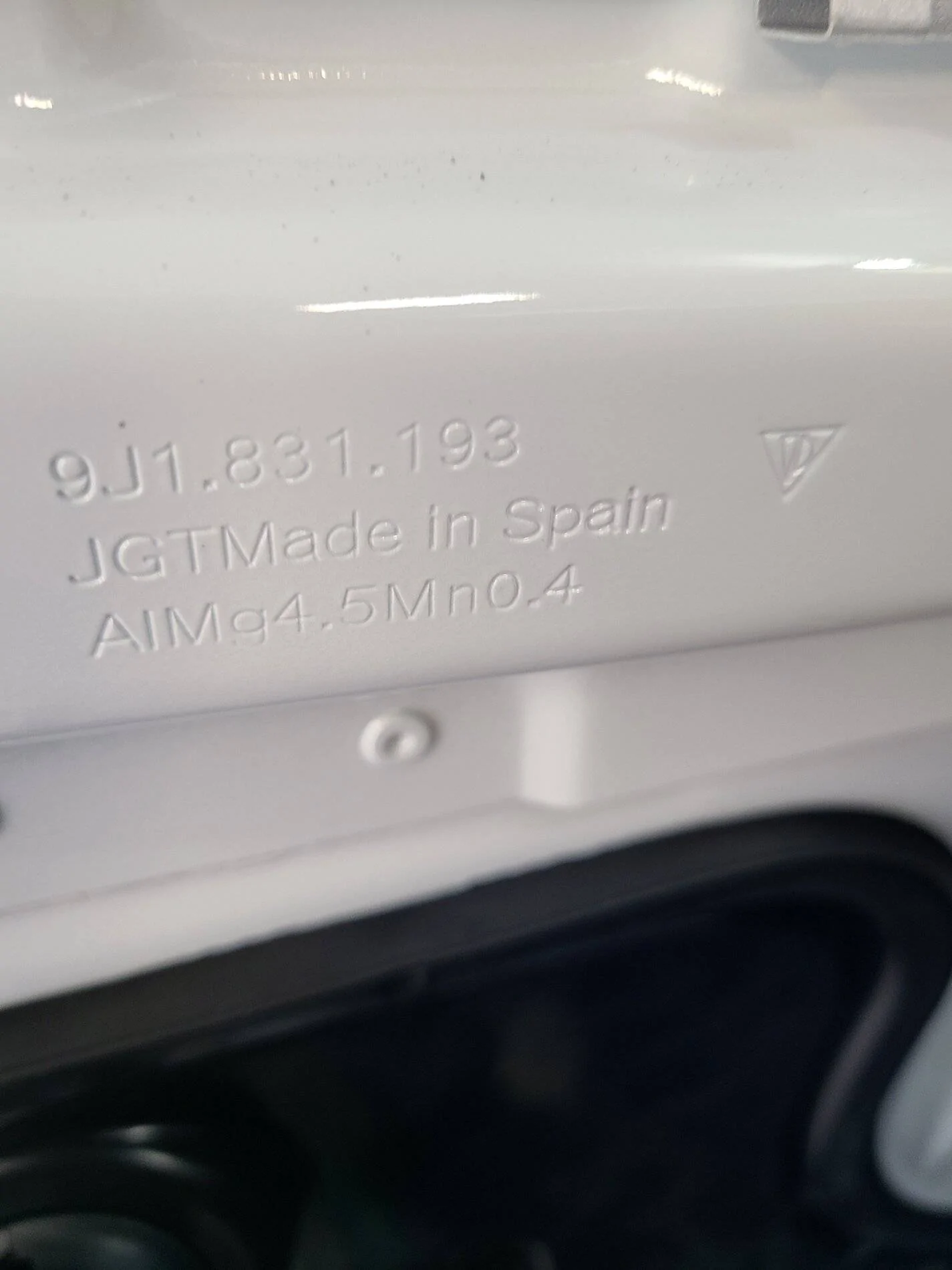

Last but not least, I did not see any part of the door to be made in Germany. The door chassis was made in Spain, some plastics in Austria. I bought a Porsche Taycan, not a SEAT Leon, but yeah they are all in VW group.

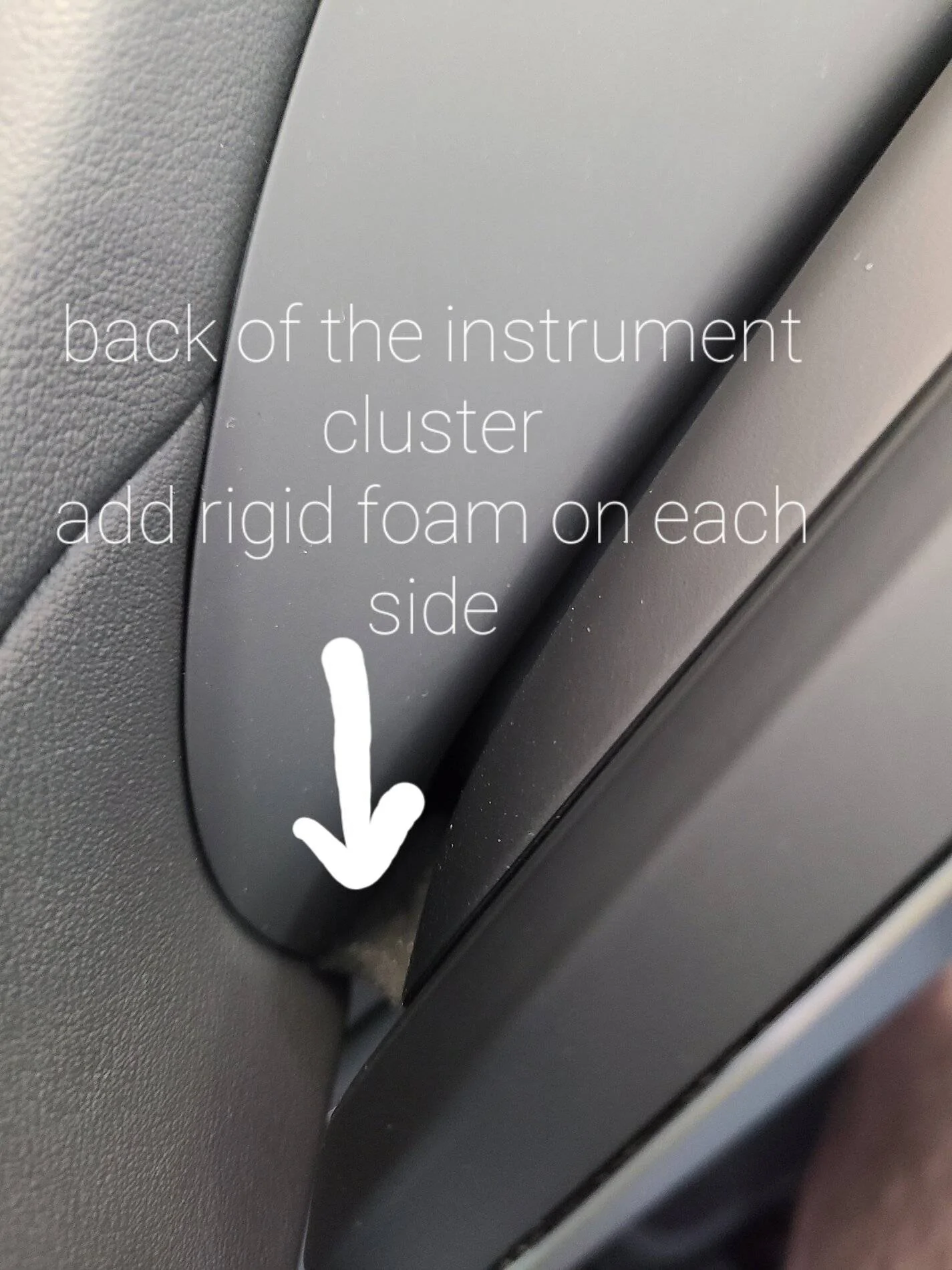

Got it. Update: your new fixes solved my remaining driver’s side noise- THANK YOU! Was driving me nuts. I think it was the seat. What do you have for the instrument cluster rattle? ? Half joking- I only hear those rattles on rough roads in Sport or Sport Plus for the most part.
Oh I also have the instrument panel rattle and I also pushed some foam on its base. I will take some photos tomorrow and share here. It improved it 70% but not completely.
It is hard to take photos of the back of the instrument cluster. I squeezed foam on both corners. You need a tool to push the foam. I used my plastic upholstery tools that do not scratch surfaces.
