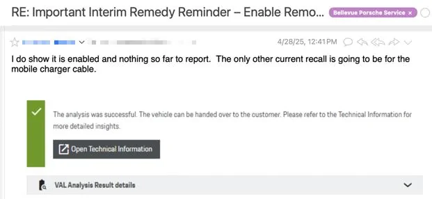

For those who didn't read the post by @gtm above, shown below is further information on the distinction between ARB6 and ARB7. I agree that this is confusing. Here is my recent history in a nutshell -
  • 12/11/24 - Received ARB7 recall notice and contacted my dealer
  • 3/22/25 - Installed OTA update to monitor battery health
  • 4/25/25 - Received email from Porsche to be sure to enable OTA updates for the update I already installed (Remote Battery Monitoring)
  • 4/28/25 - Received confirmation from dealer that Battery Monitoring was active and not showing any issues.
    • The dealer said ARB6 was still active so I checked my VIN online at NHTSA Recall portal it shows ARB6 active, although my original recall was ARB7.
    • Email from dealer
    • Porsche Taycan I just got the ARB7 OTA update! 1751838603050-7
    • My takeaway is that the monitoring required by ARB7 is active, but that my battery is still on the list of those that potentially need repairs.
  • 5/29/25 - UNRELATED TO ARB6/ARB7 - Purchased the Porsche Extended Warranty 48mo/60,000 (total miles) Platinum coverage for $4,776 USD + tax.
Just for the record, I now charge to 85% at home and sometimes go over 90% at DC Fast Chargers.
ARB6 vs. ARB7
  • ARB6: Applies to vehicles for which Porsche does not have sufficient battery data to assess for anomalies. These cars require in-person diagnostic checks at dealerships.
  • ARB7: Applies to vehicles where Porsche has sufficient data (often via over-the-air monitoring) and currently sees no anomalies, but cannot guarantee future safety. These cars are monitored remotely, and owners may be notified if issues are detected.
