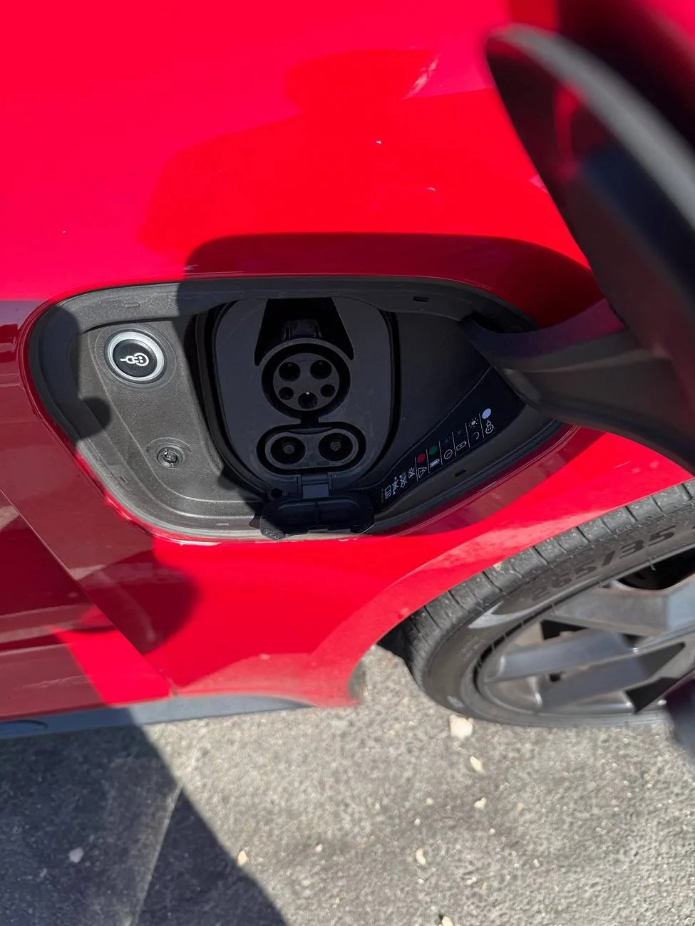

Now that your car has the ARB7 "remedy", what is it actually going to do?
If it spots a problem, generate the same old red/yellow electrical error?​
Restrict/limit the car's ability to charge?​
Stop you in your tracks the next time you break that charging port flap?​
You can charge to 150% now.
