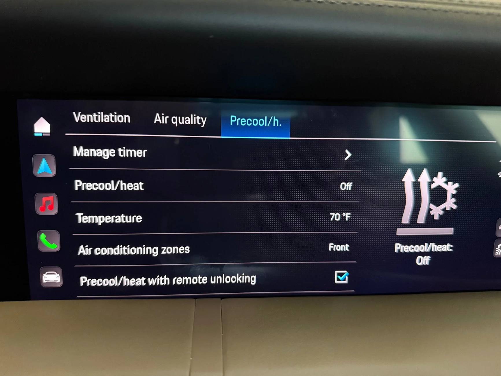

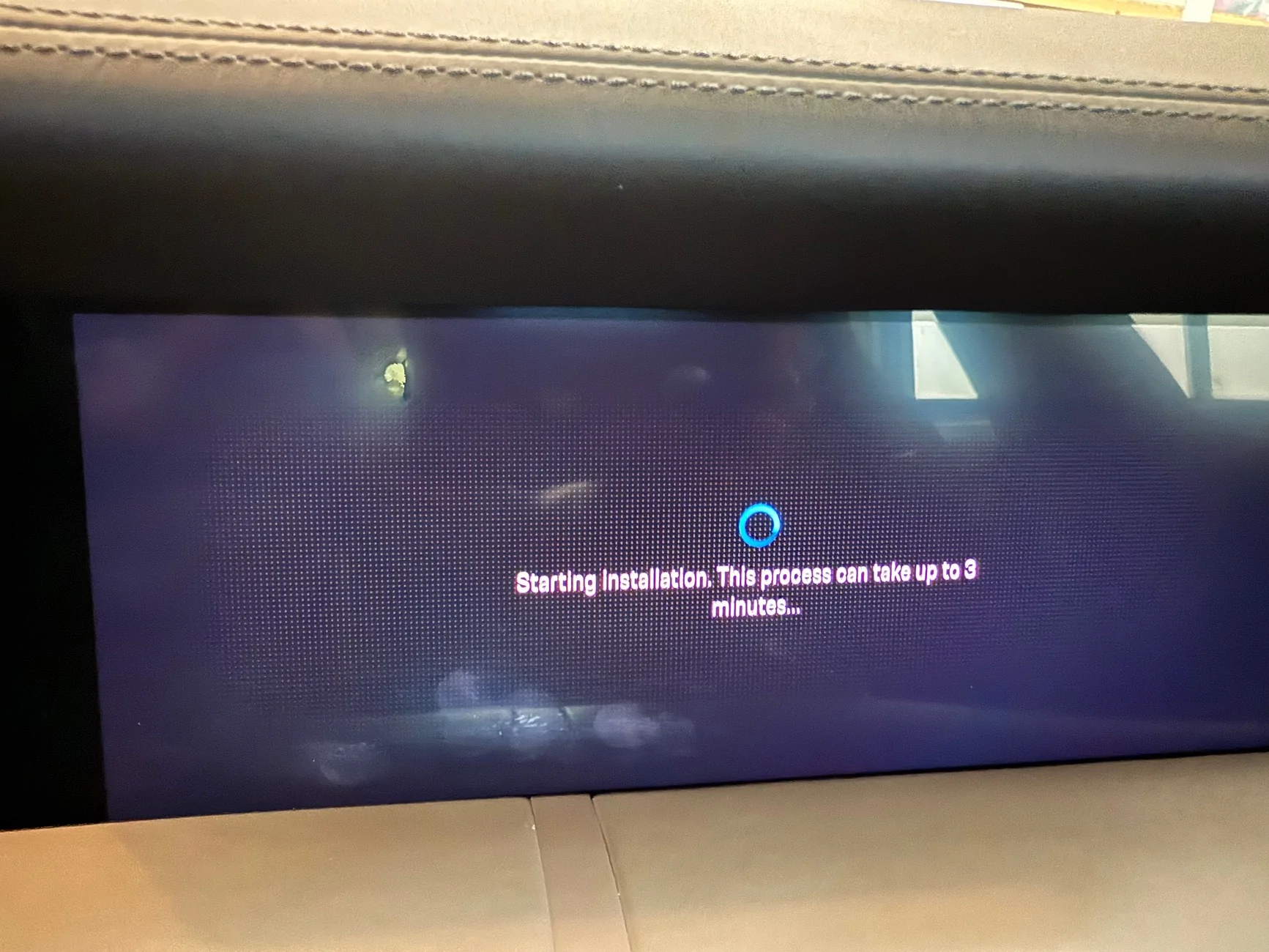

When I got back from a trip my 4s told me there was an OTA update available. I followed the instructions (I thought), but after 3 tries the install hadn’t worked. I would get this spinning disc view, but when I exited and locked the car nothing happened.
Porsche Taycan I just got the ARB7 OTA update! IMG_7680
Finally, I went to the Settings > Air Conditioning and turned Precool/heat to OFF. This seems to have done the trick, and the update installed.
Porsche Taycan I just got the ARB7 OTA update! IMG_7681
Going to the NHTSA database I no longer see any recalls on my VIN.
