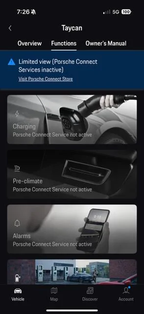

In that case can you show us your app with connect subscription deactivated and the OTA button not greyed out/missing?
Because in my own experience, it is absolutely necessary, otherwise you get a display like the one posted above with stuff greyed out or missing completely.
You are right. Just found this Q&A on the Porsche website which says Porsche Connect service is required for OTA updates.
https://ask.porsche.com/us/en-US/over-the-air-software-updates/
$27/mo seems crazy to have to pay for this.

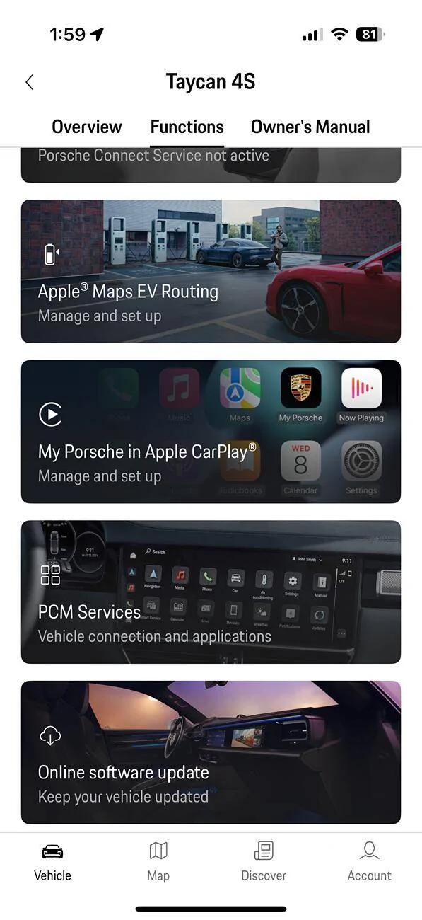

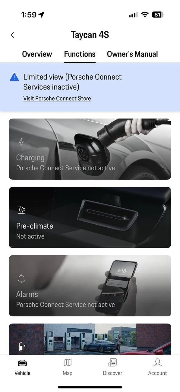

The plot thickens. I do NOT have an active Connect subscription, but my option is very much still present and active in my app.
Porsche Taycan I just got the ARB7 OTA update! IMG_5314
Porsche Taycan I just got the ARB7 OTA update! IMG_5315
Porsche Taycan I just got the ARB7 OTA update! IMG_5316

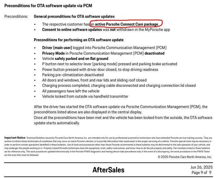

It is likely you do have Porsche Connect Care, which was included for 10 years for pre 2025 Taycans.
Online Porsche says Porsche Connect Care includes vehicle software updates, among other things.

You might have looked at my screenshots a bit too quickly; several options are greyed out, because of my lack of a Connect subscription

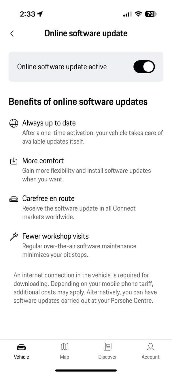

I have the "online software update", I have no full connect but do have connect care, as that was included for 10 years.
For now it says there are no updates for my system.
I have disabled the privacy-mode for now.

This is interesting! I just activated the Porsche Connect Care and now the online software update tab does appear in the app!
I have it enabled but at the bottom it says "an internet connection in the vehicle is required for downloading"... anyone know how to ensure I have an internet connection in the vehicle?

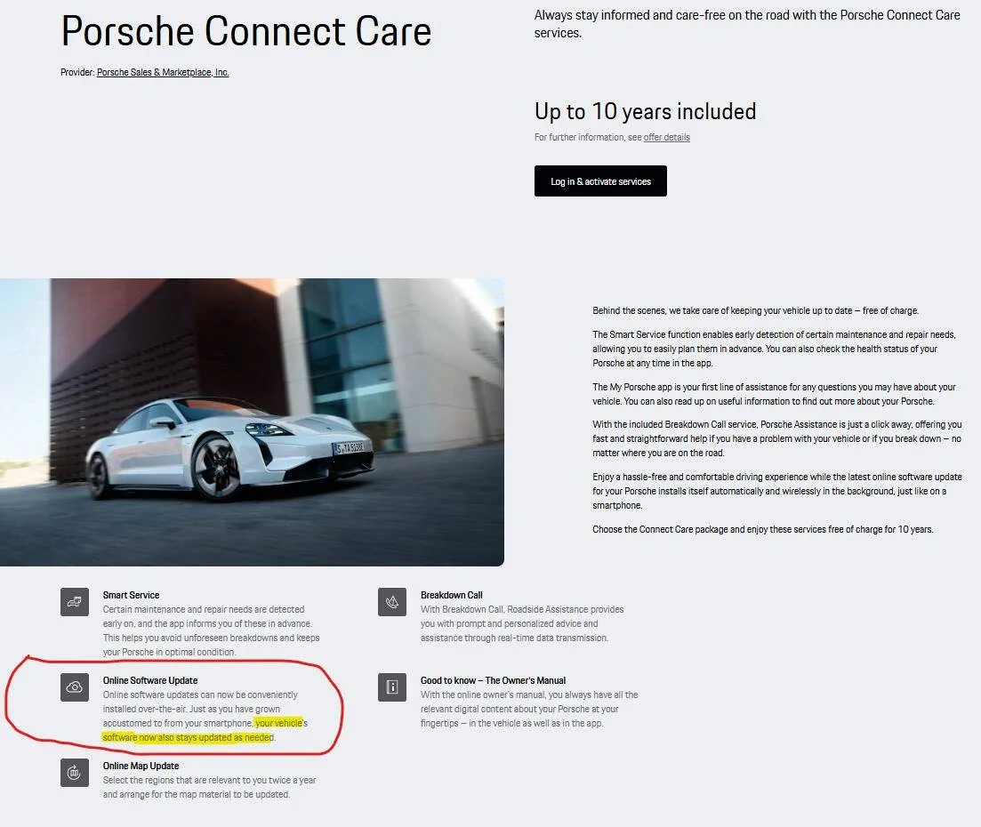

Here is Porsche description of Porsche Connect Care:
Porsche Taycan I just got the ARB7 OTA update! 1752008463314-3
https://connect-store.porsche.com/offer/us/en-US/taycan_2025/products/bundle_connect_care_v3
Why don't you ask Porsche why its FAQ differs from its description of Porsche Connect Care?
(Do you believe that the FAQ author knows the difference between 'Porsche Connect' and 'Porsche Connect Care'?)
MyPorsche app for my 2022 shows I have two separate products: Porsche Connect (I paid for a year) and Porsche Connect Care (good for car's first 10 years).
I have no idea what is actually necessary for OTA updates. Couple years ago Porsche US emailed I needed to set (opt-in) online privacy (not PCM) to allow all to get OTA updates. I never did that and I still get OTA updates.
Taycan owners don't really know what is required for OTA updates and neither does Porsche.

All I can say is my online software update is active.
