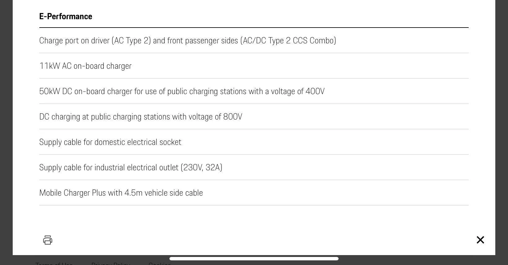

It's a fair conclusion for sure and definitely not challenging your logic but reading back through the thread a few things re-surface and therefore raise a question.
The OP struggled at 63kW and another forum member has cited 115kW from another Instavolt EVSE but has no recollection of the DC booster option. Note that the spec he / she shared was from the standard car spec and not from their actual spec with options (which is where I think the confusion / missing data point is).

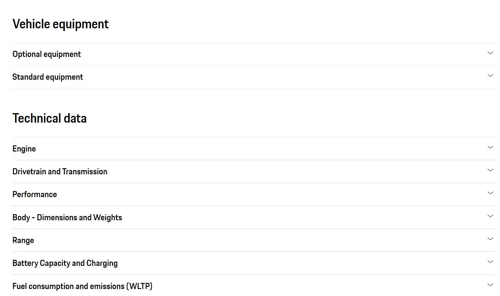

My Porsche Website - Technical Details (where your actual options are listed) - this example shows my 150kW option:
Porsche Taycan Instavolt 120kw 400v chargers 1673279902498
Then under Optional Equipment - E-Mobility - is where the DC booster is listed (nowhere else):
Porsche Taycan Instavolt 120kw 400v chargers 1673279633377

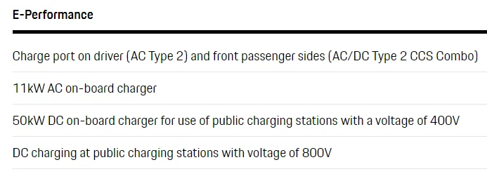

Whereas the only thing we have to go on was taken from 'Standard Equipment' under heading 'E-Performance' which as you'd expect lists the standard config:
Porsche Taycan Instavolt 120kw 400v chargers 1673279675337
For completeness the forum member posted:
Porsche Taycan Instavolt 120kw 400v chargers 1673280106132
Odd also that Instavolt would provide incorrect information to a specific question when asked and that there are potentially some anomalies out there. My nearest Instavolt 120kW is at McDonald's in Glasgow 2.45 hrs away) which look to be identical units but nothing on the Instavolt website detailing anything other than the power output.
So if @CrossTComingSoon hasn't lost the will to live after reading all of this perhaps he / she could recheck the options listed for their vehicle.
