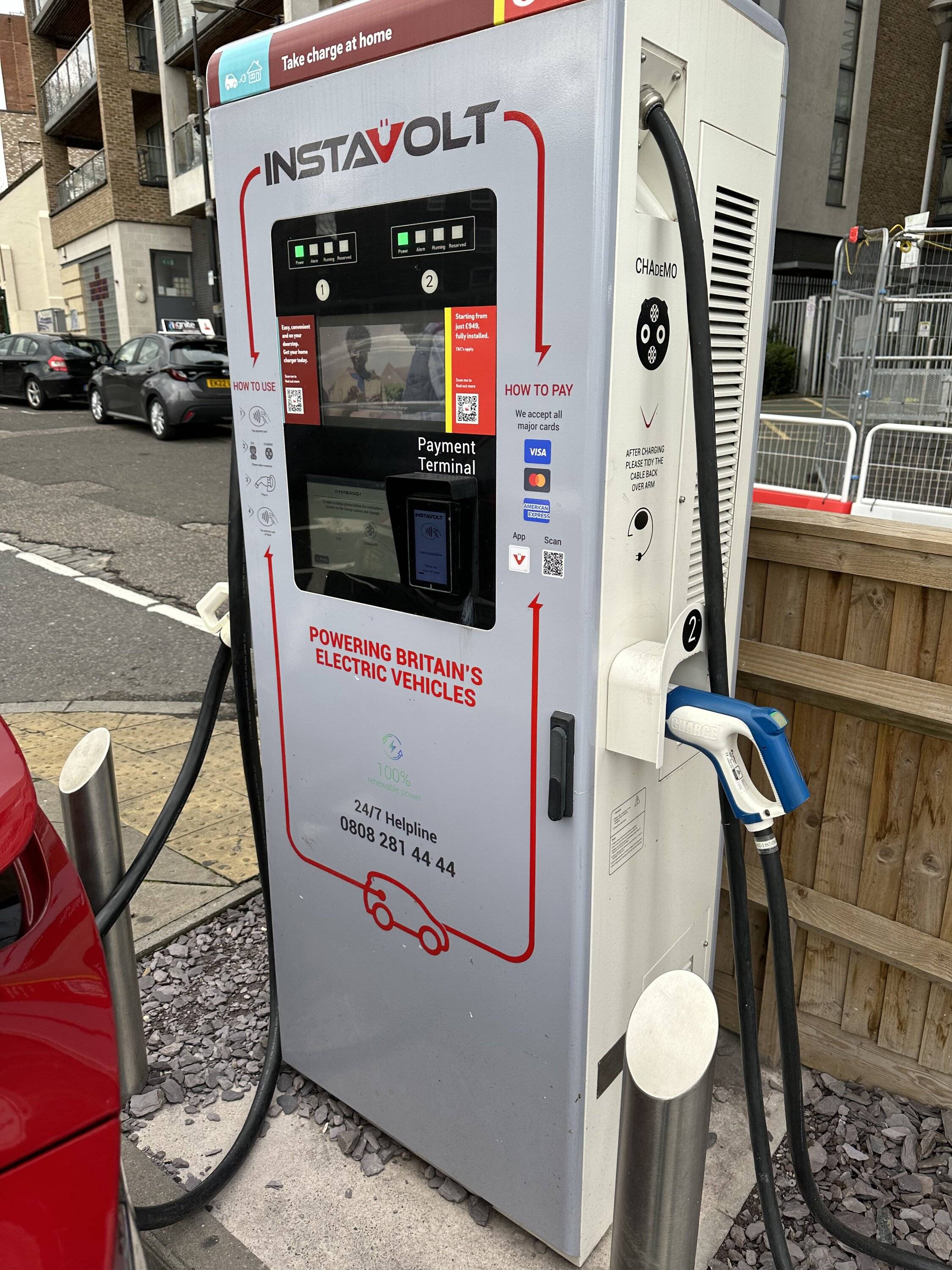

Instavolt 120kw 400v chargers
Oct 16, 2021
Herts
Taycan Turbo CT MY22
I'm sure I got told some guff when ordering about the 150kw DC thing only being useful if you use those 400v chargers "on the continent" and not in the UK

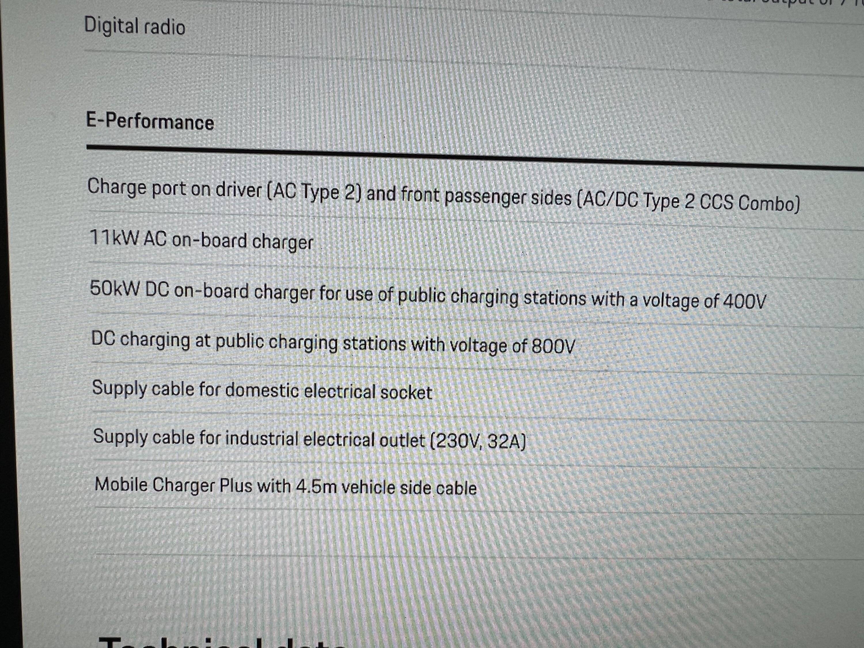

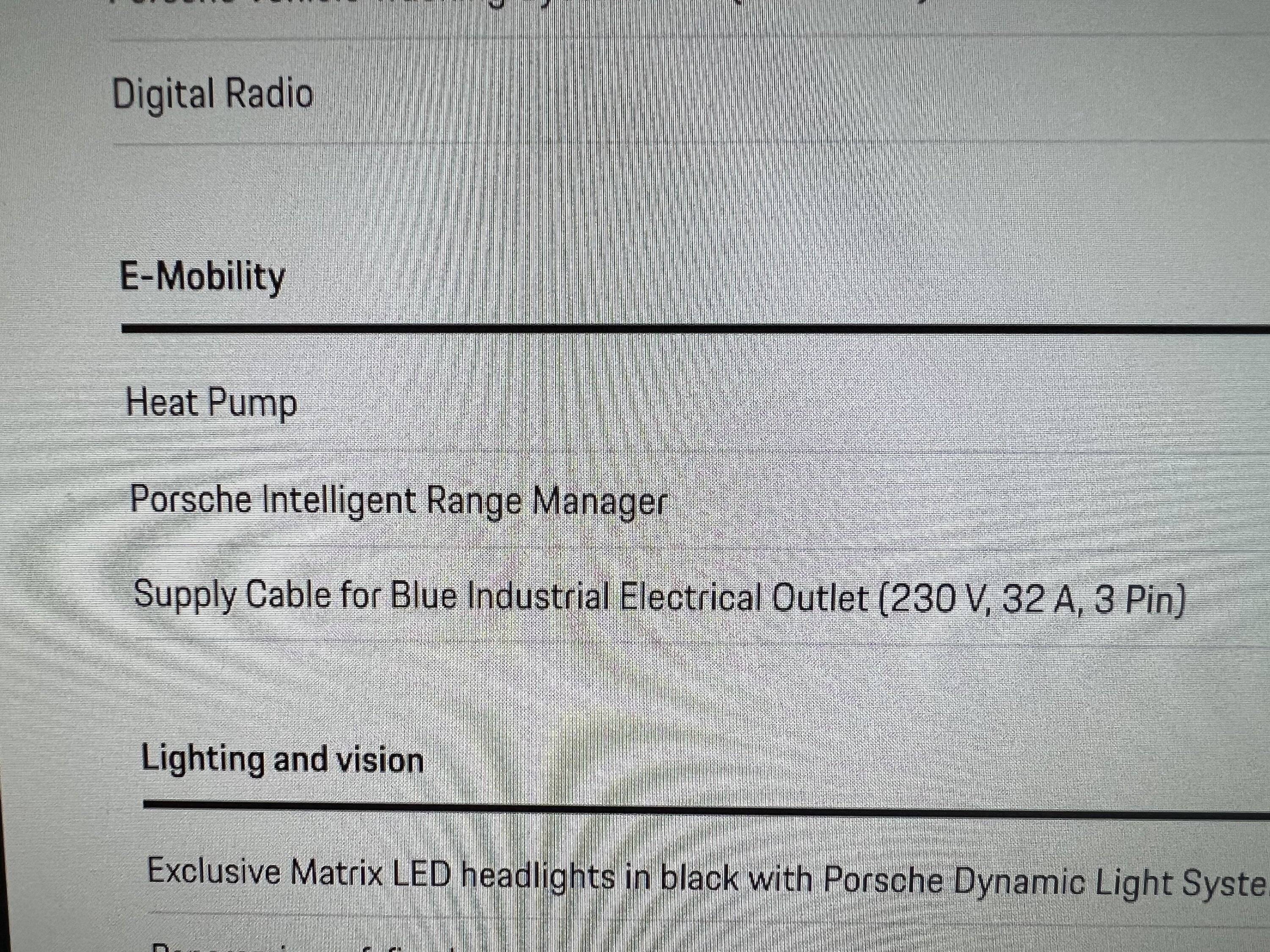

Still alive. I should clarify. There's nothing in "my Porsche" spec sheets other than the following as optional in first picture and standard in second.
Thanks for sharing.
Base assumption is that you have a Turbo Cross Turismo.
The first picture lists standard equipment on all UK cars - DAB, heat pump and so on - so this doesn't really help clarify.
The second picture also lists standard features too - matrix lights being standard on the Turbo - again doesn't help to clarify.
Do you happen to have the original Porsche Code for your build and willing to share?
Can you specify the location of the EVSE you used?

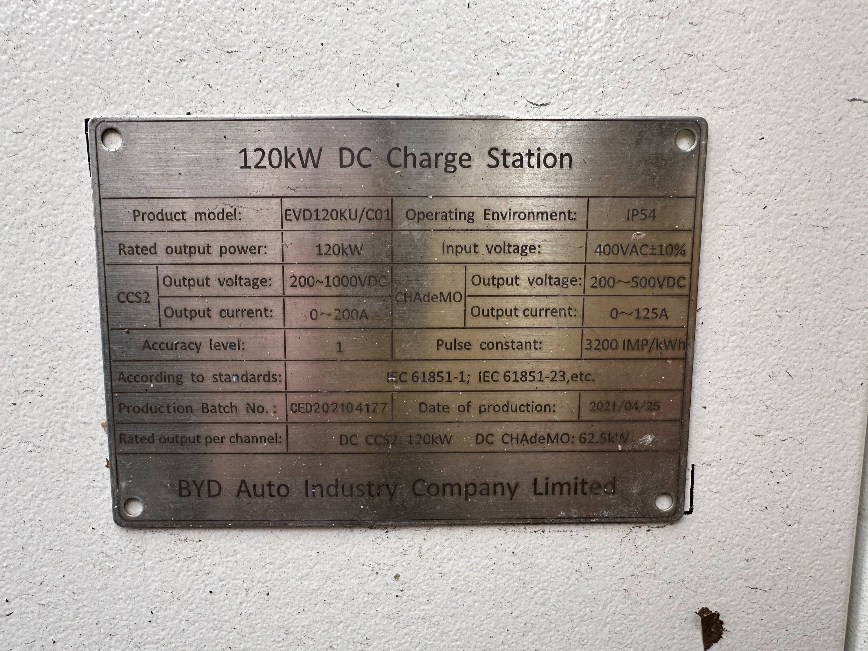

Does this help? BYD 120kW 200A spec sheet.
If we could only get the accurate build of the Taycan used we'd have our answer - 115lW at 600(ish) V. Any higher would have dropped off.
Nice digging ? but I think you're reading the current curve (blue) rather than power curve (orange)....the current drops off as expected. The unit delivers full power once its current draw is allowed to drop from its max. rated. Again expected.
So backs up what I've been saying - this is a multi-voltage unit capable of 800V (and beyond as we can see). Not a fixed 400V unit.
A Tesla could only pull approx. 80 kW in ideal conditions from this Instavolt unit, given it's a 400V DC charging car.
A Porsche that's pulling 115 kW must be doing it at nominally 800V or thereabouts - given we know it's an 800V architecture. Its not going to magically drop to 600V.
The Porsche 150kW on-board DC-DC converter (booster) option is a red herring on this Instavolt scenario. It makes no odds.
