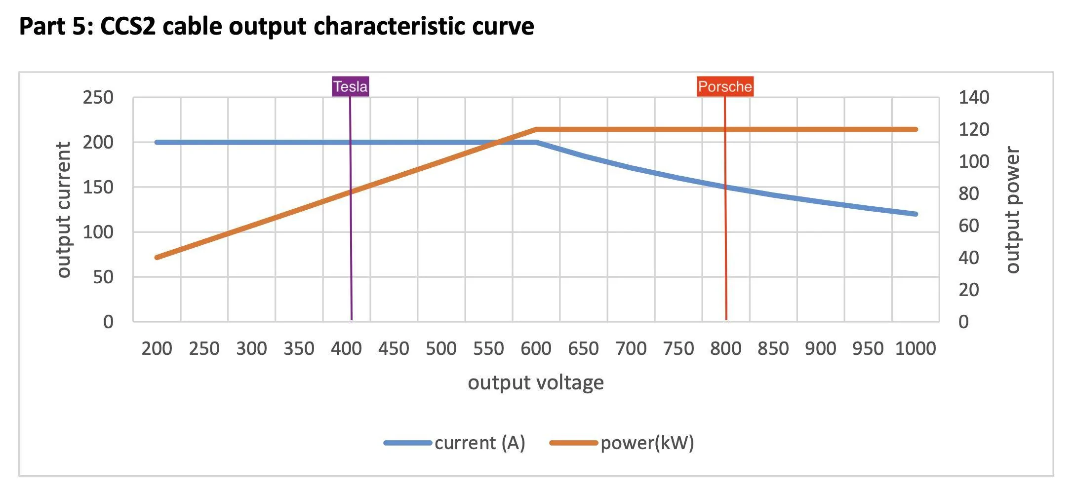

Nice digging ? but I think you're reading the current curve (blue) rather than power curve (orange)....the current drops off as expected. The unit delivers full power once its current draw is allowed to drop from its max. rated. Again expected.
So backs up what I've been saying - this is a multi-voltage unit capable of 800V (and beyond as we can see). Not a fixed 400V unit.
A Tesla could only pull approx. 80 kW in ideal conditions from this Instavolt unit, given it's a 400V DC charging car.
A Porsche that's pulling 115 kW must be doing it at nominally 800V or thereabouts - given we know it's an 800V architecture. Its not going to magically drop to 600V.
The Porsche 150kW on-board DC-DC converter (booster) option is a red herring on this Instavolt scenario. It makes no odds.

Not sure I follow your logic. Just to get this straight…
1. there’s a data plate on the unit that says it’s a multi-voltage unit (200 to 1000VDC on the CCS2 port)
2. You’ve gone and found a BYD spec document for the unit - handily with power and current output curves from the CCS2 connector which shows how much power it can deliver at different voltages.
To deliver anywhere near the rated output of 120 kW the unit MUST increase the output voltage on the CCS2 connector output to 600V and above. This is because it cannot deliver more than 200A of current (according to data plate and spec document).
3. @CrossTComingSoon has charged several times on these units and says he’s had around 115 kW from them.
So you don’t trust or believe either the data plate or the spec document?
Rather your logic is that there is “…some wizardry happens up to the output…” but you don’t know what…
Well OK then ?

Predicated on:
1) Lack of clarity on our test vehicle in terms of options. No concrete assurance that the DC booster is not in play. The screenshots provided were incomplete / not the ones requested. Awaiting a build code or order sheet to confirm same.
2) To install 120kW (2019 onwards remember) and now 150kW EVSEs which are exclusively targeted toward Taycans, Audi E-tron GTs, Hyundai Sonics ie have an 800v bias for maxing charging seems entirely unlikely and not the EV masses.
3. Instavolt would have been called out by now if they were falsely advertising charging times etc (as they are) when stopping at these locations. Pretty sure Mr Tesla driver would have moaned about it.
4. Incorrect voltage stated on the data plate - Instavolt stated 400v only - agree that is a stretch but who knows.
5. Is it possible to bridge 2 X 200A within the EVSE to max the power output at 400v?
6. Is it possible that if up to 1000v were available that the Taycan negotiated this with the EVSE thereby bypassing the need for any DC booster.
7. The doc I found is one of several but agree it is a close match to the EVSE in scope.
8. Is it realistic to expect EV owners and all software apps to target EVSEs based on voltage ratings as well as headline power output? I suspect not.
We just need 2 X hungry and willing Taycan owners to go test.

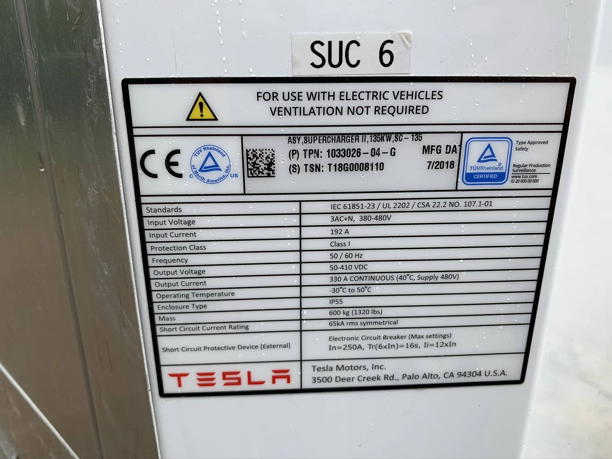

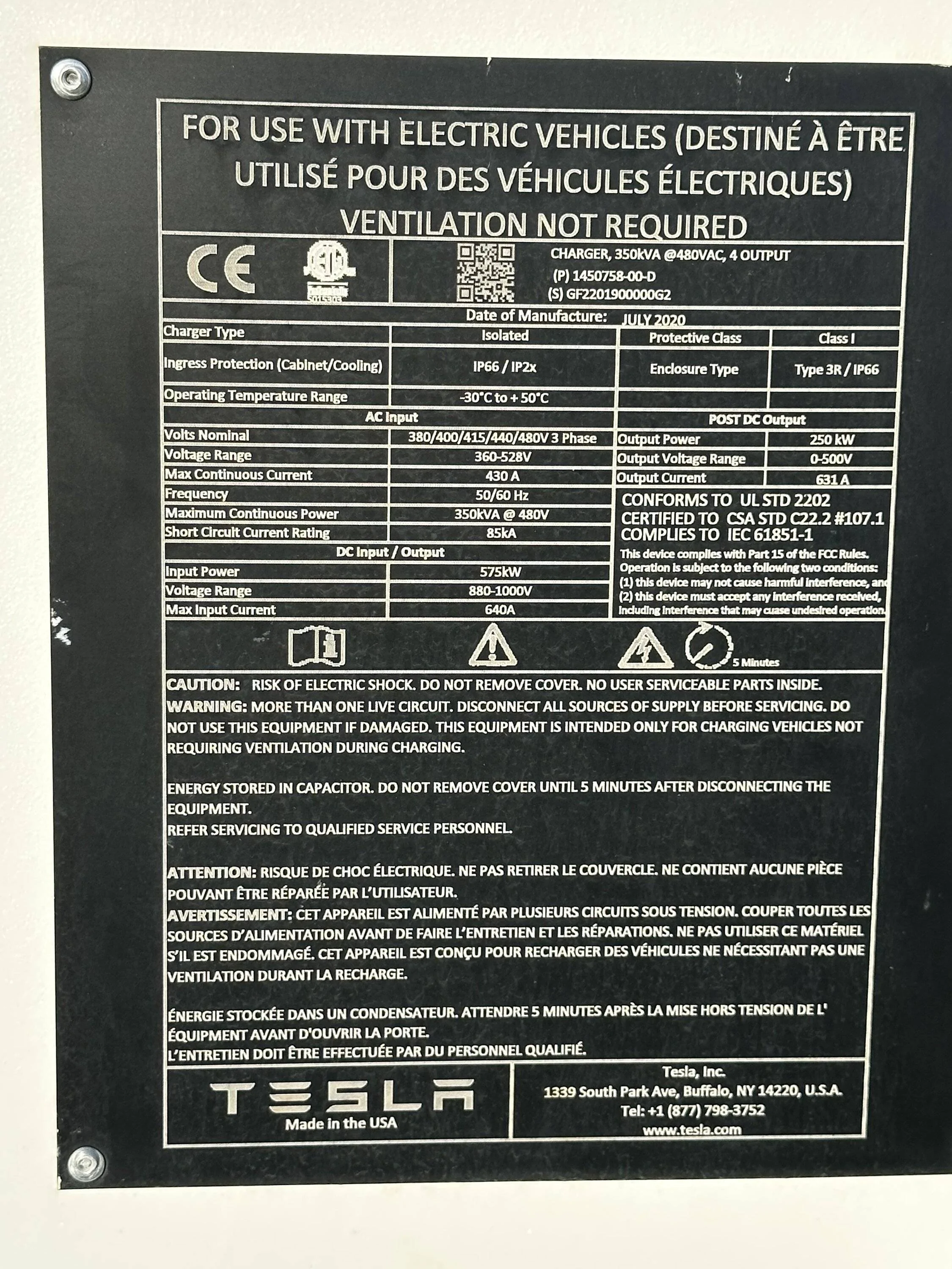

Different amperage outputs on the SuC’s.
This is the cabinet from the v2 “150kW” units at Marks Tey (Colchester). You can see the much higher current rating as opposed to the 120 kW Instavolt unit.
I can get a shot of a v3 (250 kW) unit when I’m next charging at one.
Shot of a v3 Supercharger cabinet data plate (Colchester). Much higher DC output power and current capability:

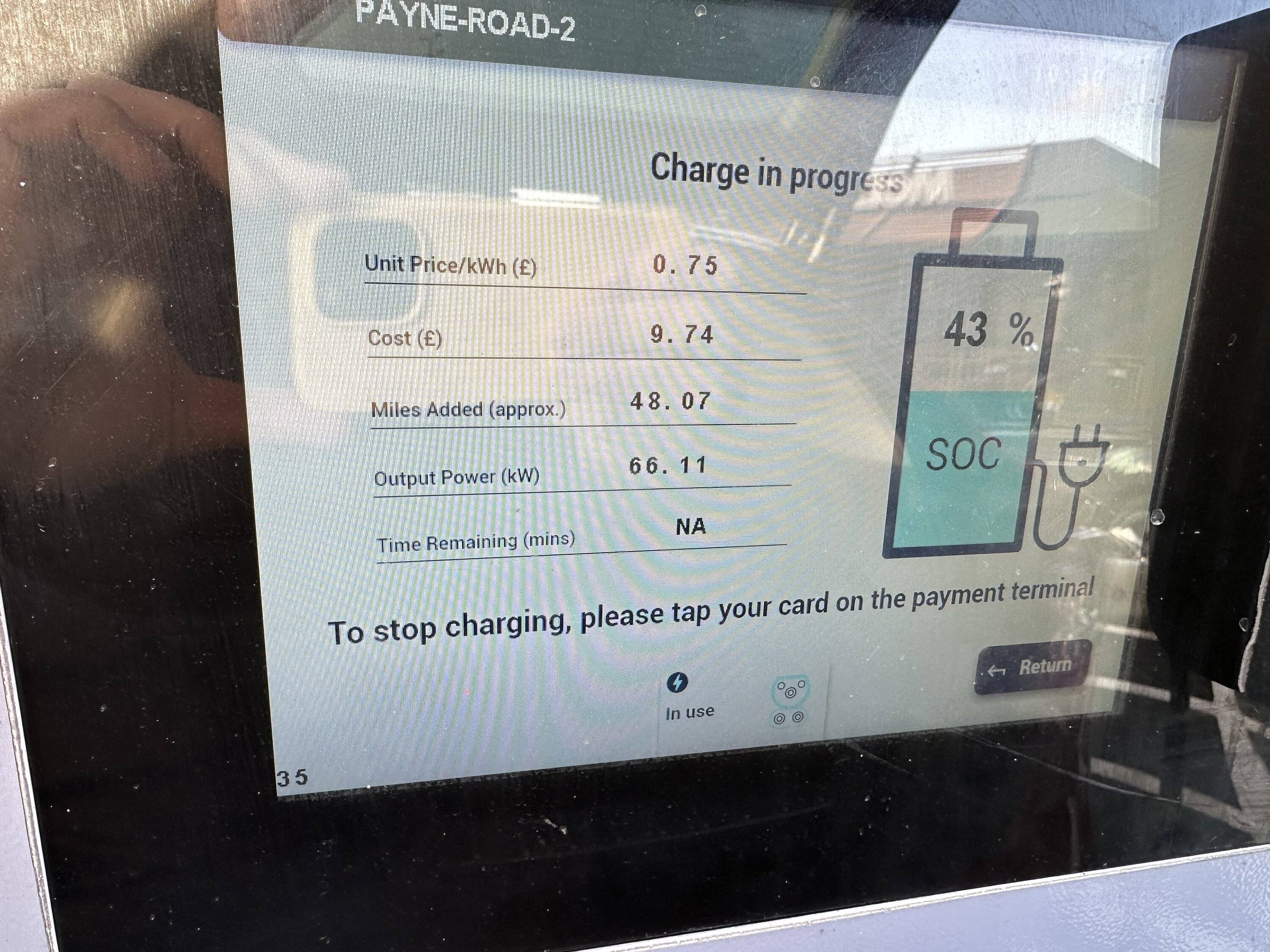

Tried that Instavolt this morning on the model X.
The battery was preconditioned and around 30% SoC. It could have been warmer to be fair, however the most I saw was 66 kW….perhaps if the battery was a tad warmer and at a lower SoC to encourage the best charge rate, but it’s telling on a 400v only car.
I’ll try again one day the Tesla with a properly warm battery and lower SoC.
Picture below from when I pulled the charge.
Porsche Taycan Instavolt 120kw 400v chargers 91E03287-25BE-44C3-8282-79491FCC7796
For comparison I then drove off that topup and went to Colchester SuC on my way to Suffolk. At a similar-ish SoC around 27%, the car almost immediately started pulling 136 kW. Again could have been better at a lower SoC.
Have also asked the good folks on the Tesla forum what their best charge rates are on these 120kW Instavolts.
So not totally conclusive, but looking very much like these units are output capped on a 400V car. There should be no lower output limit though on ANY Taycan - in the right conditions.
Will try that experiment next (at some point).
Keep testing - much appreciated - 99% conclusive now I'd say.
